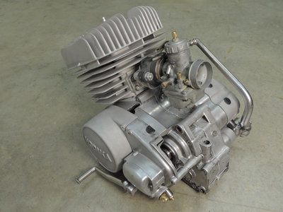

A good friend has been procrastinating on a 99 Road Toad for years.(Decades?) I finally said I'd do the engine if he would do the rest. Here's the progress on my part. Nothing has to be original so I went with the blasted prototype look.

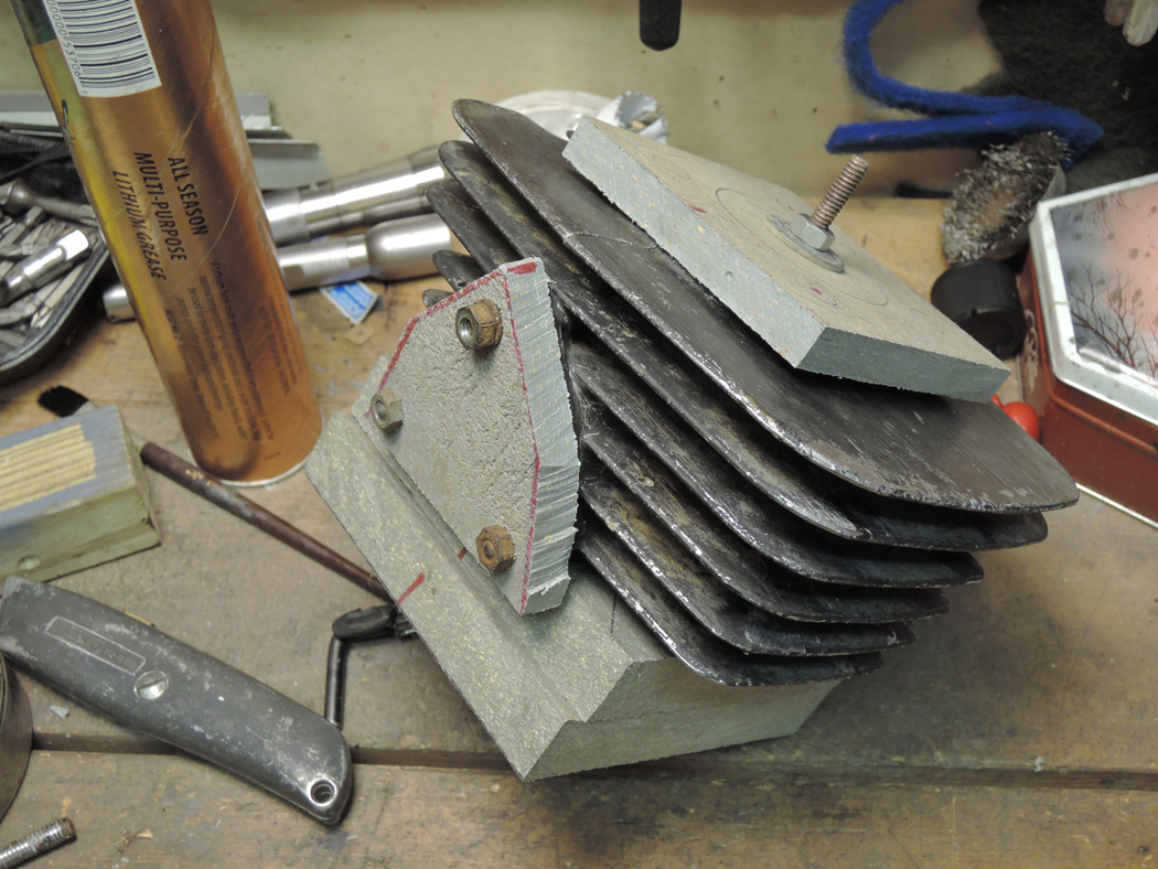

Masking Blocks in Place
Blasted Parts
Blasted Parts

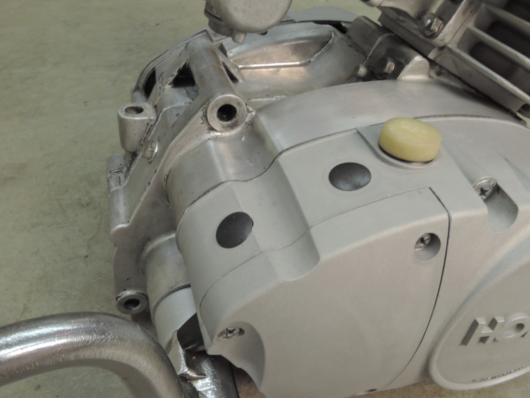

Oil pump plugs (Ace Hardware)
Engine with total rebuild

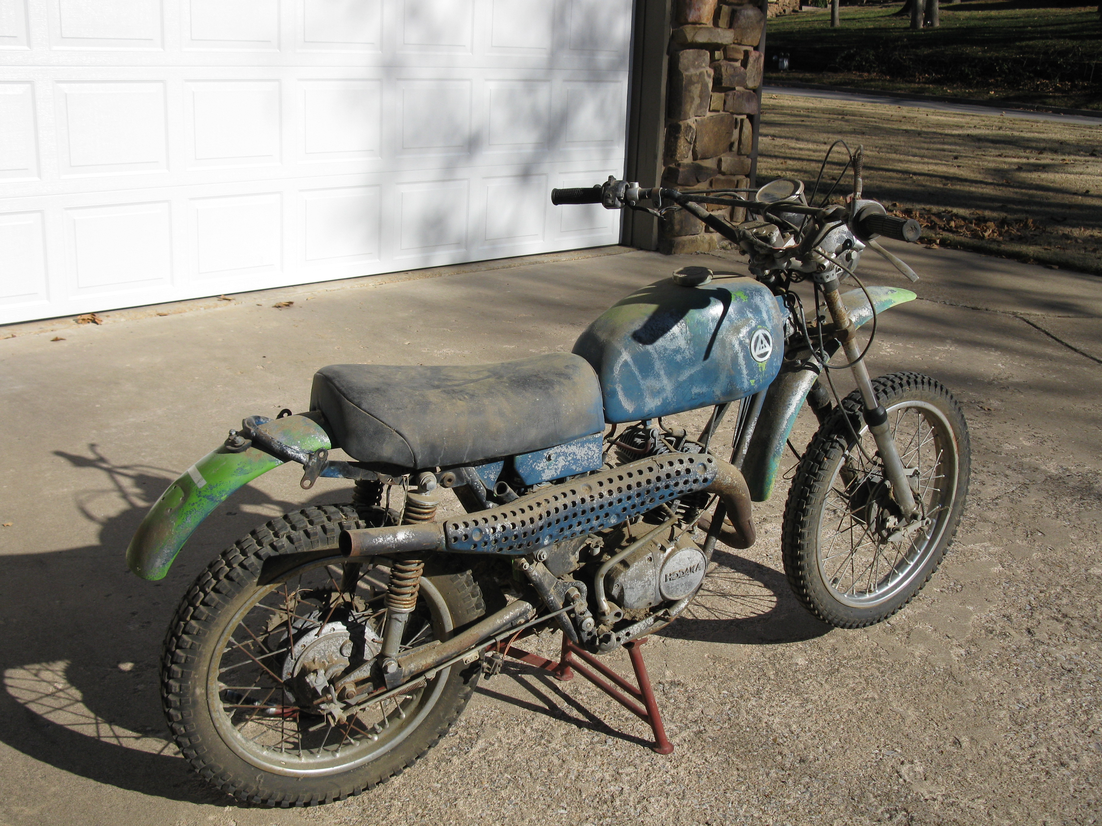

Here are some pictures of the Toad when we started this project. The bike had been stolen from its original owner and when found had been spray painted with blue and silver paint. The paint was everywhere including the seat, tires, shocks, and chrome parts. The bike has been completely taken apart and the frame, swing arm, and most other components which were originally black have been repainted. The gas tank is a whole other project and I haven't decided on a color to paint it. I have an old Ace 100 chrome tank I may use.

Post by Pep »
That poor thing. Can't wait to see the "after" photos - looks on her way to an Extreme Makeover!
Have fun with the project and keep us posted on progress!
-Laurie
