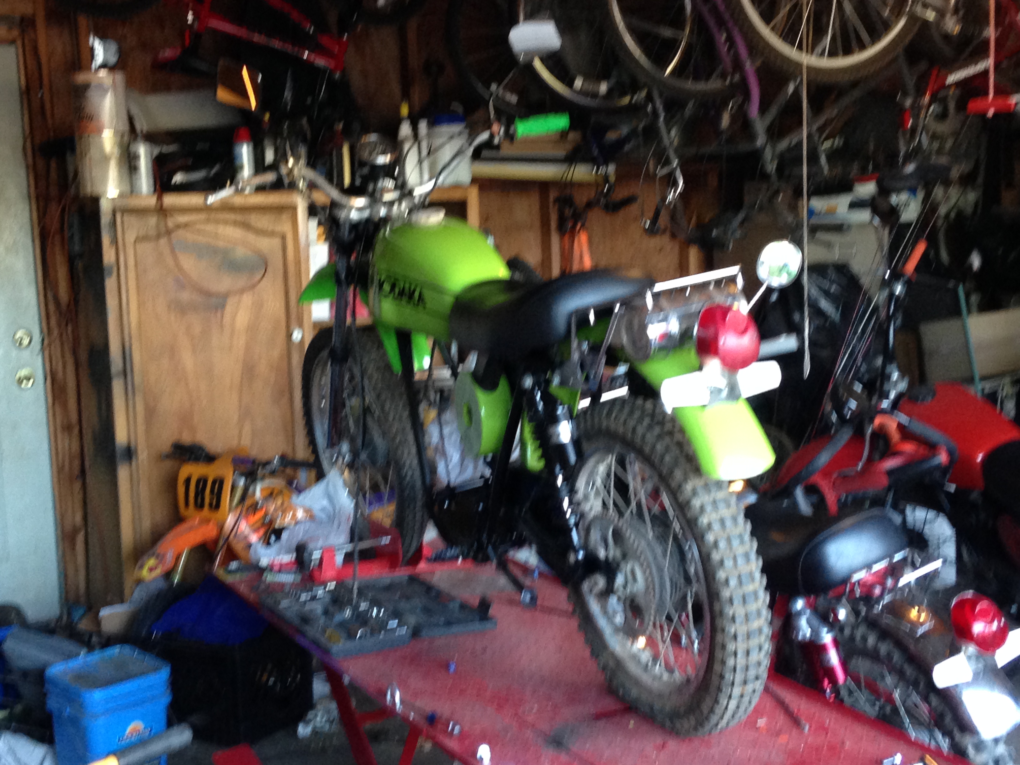

Hah! I damned near gave up. Funky OEM bolts! Anyway here's a pic. The front fender doesn't match color wize. I'm going to see if I can find a Krylon Fusion for plastic that comes closer and paint it. ; D Victor
Mateo helping me again!
