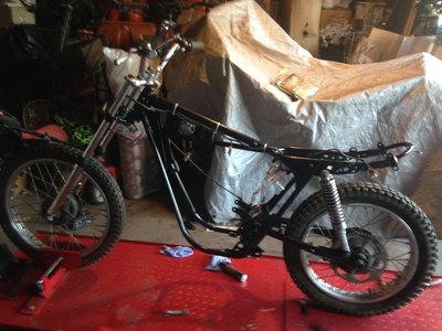

Frame done! Gloss black this time instead of satin. ; D Victor

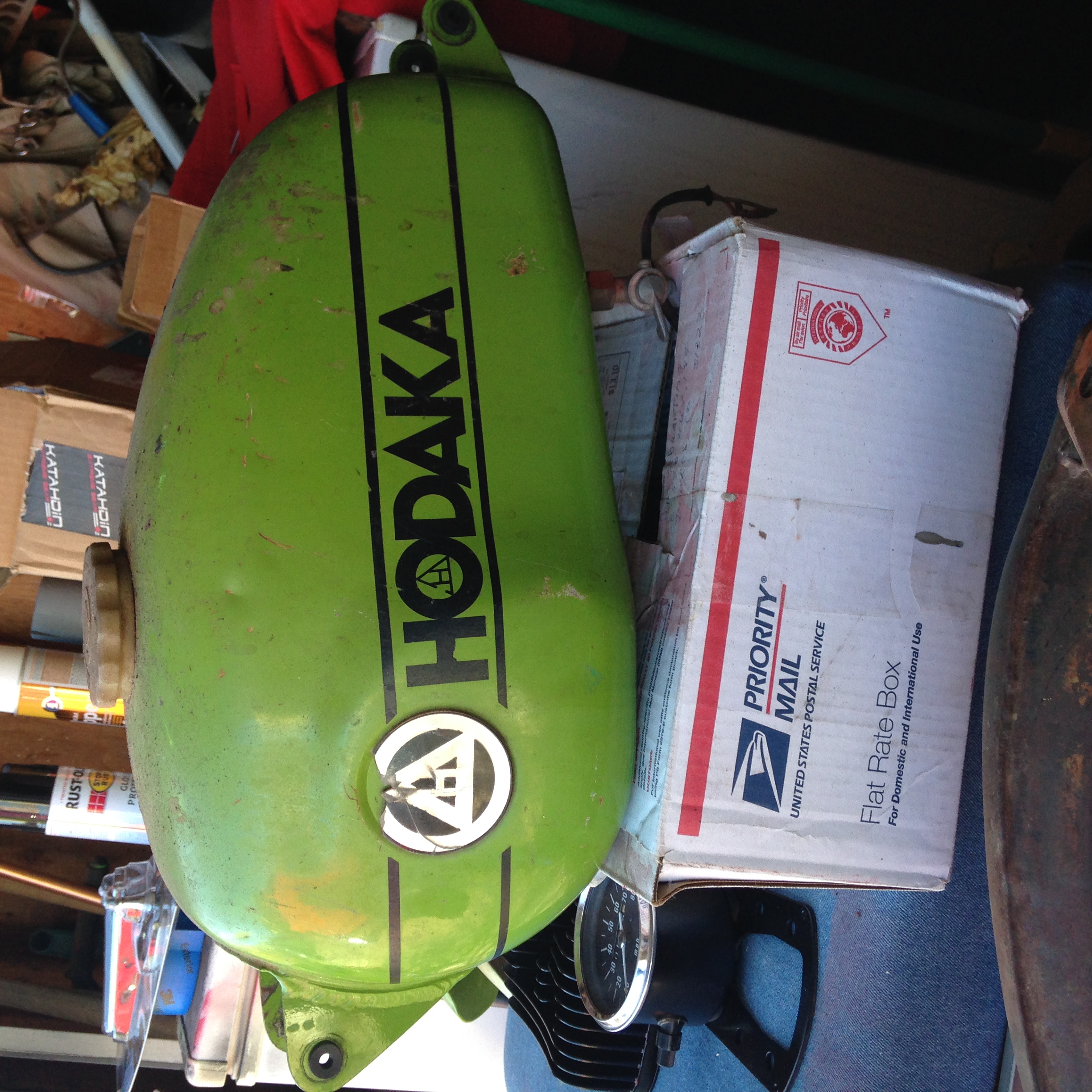

Pulled the air cleaner cover and cleaned it well! Especially the inside of the cover. I hope to have my local paint supplier scan the RT Green from the inside of the cover because it is virtually the same as when it was originally painted! Going to go with a single stage paint. More to come...... ; D Victor

Took the air cleaner cover to the automotive paint store today. Successfully scanned, test mixed, & applied a dab to make sure it matched. They did a GREAT job! Got everything I need. Single stage paint, reducer, activator and a special marked mixing container for mixing small quantities!

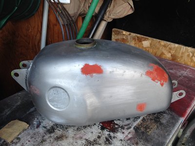

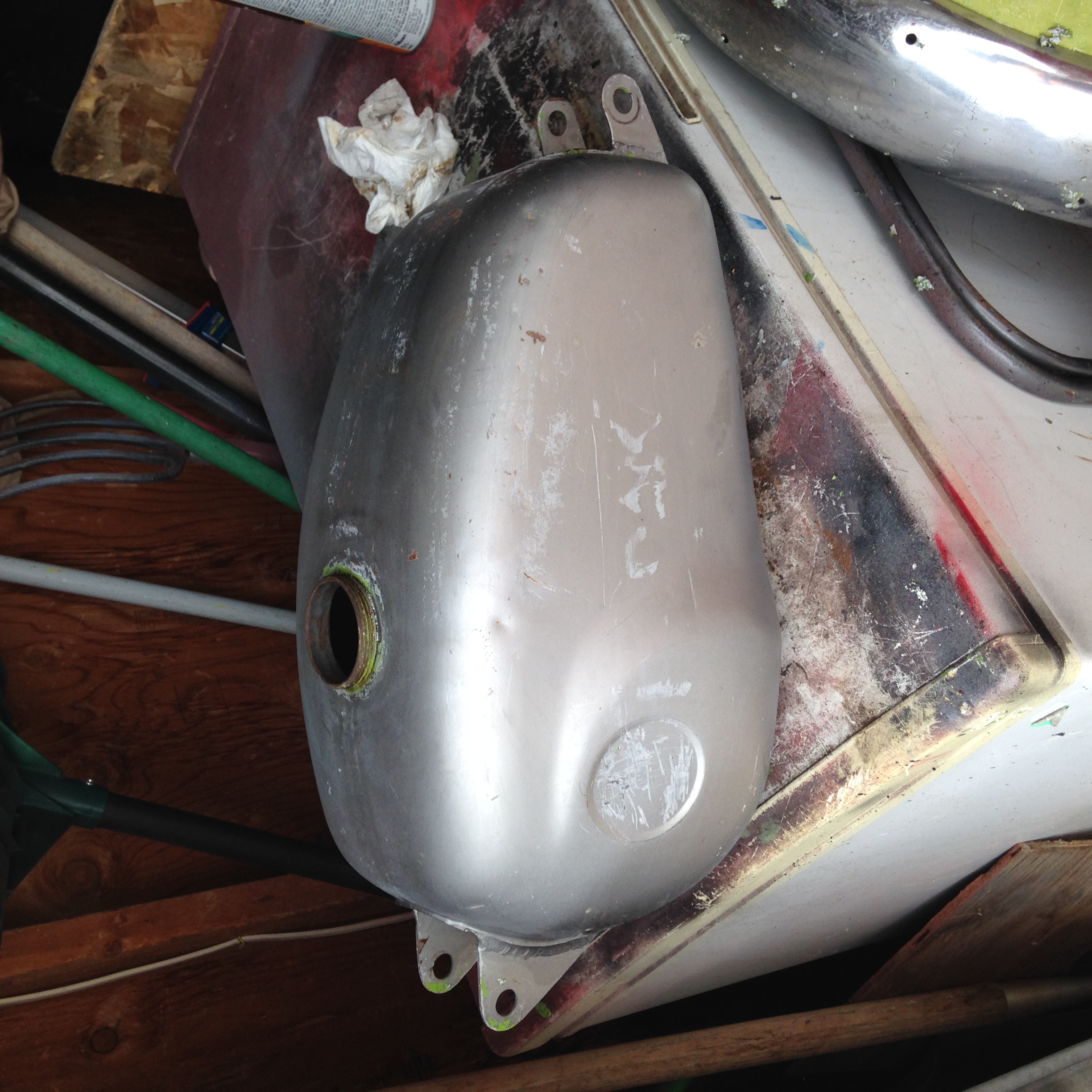

But today I managed to do two things. The first was to strip the tank of paint! That went well. I have to do some light sanding to remove the most stubborn of small decks of paint and residual primer which was behind the black tank decals. And a little bit of glazing compound to fill some very minor dings in the tank, maybe pencil eraser sized.

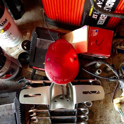

And I also sanded the tail light mount removing as much of the rust as I could, cleaned the chrome assembly with aluminum foil and water, and glued the crack at the red/clear seam on one side. Then reassembled and repaired the rubber boot for the outside of the bulb wires.
Need to go get more primer, but once the tank is smooth and primed, I can paint all the Road Toad green parts. I even used my home computer and camera to copy the decals. I sent them to a local friend on the print business and he made new decals for me! Need to go pick them up from him!

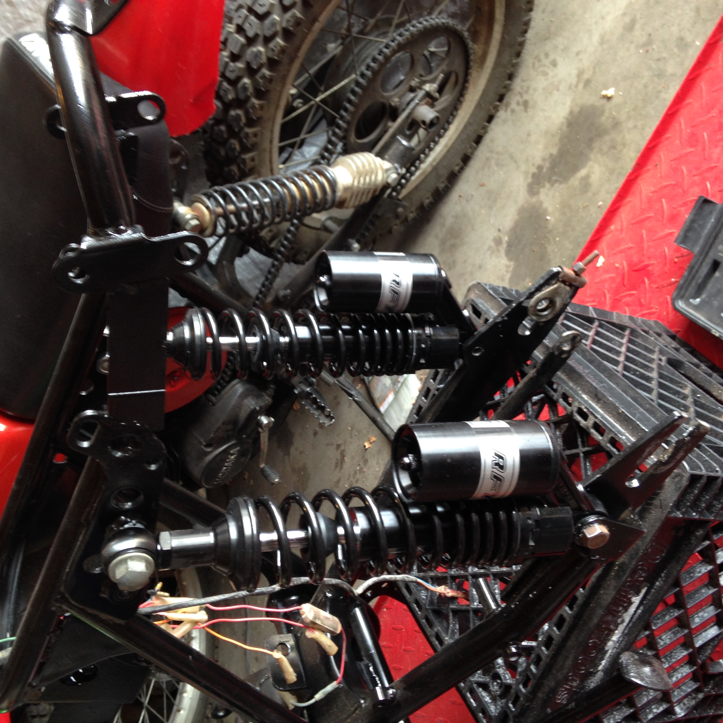

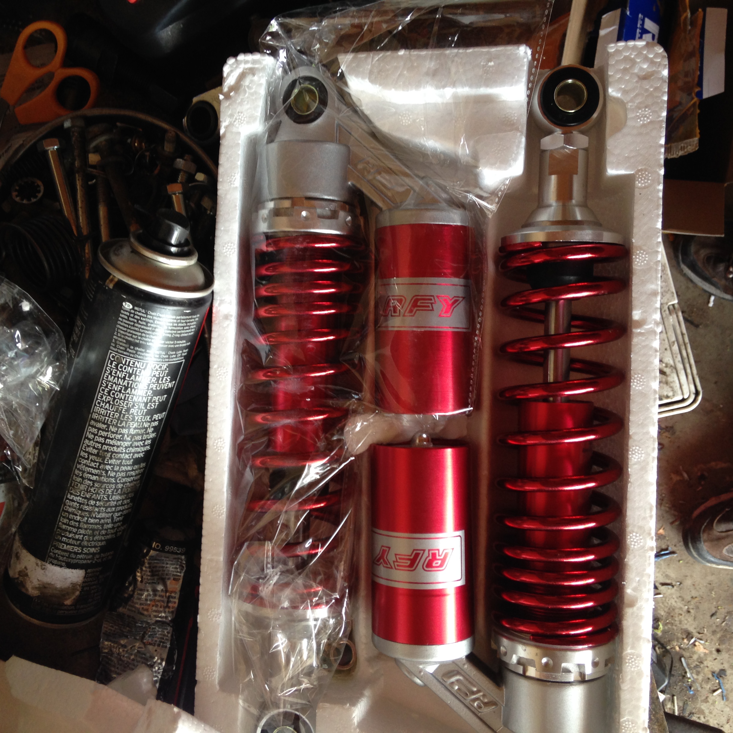

Well, as soon as I made the post above, there was a knock on the door. Delivery of the air shocks I bought. Got 2 sets, 1 for the RT and 1 for the Ace. So out with the old and in with the new! The Toad's are all black and the ones for the Ace are red & chrome. And riding the Ace I could tell the originals were shot. No dampening what so ever.
If you want to know more about them, send me a PM. I'll give you the down low, but they were a great price and fit well!

I filled the dimples/dents on the tank with glazing compound, and I have lightly sanded and applied a second coat. Should be ready for primer tomorrow! ; D Victor

Got the Road Toad tank ready for paint. Going single stage this time to see how it does. Don't know if I will add a clear coat after the graphics, but I was told to wait at least a week after applying the graphics if I do decide to clear after. Here's the tank, in primer, with the dings all done! And a shot of the graphics as well! ; D Victor
