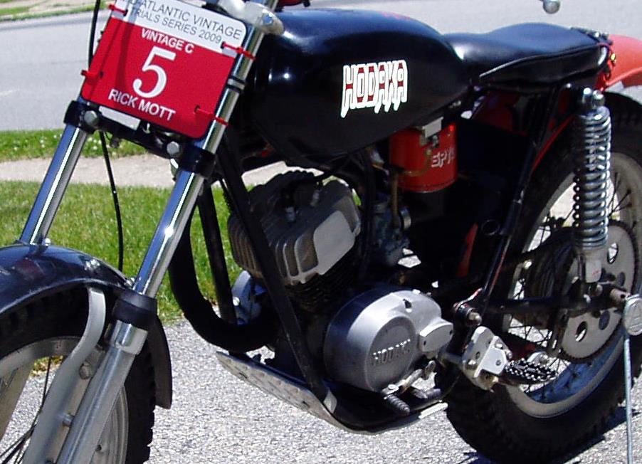

I have a Webco head on my Ace motor. It takes a B8ES. Longer reach. Has been fine since 1974 with that type plug. Has a compression release hole, but I just have it plugged with an old spark plug. See photo.

Thanks Richard, I came across your (sweet!) bike today; no bottom cooling fins on mine, so the verdict is in; I do not have a Webco head (insert sad trombone 'wah, wah, wahhh' here).
