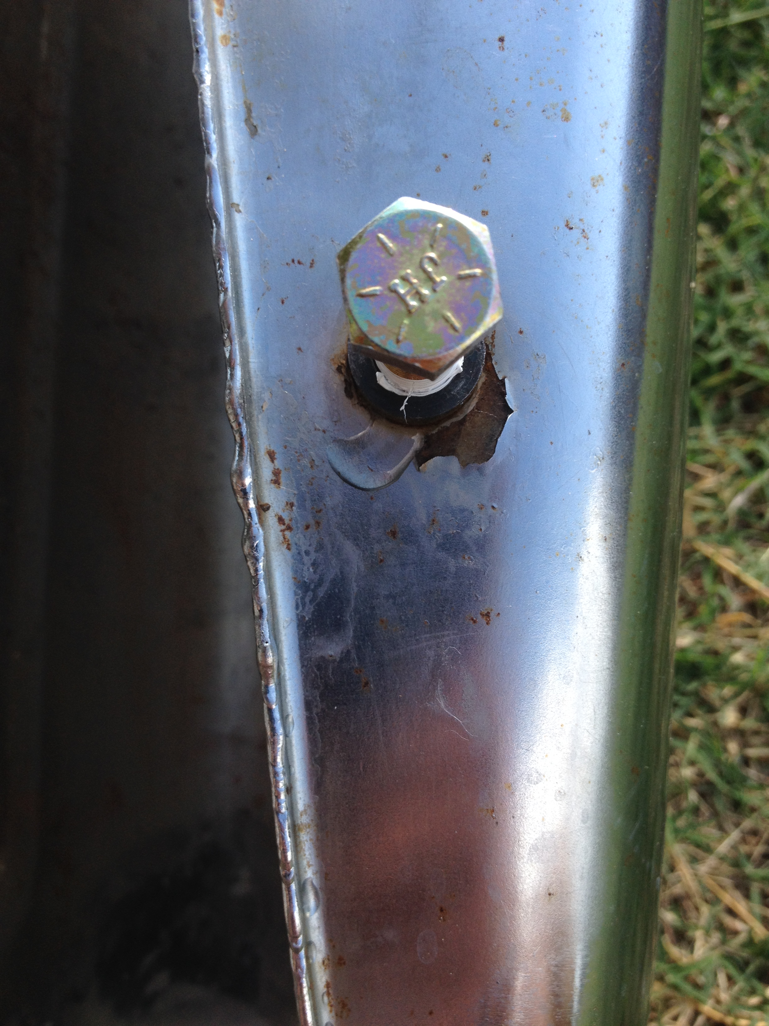

I have a M94 Wombat and was just about to send the tank to be re-chromed and discovered it is leaking around where the petcock goes.........
GGGGGrrrrrrrrr.
Any suggestions?

There are the tank lining systems for small pin holes. The chromer may be able to repair if he does metal refurbishing and repair.

If the petcock boss is leaking where it attaches to the tank . . . I would lean toward welding it up. But I am one who steers clear of the tank liner systems if at all possible.
Since you are heading toward rechroming anyway, there is no concern about welding discoloring the chrome.

I too kind of tend to stay away from sealers but I do appreciate the suggestion. Ed do you think like Mig welded or brazed?
Ray.
Ray.

Liners are a last resort for an obsolete tank that has thin walls and pinhole leaks due to rust. If lining is the only way to return it to service, line it. If the metal is essentially sound but is cracked to perforated, welding or brazing is superior every time. Whether to MIG, TIG, or braze depends on judgment and access to equipment. Brazing is fine, easier to do for most folks, and far less likely to burn out the metal if it is thin, but in any case, the metal has to be clean of rust in order to weld or braze, so the outside at least will probably need to be abraded. Cheap sand blisters work fine for small jobs like this, just messy because they blow glass or soda or whatever you use all over the place. If you don't have a blaster booth, do it outside away from things you like.
Also, not mentioned yet, if you weld or braze, thoroughly wash out the tank with water and detergent. Otherwise something bad can happen.
I am curious to know if the leak around the petcock is simply a leaky seal, or if the metal is breached. Petcocks do leak sometimes. It isn't necessarily a defective tank. Could it. E just a gasket or o-ring?

My tank is leaking right around the petcock boss just as Ed described. And yes there is still a little rust in it I need to treat it again!!!
other than that and a very low budget the bike is coming along quite nicely. SLOW BUT NICE. I think I am going to try the welding route....Just wish I could do it myself.....(not a welder at all!!!!)

RayRay, from the photo, it appears very likely that the boss is leaking at the weld, which is probably why the chrome is delaminating. Rust is creeping in under the chrome and lifting it. Welding should be simple, but I would remove the chrome in the weld zone. Brazing will work for something like this. I would not use a liner just to fix this kind of leak. TIG, MIG, or braze in that order.
Re: Can you fix a tank leak ?
Yes that is exactly where it is leaking. I will check with one of my neighbors that has been welding things for me and see how he feels about welding it up. And I have heard and read all the good the bad and the ugly of liner systems and think for me I would try to get by with out.
