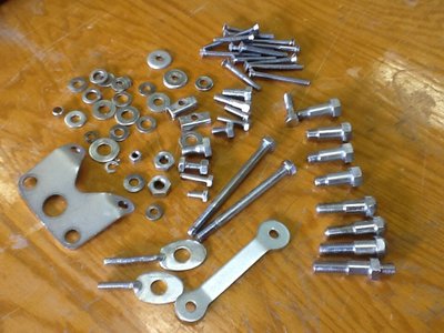

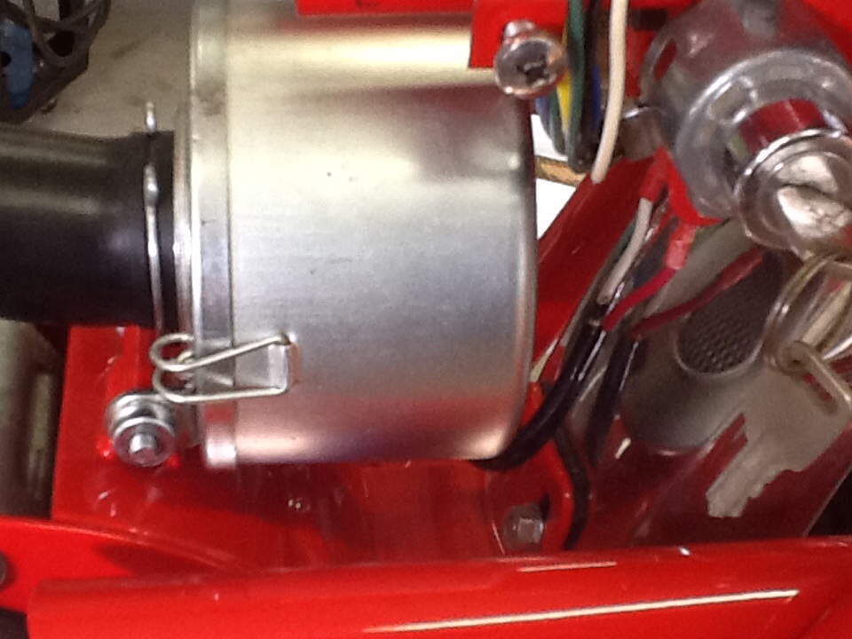

Camman
Posts: 41
Joined: Tue Dec 10, 2013 7:20 pm
Location: Oregon
Re: Restoring Nuts and Bolts
Post by Camman »
Here are a couple photos. The air cleaner is NOS for comparison. The plating company will clean the parts before plating so you don't need to prep the parts. Check pricing as the cost varies from one company to the next. If you are in the northwest, here is the company I used recently. TFC plating in Portland OR. 503 771-0969. TFCplating.com.
-Chris
