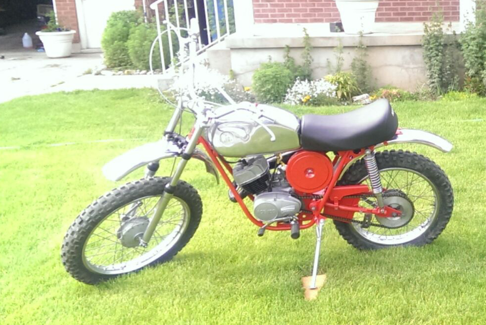

I thought I would post an updated photo of the Model 93 Super Rat rescue:
Hoping to have it ready to ride before HD15. This one has proven to be more intensive than my Ace 90 that I resurrected. (Some of you may remember the Ace 90 that I found buried in Dad's backyard). I have to mention though, I'm quite pleased with the paint color match. The ladies at the local automotive paint store are quite good at it.
The only parts that I'm missing now are the typical kill switch and chain guard. Luckily they are not critical for operation, i.e., aftermarket kill switches are available, but I'm still on the lookout for some killer deals/trades...

Looking sharp Roger!!
Give me a shout sometime - I've got a Rat kill that's just been sitting on the shelf...
Laurie
Laurie

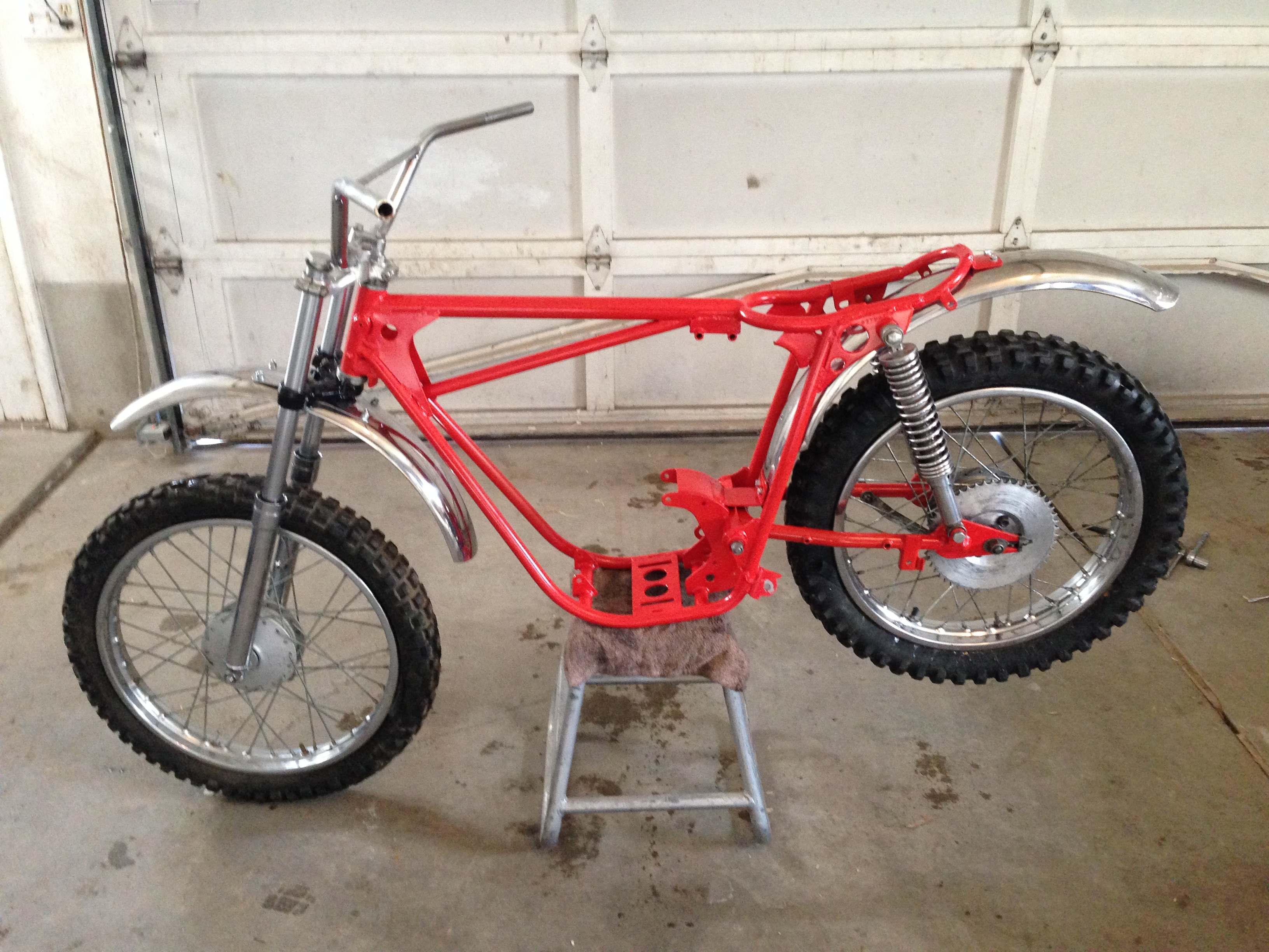

Almost done...
One final parts order and we're off to HD15!

Roger,
Did the chain guard workout. Is it on the bike pictured?
Gary
Gary

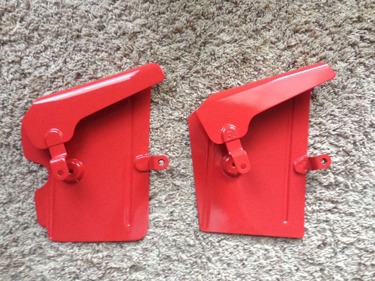

here's a question....
These are obviously Super Rat chain guards. But I was wondering about the cutout shown on the left chain guard. Was it used on later or early models. I've seen 3 variations of this cutout, of which I have two in the photo. The one without the cutout came from a 93B but will be using it on my 93. Just wondering if anyone had an insight on this or is this just one of those subtle changes that were made over the production run.
btw, they are exactly the same size. The photo and the angle from which I took it makes it a optical illusion
Gary: the one on the left is yours. It turned out pretty good.
Re: Super Rat rescue
Pretty sure the cut outs are for frame clearance. The swing arm pivot is wrapped with about an eight inch plate in an open arc facing rearward. As the swing arm tracks through its range of motion, the parts of the guard that are cut out tend to approach the top and the bottom part of that structural wrap. Later models probably had more axle travel, or the guard may have been positioned slightly forward from earlier models. Whatever the reason for the change, I think it was to provide extra clearance in these areas.
Also further forward, bigger tire.
MTRob
MTRob

Those pictures are great. Now I know what to look for. Anybody have one to sell or trade? My 93 needs one. When I 1st got It I had visions that I would take it to HD15, but some parts are very hard to come by.
Postby Gary G » Fri Jun 05, 2015 7:14 pm
Roger,
Nice catch on the chain guard difference. My 2 cents is that the 93a and 93b had the chain guard with the cut out clearence. The 93 had the "smaller" swing arm (non cushion hub) which used the chain guard without the clearance cut. If I am wrong hopefully someone could let us know. My intentions for my 93's that they are as cols to original as possible.
Gary
Gary G
Roger,
Gary
Gary G
