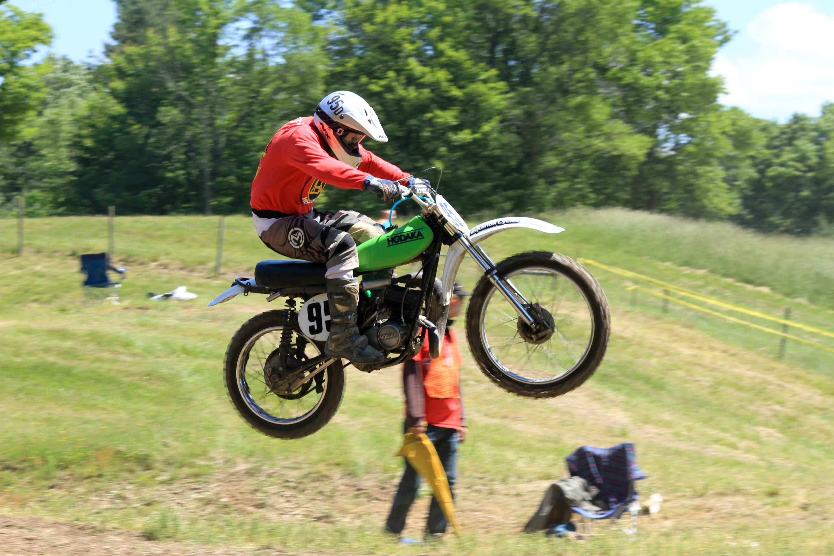

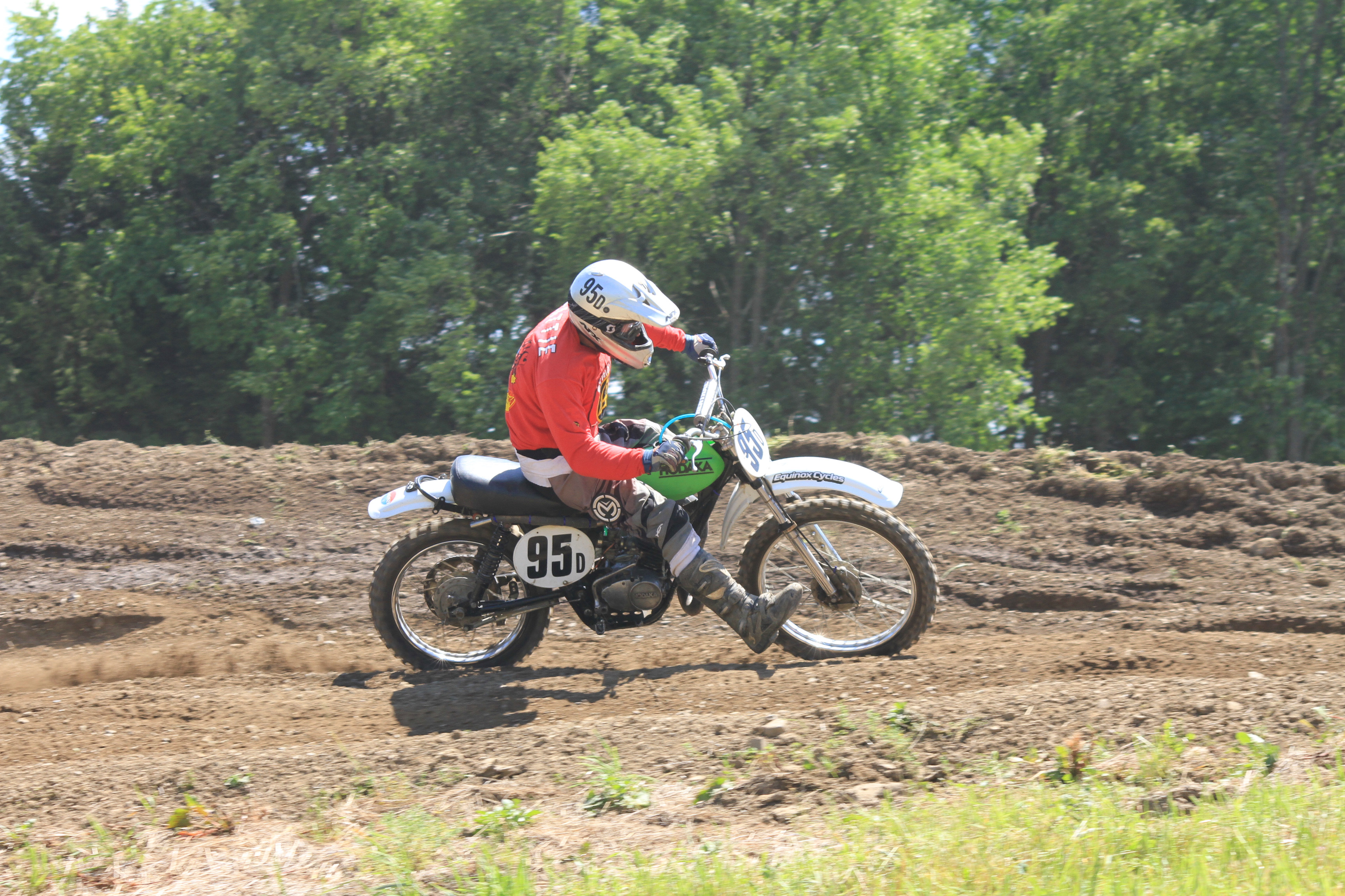

Marty,
If this worked right I am attaching a couple of photos of my Road Toad winning both motos the 100 Expert Class at Unadilla Rewind. It is basically stock with a HT2 pipe, Progressive shocks, and plastic tank and fenders. It is an awesome bike and beat the National points leader (on another brand) in both motos!
Re: 1975 road toad
What Mr. Beattie neglected to say is that even at the age of his being he rides like a teenager. That boy can ride! He also figured out a long time ago that horsepower is in the wrist.
Nice ridin' Ivan!
