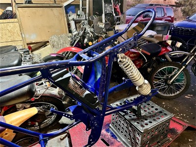

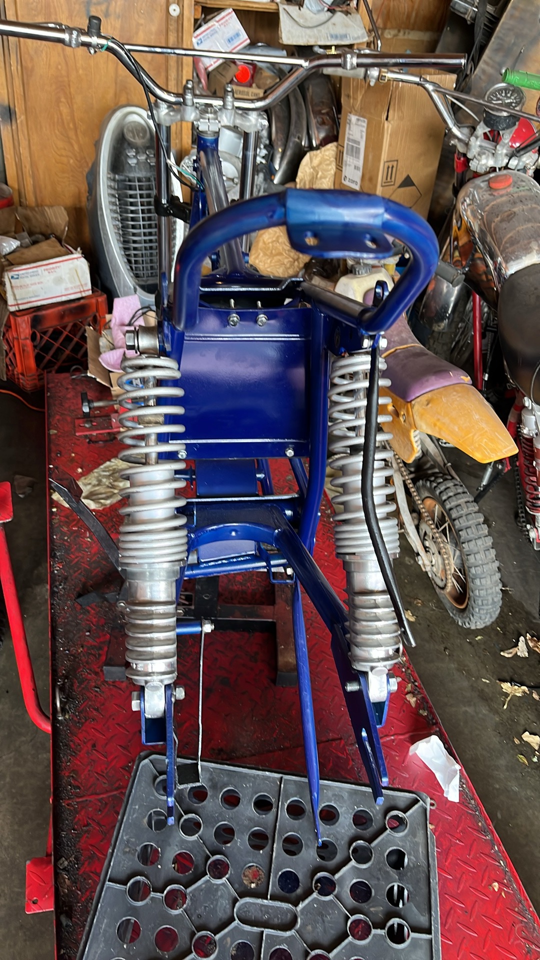

Dirty_rat. I made a spring depressor like the one Kelly shows in his videos! Works very well! I put one shock back together & started on the second when one of my J Hooks broke. Couldn’t find any long enough ones here in town, so I ordered from Amazon. They will arrive on Tuesday! Put the completed shock on the bike along with the air box. Just need to find my box with the filter in it! :ugeek: Victor

Progress report on my 98 Duper Rat! I was able to get the right shock together! It’s mounted on the bike!
I’ve added the CDI box, the ignition coil, the front fender mount, and I’ve started building the motor. Front wheel just needs tire mounted, and I got a matching DID alloy rim in the mail from Bruce Matty. I plan on spiking the wheel on Friday!

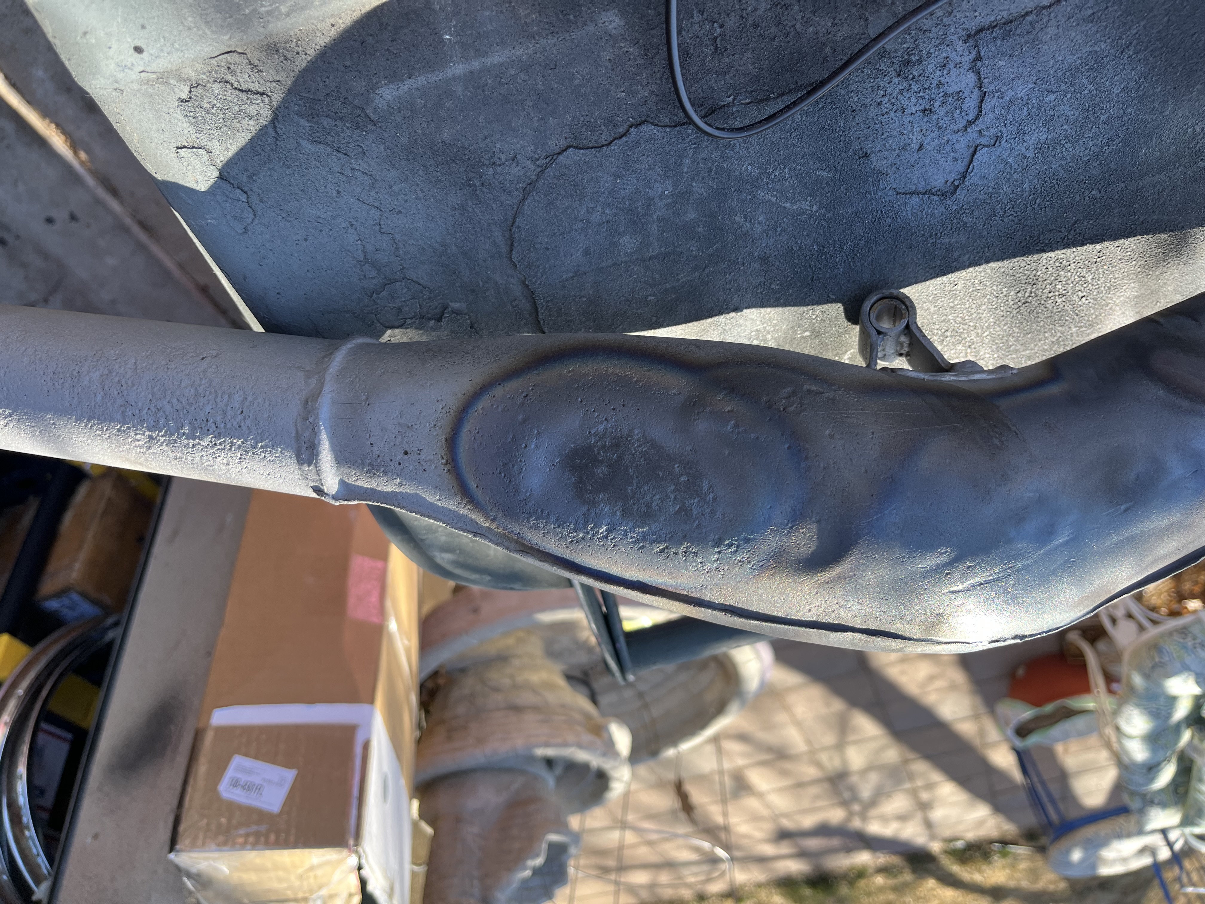

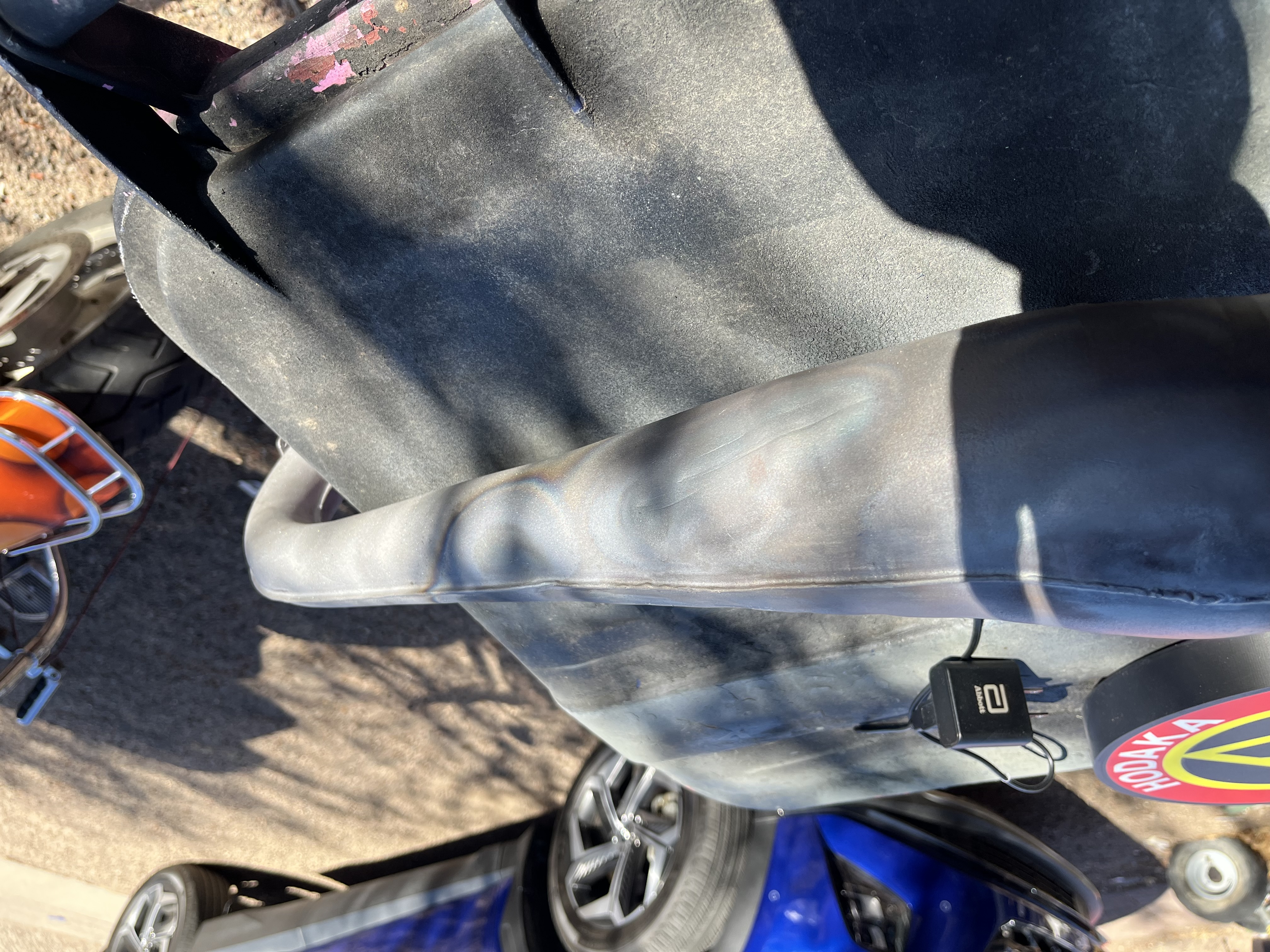

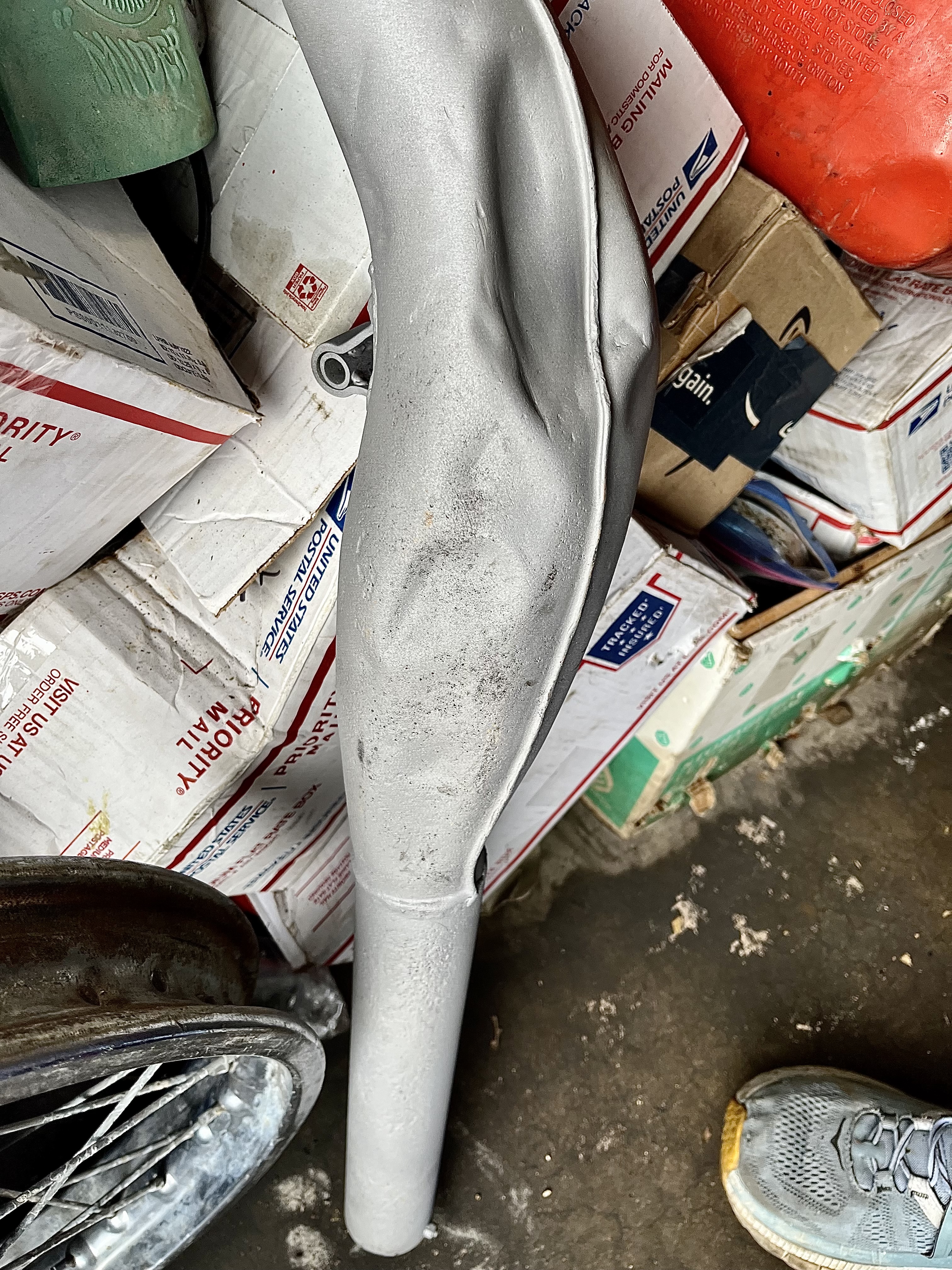

I also sent the pipe out to Get Dirty Dirt Bikes in California to have the dents removed. They received it beginning of the week. I’m just waiting to hear that it’s done & bring return shipped. I’ll post pics when I get it back. I was quoted it would only cost $50 to remove dents, plus shipping to mail it back to me.

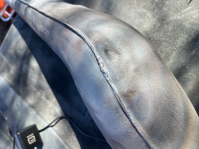

Got my pipe back from Get Dirty Dirt Bikes! David did a really good job on it. All the work done for $60! I think that was a score! He even found a small break in the seam which he welded shut. (Last pic). Before pics above, & here’s the after pics!
