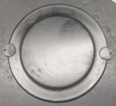

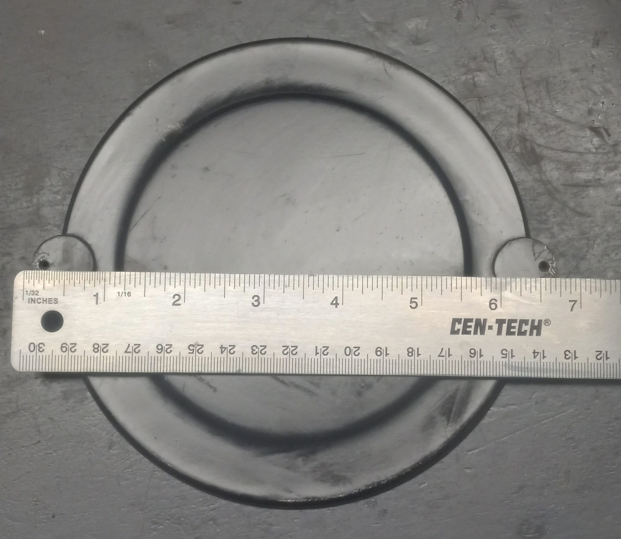

Re: Air filter setup for 97
Jay,
I was servicing a 98 Super Rat today and while I had it apart, I took some pictures. These might be helpful should you decide to fabricate your own.
