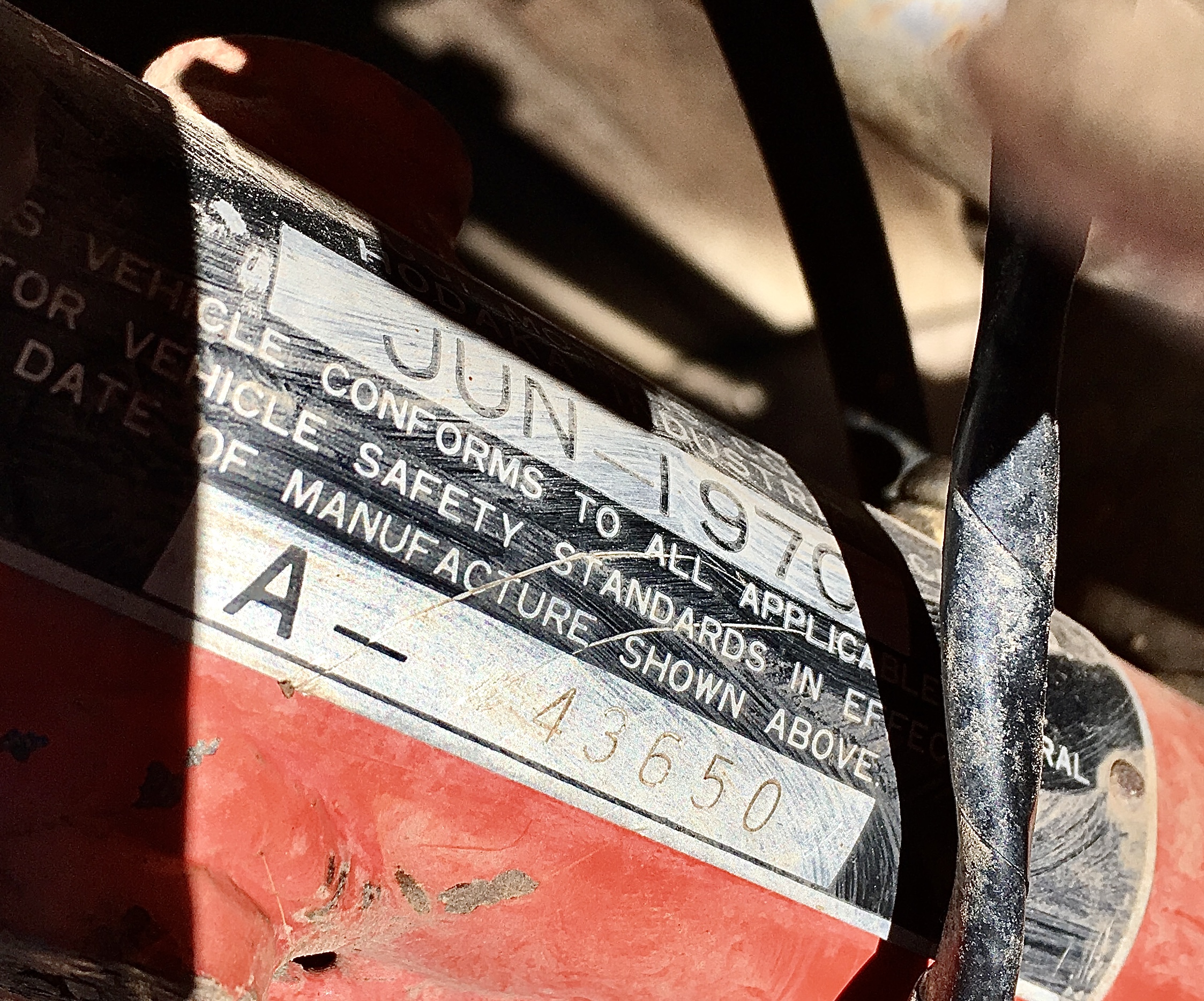

IT looks like my bike is a 100B, not a B+ with a frame number A-64486…….

All the 92B had a high fender, cushion hub with a overlay sprocket and a trip speedometer. The 92B+ also had the trip odometer did not have the overlay sprocket and it was built in the same era as the 93B. The 92B was the street version to the 93A and the 92B+ was the street version to the 93B. The 92B started with frame # 51013 and the 92B+ frame began with 67613. ---------- Clarence
Re: ‘71 B+ resurrection……First post newbie!!
Clarence, Is your first sentence correct? Looking for clarification. I thought the 92B had the low front fender but later builds had the high front fender. And the 92B had non-cushioned hub, overlay sprocket and no trip odometer.taber hodaka wrote: ↑Mon Jan 16, 2023 6:22 pm All the 92B had a high fender, cushion hub with a overlay sprocket and a trip speedometer. The 92B+ also had the trip odometer did not have the overlay sprocket and it was built in the same era as the 93B. The 92B was the street version to the 93A and the 92B+ was the street version to the 93B. The 92B started with frame # 51013 and the 92B+ frame began with 67613. ---------- Clarence
I really like your statement associating the 92B to the 93A and the 92B+ to the 93B.
Three super rats 93, 93A, 93B. three 100B's 92A, 92B, 92B+. The first super rat model 93, frame #B37211 was built, then more ace 100's the ending frame to the ace 100 was #A38712. Then the model 92A with the low fender and ace 100 exhaust painter black, was built with frame #A38713 and ended with frame #A51012. Super rat model 93 ending frame was #B53112 and the 93A started with frame #B53113. As the 92A ended with #A51012 the 92B started with #A51013. The 92B+started with frame #A67613, it was built before the super rat 93B that started with frame #B70213. ----- Clarence
Kevin there is no difference between the looks of a 100B model 92B and the 100B model 92B+ except the solid sprocket and some eternal items. I like the looks of the jeep the 70 and we all like your ace 100B. ---------- Clarence

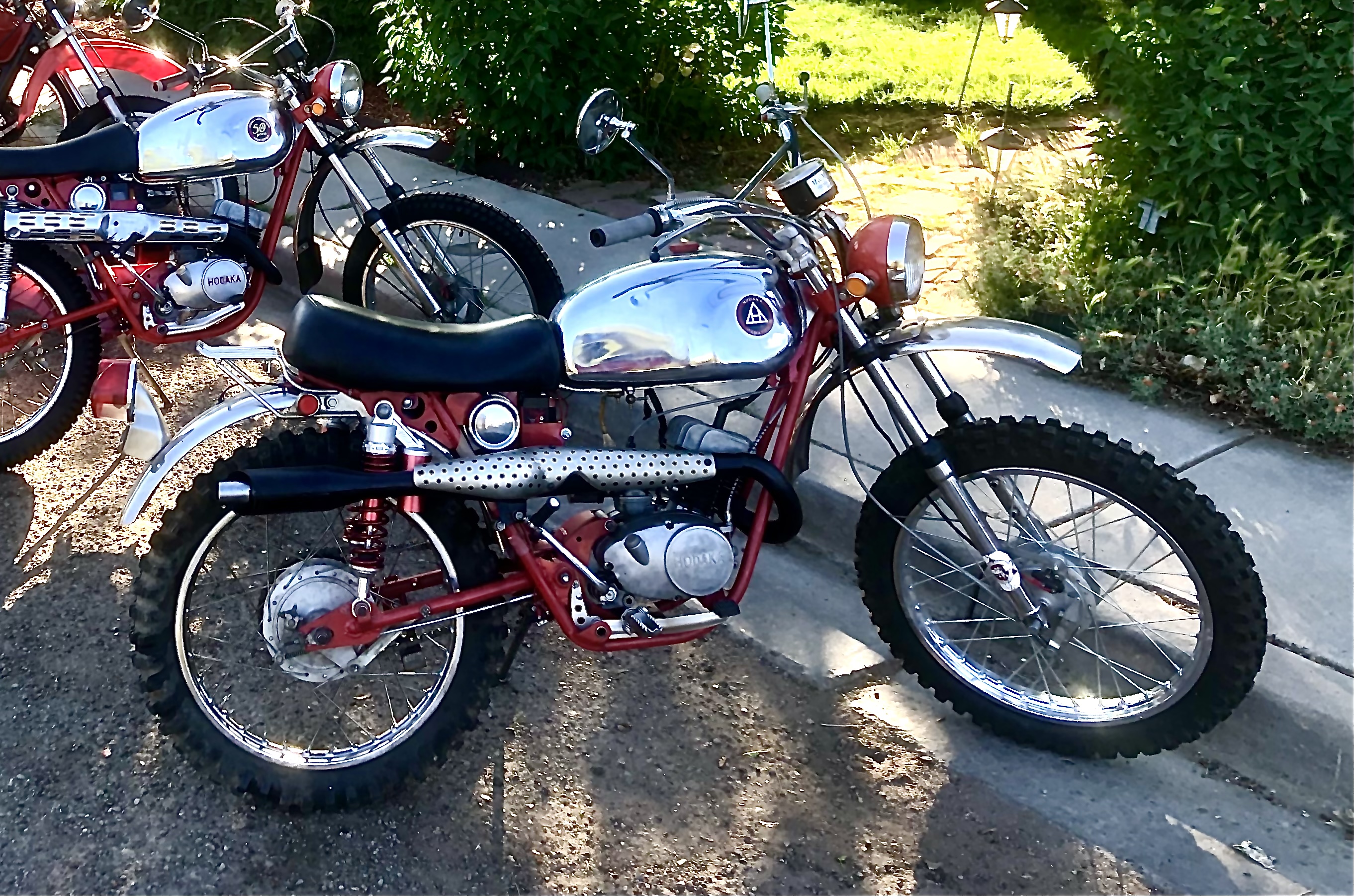

So Clarence. My Ace with the black straight pipe and chrome heat shield is frame number 43660. Does this mean it’s an Ace 92A and not a 92B?

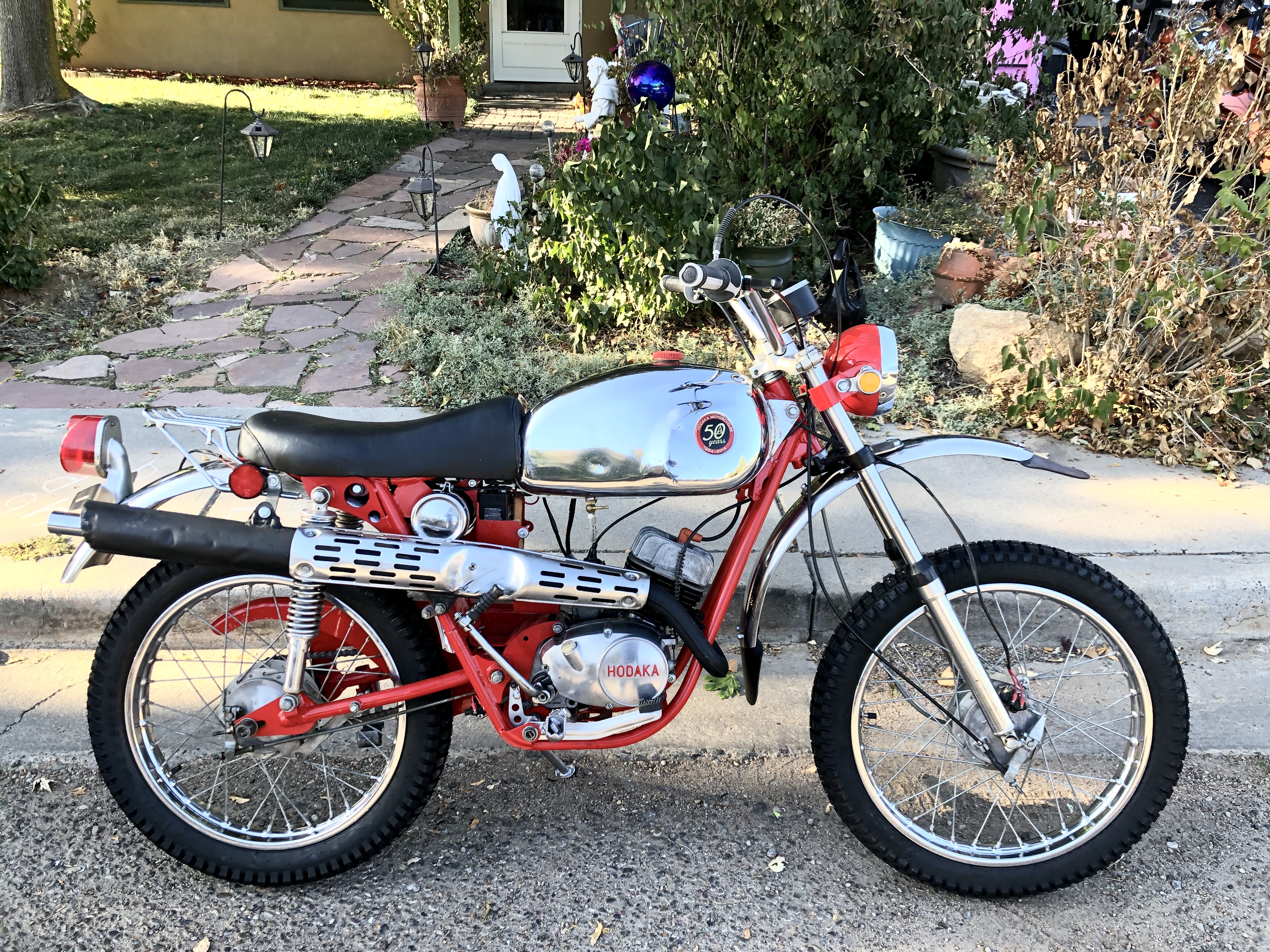

I added a B headlight & high mount fender because the original headlight was damaged and missing pieces and I didn’t have a complete low mount front fender. Just a fender bracket.
Yes Victor the last 92A was frame number A51012. the 92B started with frame number A51013, And yes that is a 92A exhaust. ---------------- Clarence

Sweet looking bike Victor! Love that pipe!
