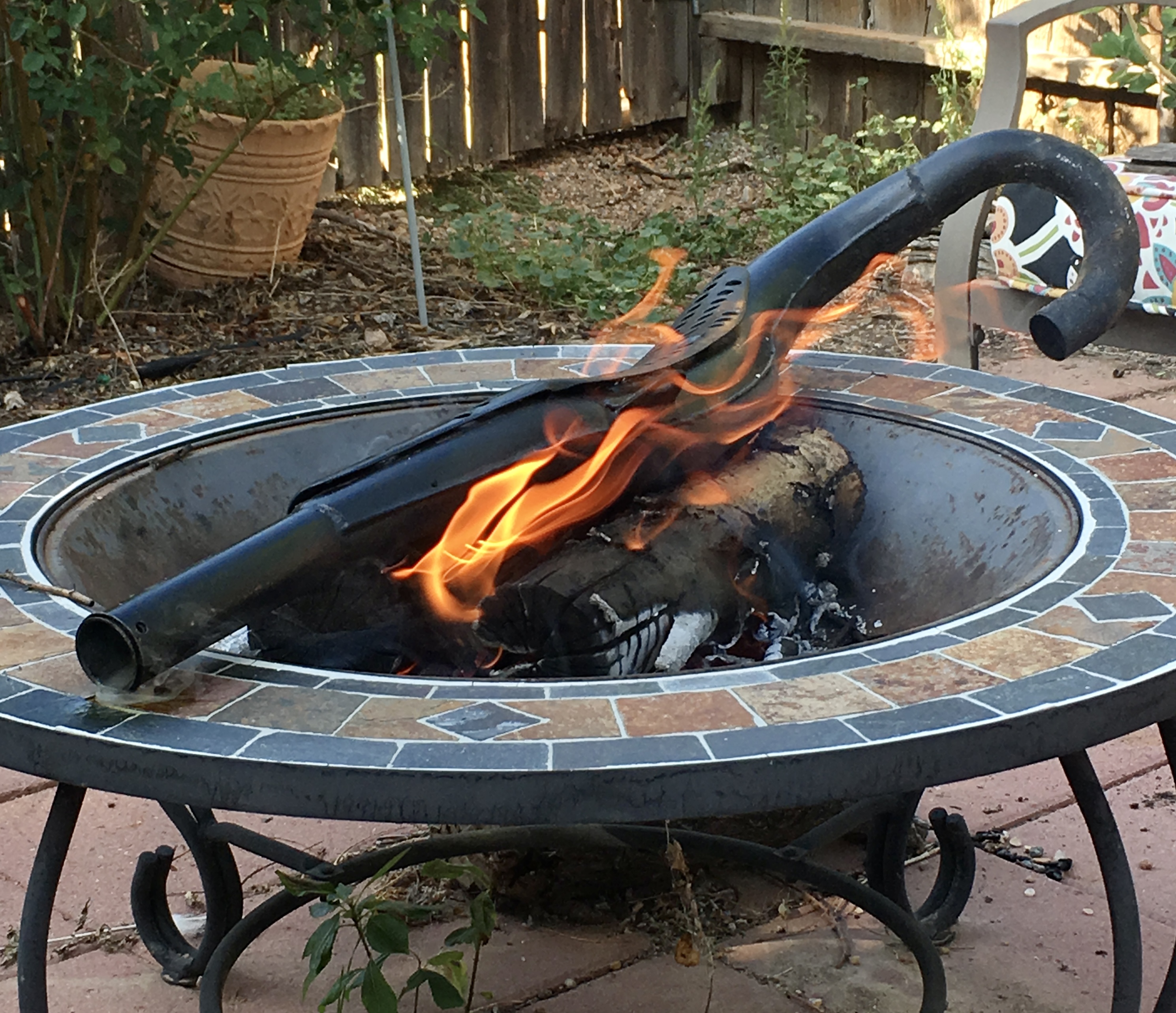

I would take your pipe off , build a fire and BBQ the pipe. Something I always do with a painted pipe (but not chrome ones). BBQ’ing the pipe burns out the carbon & oil built up inside the pipe. If the pipe is really bad, you may actually see it torching out both ends of the pipe.
Once it’s done torching, you can let the fire burn out and allow the pipe to cool. Then put it back in the bike & test how it runs.
If it runs better after BBQ’ing the pipe, then you can remove the pipe & paint it with satin Ceramic High Heat Black Engine paint.
If there are still issues, pull the main jet & clean it. Normally I would say pull the pilot jet as well, but since it starts & idles OK, your pilot jet sounds OK.

Sounds like classic pipe plugged syndrome. A lot of baffles and screen in these later pipes. Bugs love to crawl in and get stuck in the spooge collected in there. I would spend a couple minutes and take the pipe right off. Its gonna be loud but you will get an answer in just a few feet.
Re: Road Toad stalls out
Just removing the spark arrestor insert is not a complete test for pipe plugging. If you can't do the traditional "pipe barbecue" - at least run some chain (or a plumber's pipe snake) through the header bend - and poke a long wood dowel or metal rod in from the rear of the pipe to break through any wasp nests/mouse nests which might be in there.
BBQ…. Get the pipe hot! Burn up what’s inside. Oil, carbon, or like Ed suggested, bird nests, rodent nests, etc. You can remove your spark arrester and you can toss it on as well. Just remove any fiberglass packing.

Just now getting back to this. BBQ'd the pipe for a couple of hours, remounted the carb and it fired right up, ran well. Went through the gears but then right back to bog/stall. Thought the clean pipe was it, now it doesn't want to run at all. Will fire up cold after it's been sitting but simply won't run. Looks like it's getting plenty of gas, pulled the new plug and it's wet. Not sure of next steps. Sorry for the amateur hour. Thanks for any help or ideas!

Sorry for not getting back sooner. I was just now able to get back to work on this. Bullfrog was spot on. I pulled the carb and the pilot was gunked up. Must have picked up some loose crap from last cleaning, and yes, I have an inline filter. Anyway, blew everything out and the bike runs great! I didn't know that pipe was plugged up that bad. BBQ worked fine. Thanks for everyone's advice here!
