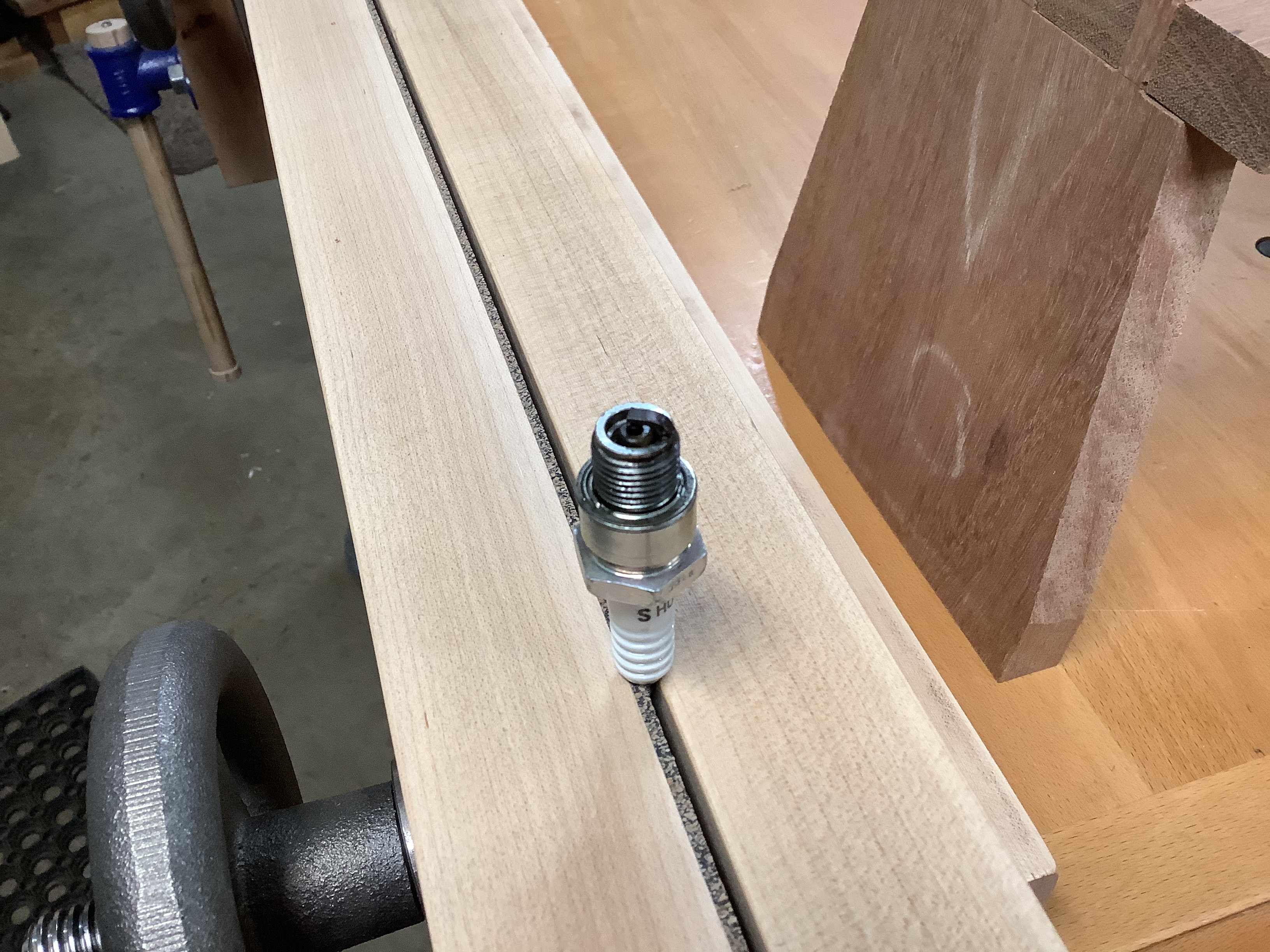

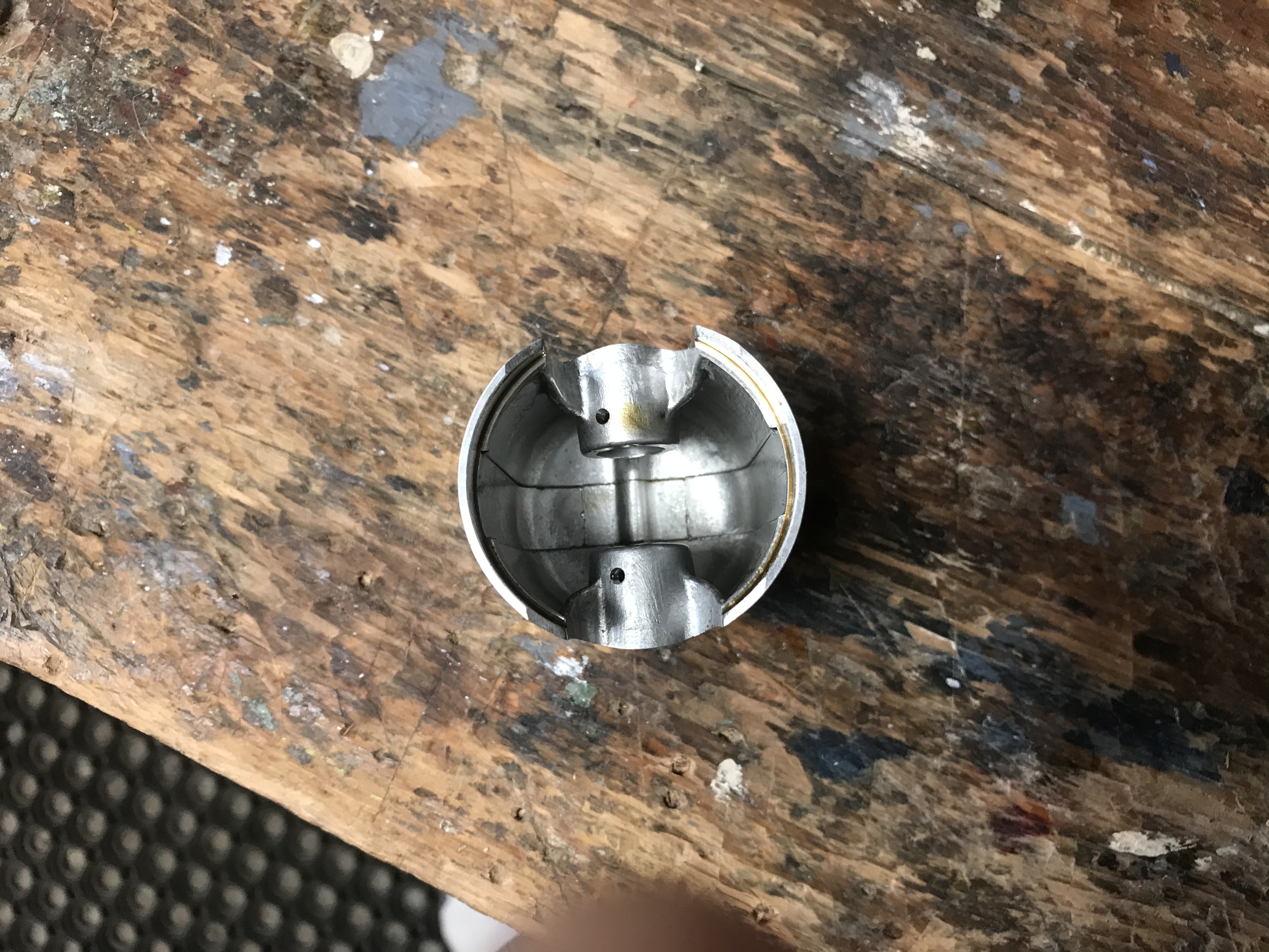

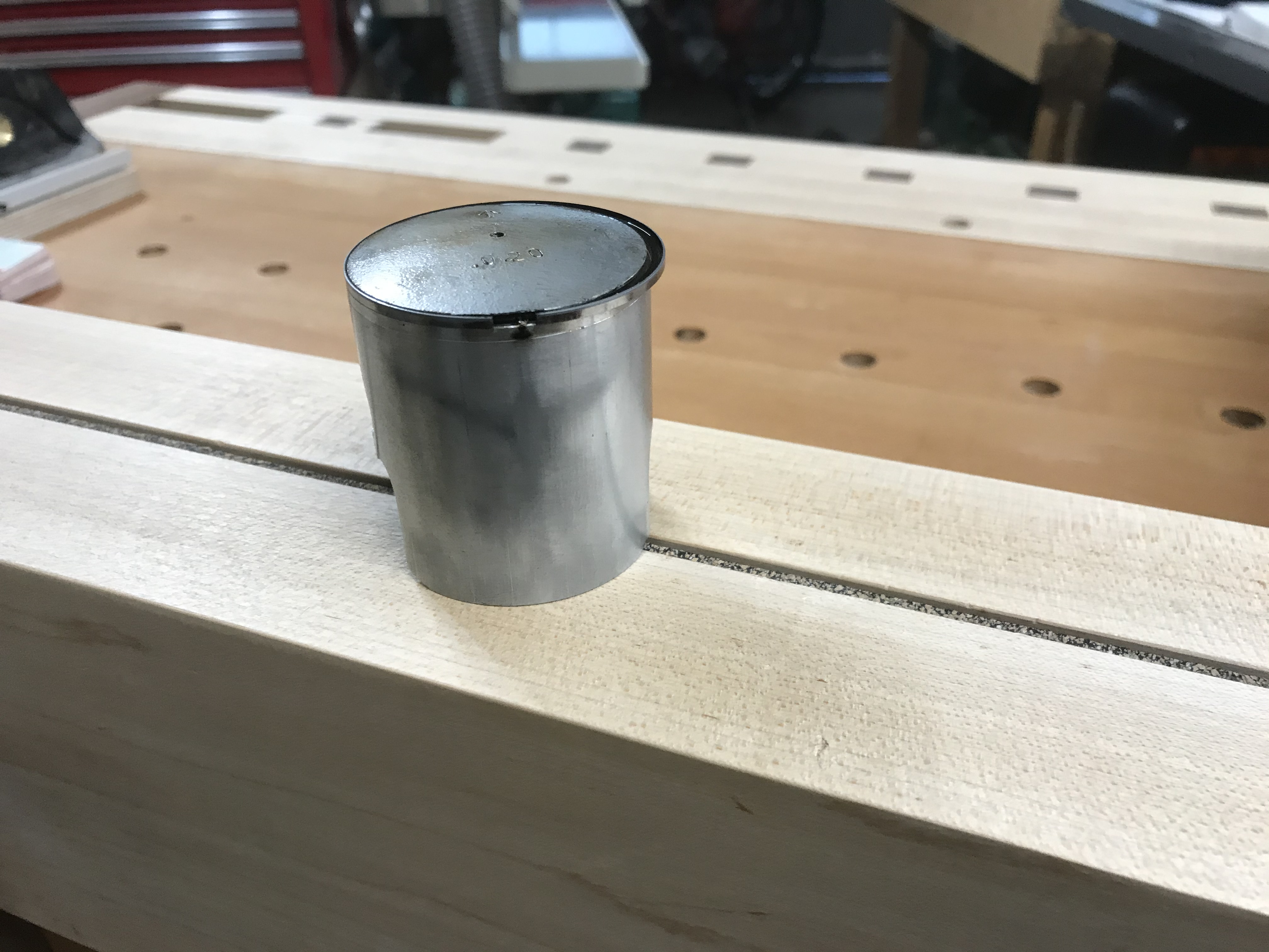

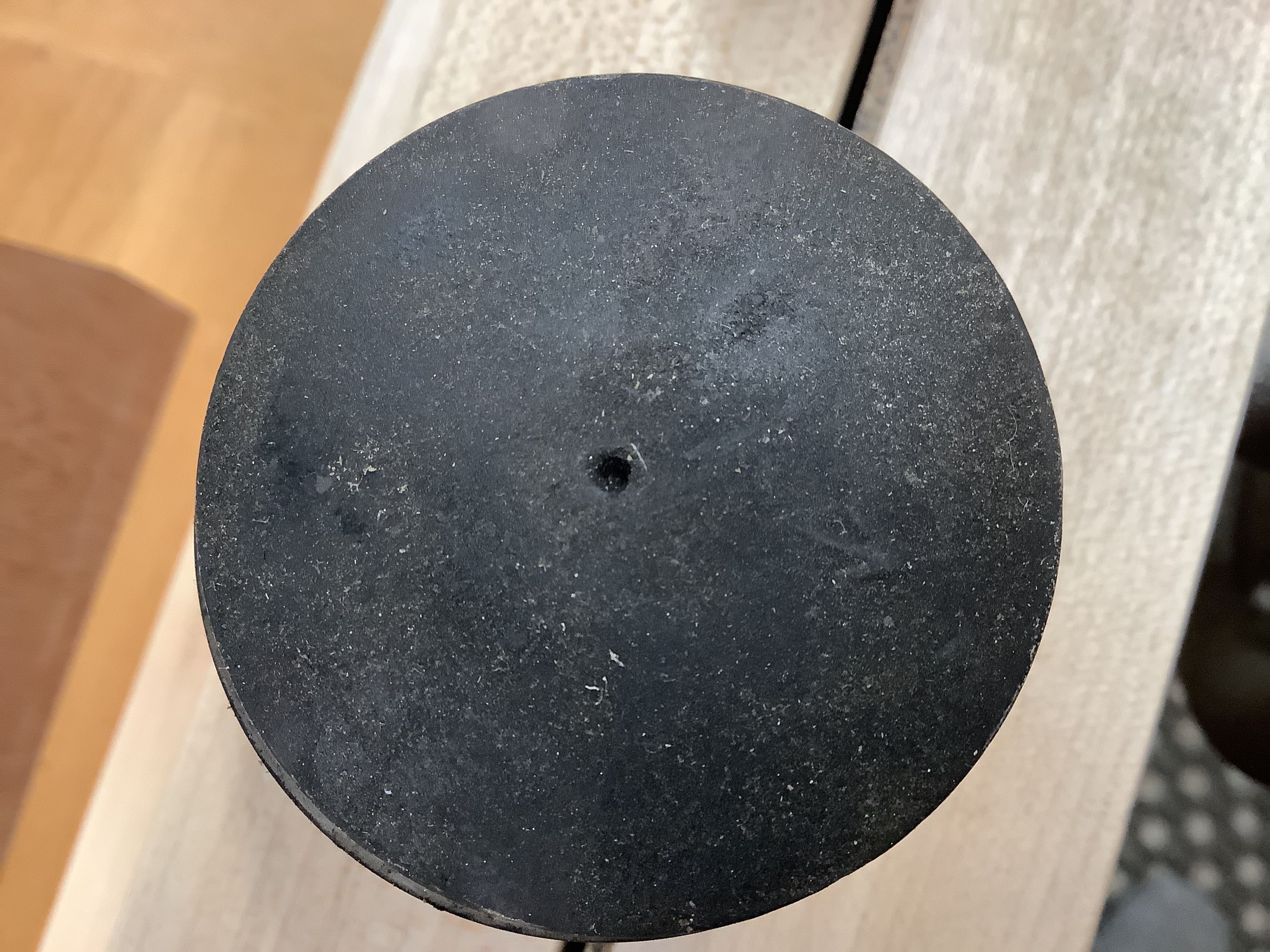

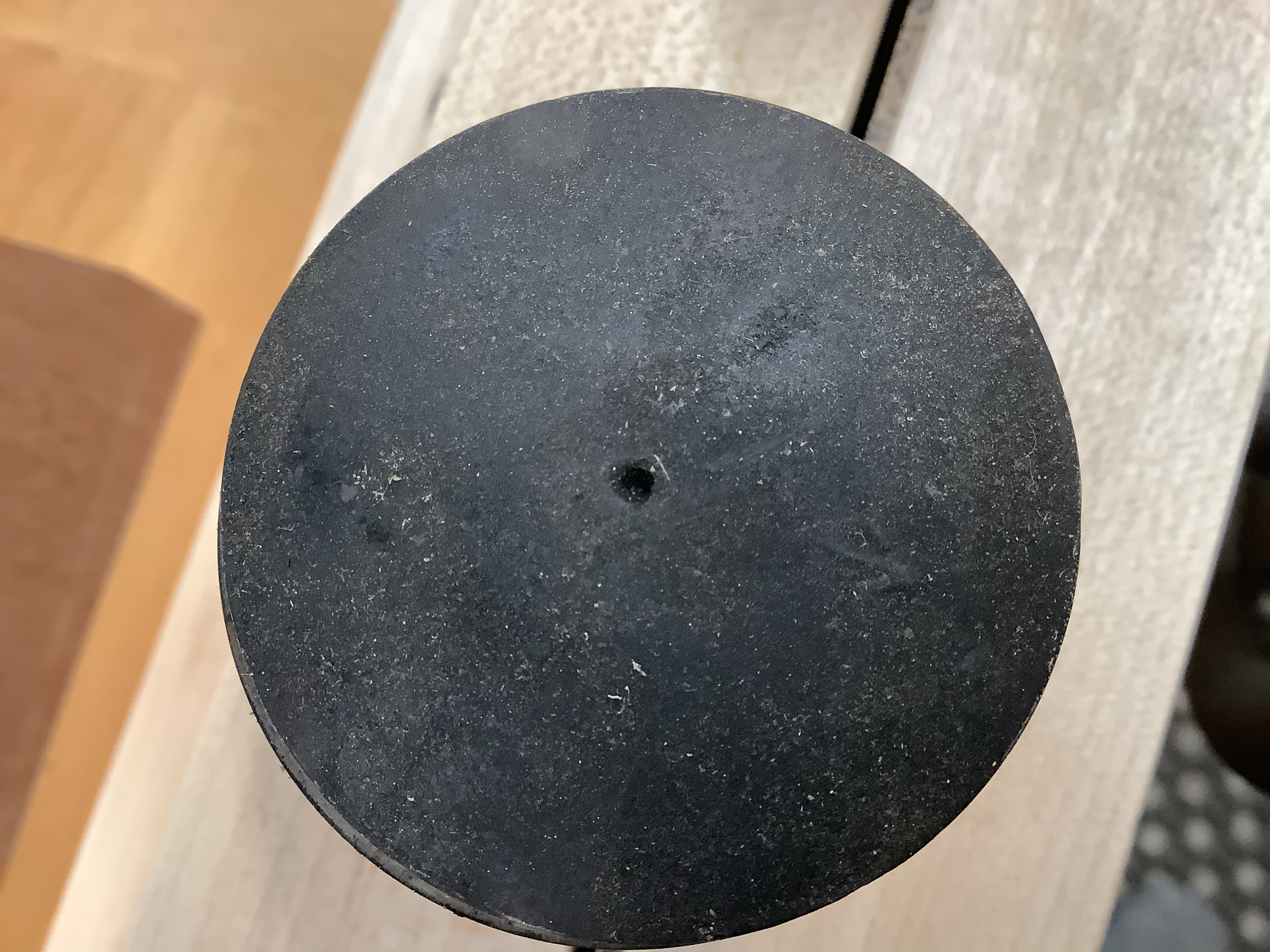

Here are a couple photos. Two are of the current plug. Two are the piston currently installed on the bike. And two are the piston that I took out before this one. Did a compression test and it only read 45 pounds with the current pissed installed

Does that hole go thru the piston? It is a center drilled hole used when manufactured.

The plug looks like a cold one, what oil are you using, show us the bottom side of the head. Does the hole go all the way through? ------------ Clarence

manufactured hole

Lets see a picture of the pistons sides. Could be as simple as worn rings. Low compression or air leaks will cause starting and operating problems. I dont believe the hole is anything to worry about. More info on symptoms before tear down will get you help and pointed in the right direction..

Hey guys thanks for the input. You’re right the hole in the piston is supposed to be there and does not go through. The piston look really good as do the cylinder walls. With compression only 45 pounds must be losing air somewhere. Thanks for guys help

This is a dykes ring Super Rat piston. The ring wears pretty quick. We used to change them after a couple of races. I dont see any signs of seizure or blowby that could have stuck the ring. That means your low compression could be a cheap and simple ring swap, or base or head gasket leak, both which you need to replace when putting it back together. I have seen mag side seal pushed out which will cause air leak and low compression. This can be changed without engine removal or tear down. Looks more investigation needed.
