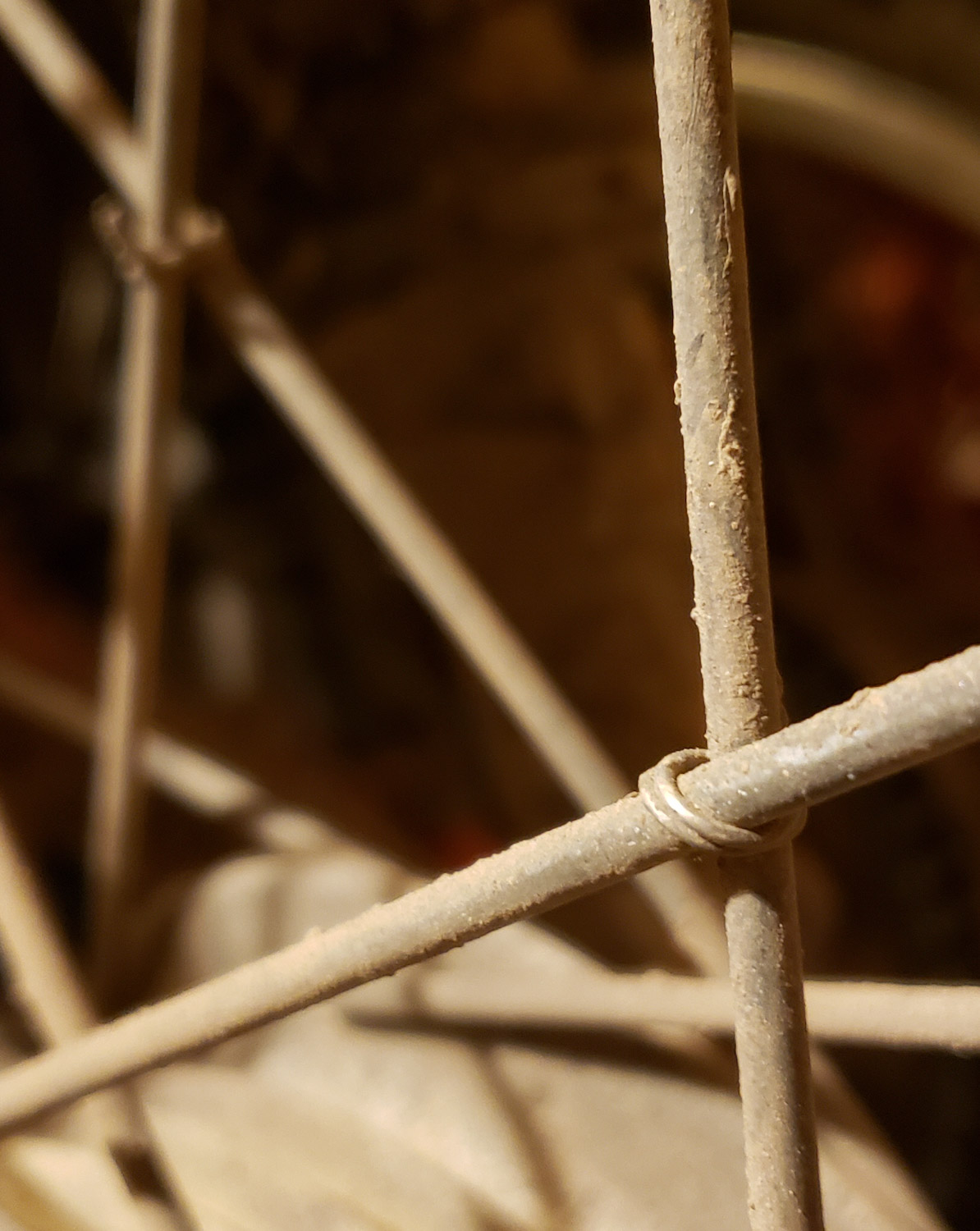

The photo is of wiring done on the rear wheel of my ISDT Qualifier bike sometime in the 1970's. The complete wheel is still in service (quite reliably, thank you very much) now. The wheel saw many hundreds of miles (perhaps several thousand) of practice and competition in the 1970's . . . between then and 2005 I don't really know what it might have been doing. But in 2005 (or so), the wheel returned to "go fast" and enduro riding . . . and is still in good, reliable condition.

I agree with everything that has been said about the primary reason for wiring spokes is to keep a broken spoke in place and from causing harm. It's true that under ideal smooth riding conditions the top spokes are simply in tension, however pounding over ledges, roots, and rocks can put substantial side hits and loads on the whole wheel assembly. I believe wiring the intersection of the spokes does provide some structural rigidity and resistance to flex or damage from lateral side hits to the wheel assembly. Like Ed we wired our spokes, probably starting around 1969 or 1970.
