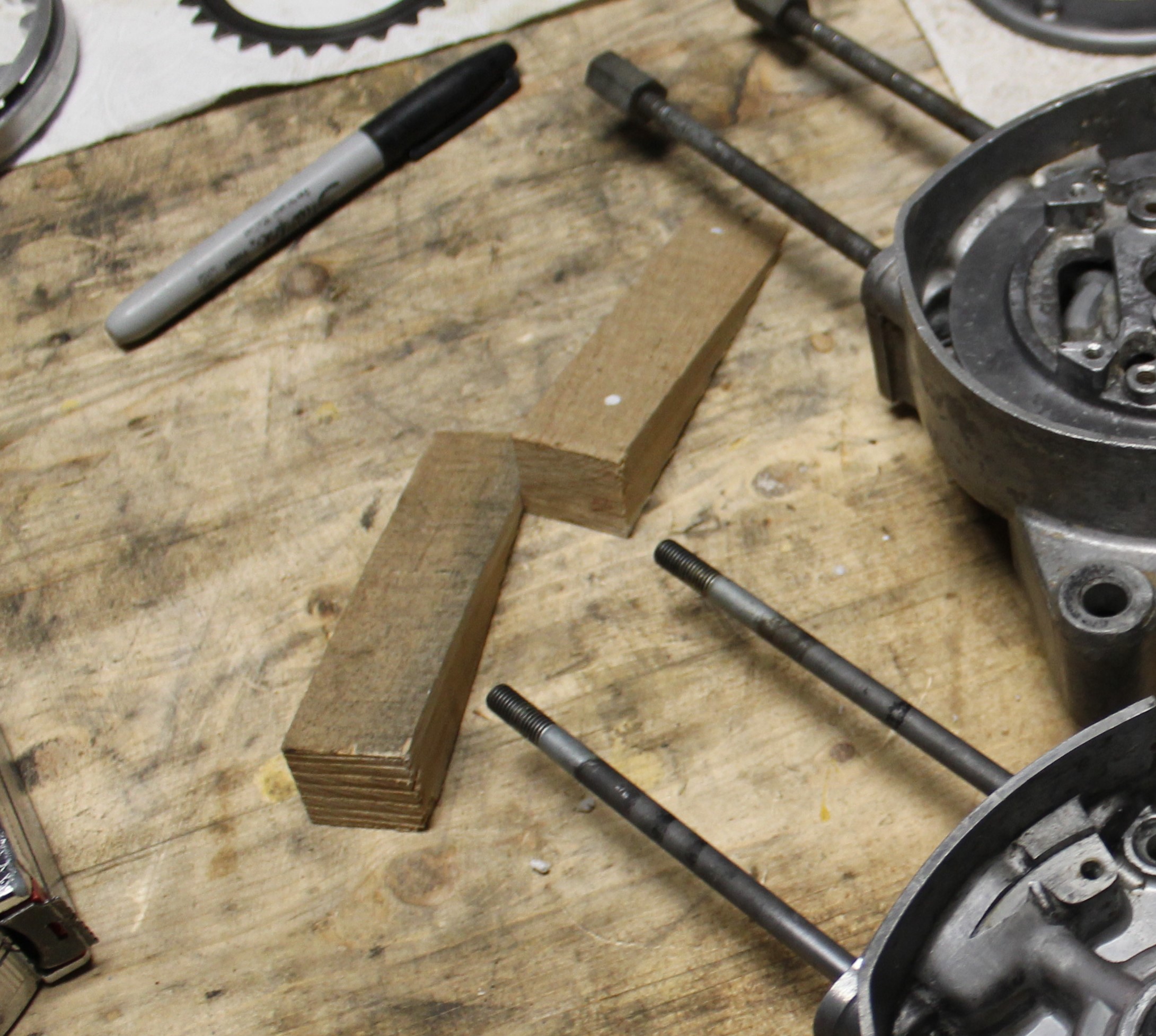

Man Clarence. I'm currently operating on your motor's Iowa cousin. I'm trying to build up a spare piston port SR motor and have been working on splitting the cases now for two weeks. I'm going top and bottom with two homegrown case splitting tools which get a turn a day each, heat, acetone/tranny fluid brew, more heat, dead blow hammering, epic potty mouth application, and they have not budged. I've already had to drill off all the case screw heads I couldn't get out with an impact driver. They are not great cases, but they are Rat cases nonetheless. I'm running out of ideas short of sticking a pry bar in the gap and just reefing the $hit out of them just to show them who's boss (don't tempt me). I'd love a great trick right about now. I've never had cases this stubborn before.
Re: Mission impossible
before you grab the pry bar how about hard wood wedges , nice 3 inch long tapers , 0 to 3/4 inch use one every 2 inches around the gap in the cases , tap tap tap your way around , finesse it. nice even pressure
Hey, that sounds feasible AND safe for the case edges. I'll give it a whirl. Better application of the impact force in a spreading fashion compared to whanging away with a dead blow hammer til I'm blue in the face. Finesse it is. I'll report.
matt glascock wrote: Wed Nov 11, 2020 6:55 pm Hey, that sounds feasible AND safe for the case edges. I'll give it a whirl. Better application of the impact force in a spreading fashion compared to whanging away with a dead blow hammer til I'm blue in the face. Finesse it is. I'll report.
Matt, I am wondering if the issue is rust. If your case has a roller bearing for the countershaft then you might have multiple spots where shafts are rusted to bearings. I would drop the whole thing in a 5 gallon bucket of warm oxalic acid for a week and then give it a go.

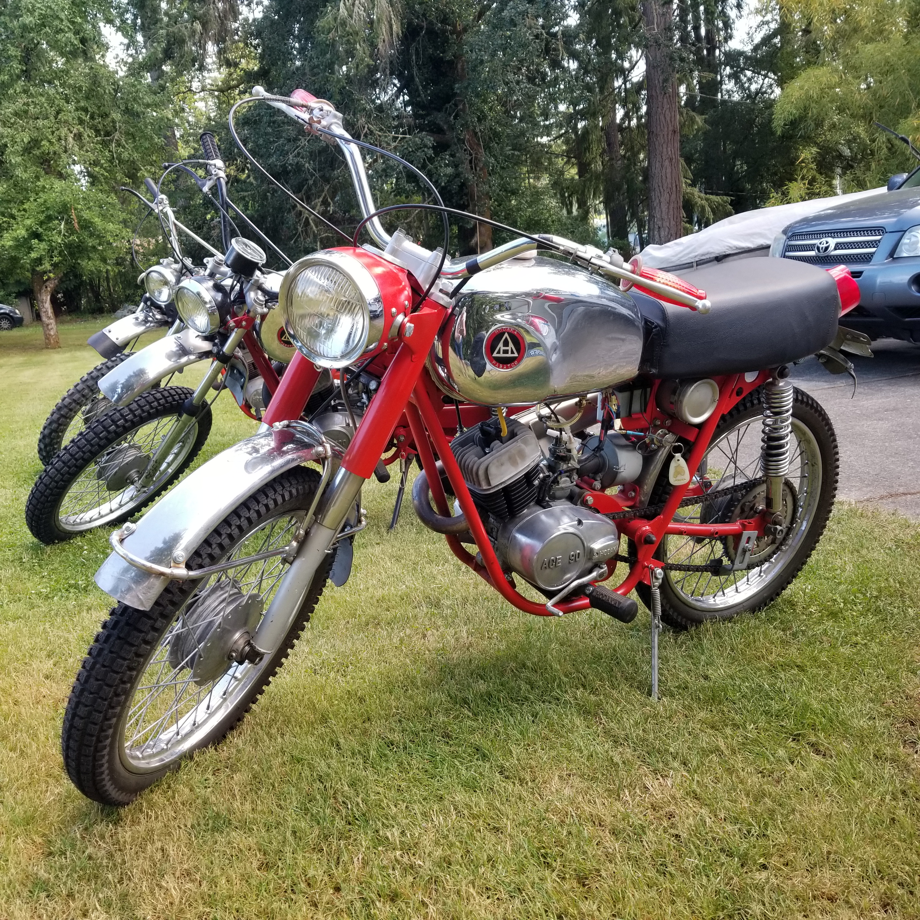

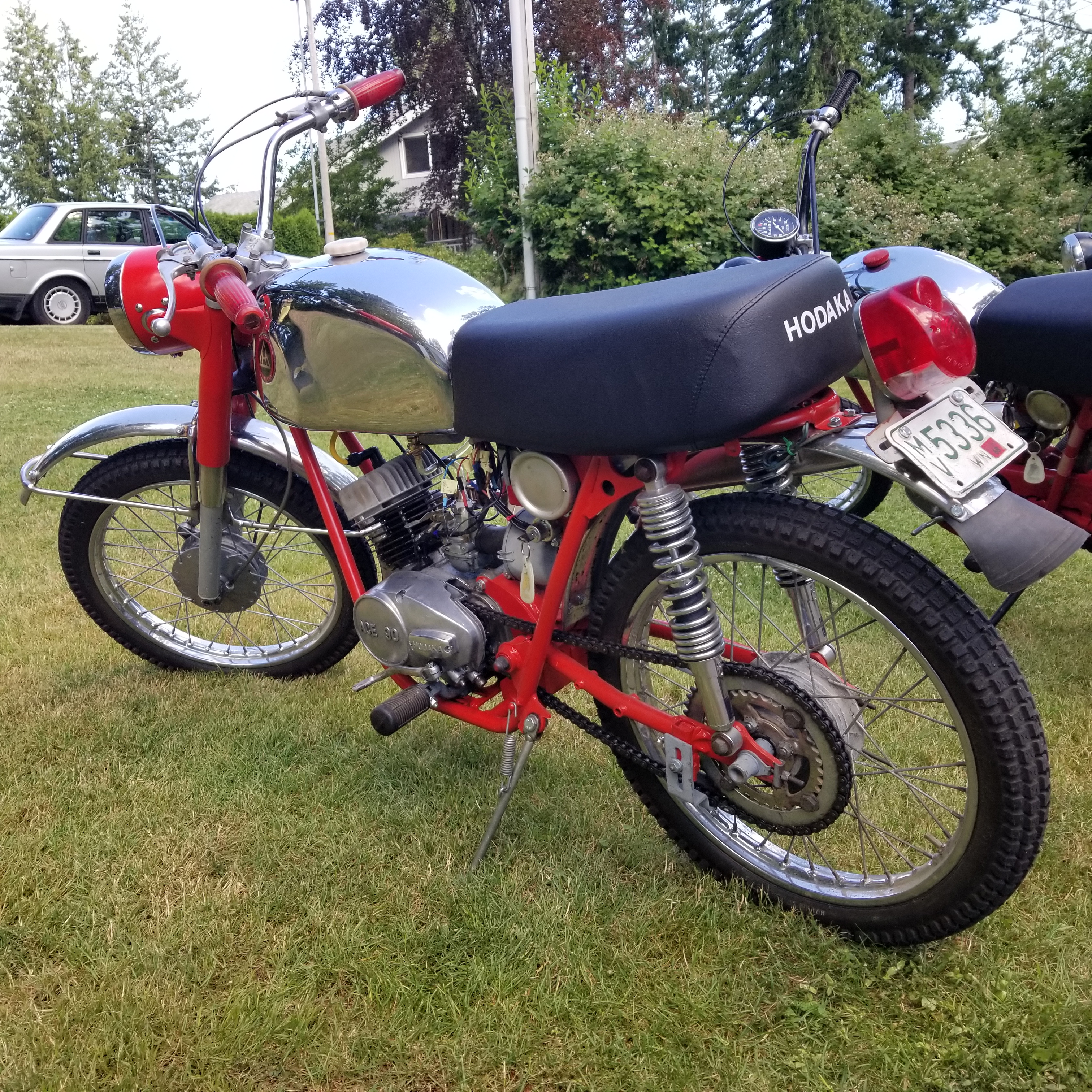

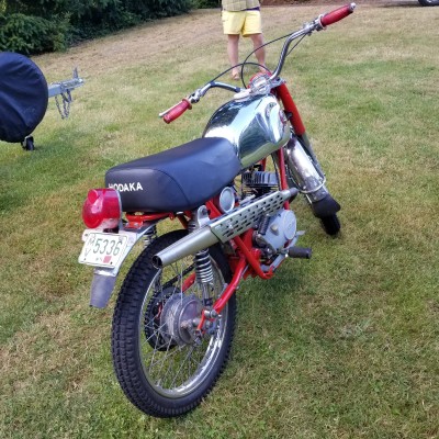

Hats off to Clarence for his fine work restoring this Ace 90, frame number A5980, 1965 edition. Clarence detailed his work in this post spending many hours undoing problems caused by unknown prior owner(s).
At Clarence's request, I am posting a few pictures of the completed bike.
Thanks Clarence. Warm Regards, James
