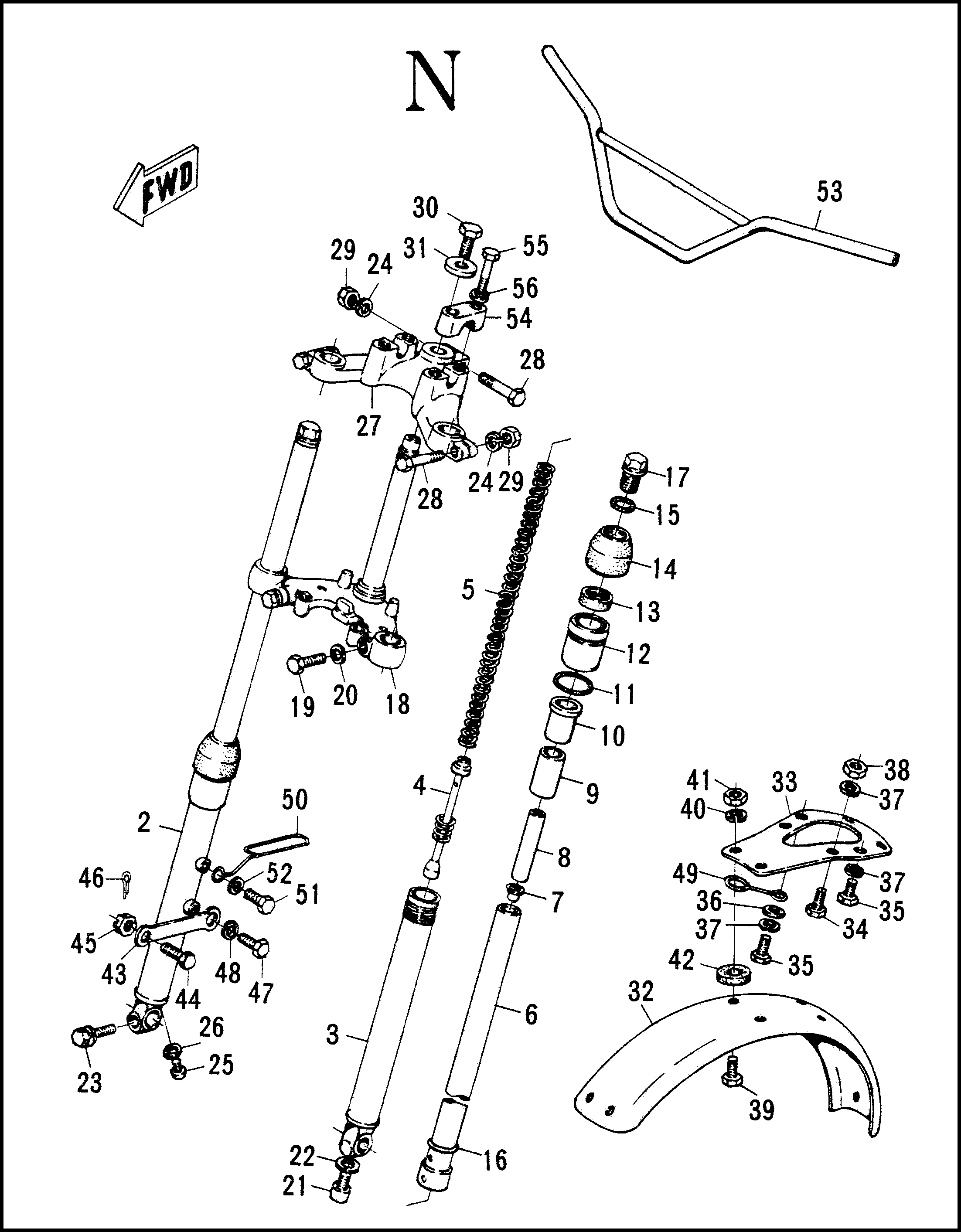

My 30mm Front Forks are still stock. I have just replaced the fork seals and stock fork springs. I added 5 ounces of 30 weight fork oil. There is about 1-2" of very soft easy movement in them. Is that normal?

Do you have a preload spacers installed?

Matt, I didn't install any pre-load spacers. Maybe I should?
Re: 30mm Front Forks
If the forks are properly assembled, the 30wt fork oil should give a pretty firm ride so that 1-2" of squishiness doesn't seem right. Were the springs in good shape? Is the spring retaining cap on top of the spring? That's the point where a preload bushing can be installed.

matt glascock - It has new springs and new fork tube caps. There wasn't anything else on top of the springs, when I disassembled them. Is there supposed to be something else?
socalhodaka - It is a Model 95 Combat Wombat.
The fork spring guide. That's also the place for shimming.
In the attached photo part # 7 is a hat shaped metal guide that goes on top of the spring. Part # 8 is a spacer that goes on top of the spring and spring guide. Part # 8 is around 4" long and provides spring pre-load. You can make this spacer out of PVC pipe or metal conduit. Then you can make it to the length you like to get the proper pre-load for you.

dirty_rat wrote: Wed Oct 07, 2020 3:20 am In the attached photo part # 7 is a hat shaped metal guide that goes on top of the spring. Part # 8 is a spacer that goes on top of the spring and spring guide. Part # 8 is around 4" long and provides spring pre-load. You can make this spacer out of PVC pipe or metal conduit. Then you can make it to the length you like to get the proper pre-load for you.

I have ordered the spring guides and the spacers from Hodaka-Parts.com. Thank you all for your help and comments.
Just as an add on, there are different length springs for the 30mm forks. The original springs were used in the model 92b, 93, 94, 95 and 96 (part# 938756). The Super Combat had a different spring(part# 978756) . The model 98 Super Rat came with another spring which was also used in the model 99, 01 and 02 (part# 988756). The last spring (part# 988756) was longer and didn't use a pre-load spacer.

Wow. So, according to the schematics, the 97, 98, 99, 01, and 02 basically have the "Fork Mod" built in to them already and they got rid of the spacers and added a longer springs. I'd bet they were decent little front ends.
