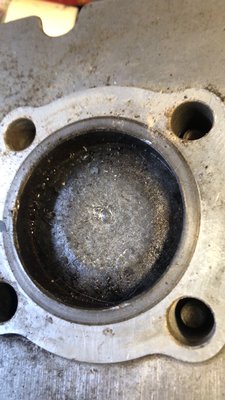

Well even the CDC Knock’er Loose didn’t work.
Then I started thinking about what I’ve used to remove rust and varnish, you know, from inside fuel tanks!
So, I poured some Muriatic Acid into the top! It bubbles away like soda poured in a glass! After about an hour the Muriatic Acid becomes like syrup. I cleaned it up twice and am on my 3rd dose of acid straight out of the bottle. Attached is a picture of the stuff! :ugeek: Victor
Re: Frozen Motor
Victor,
What happens when the Muriatic Acid eats through the piston and gets into the cases? It eats aluminum doesn't it?
