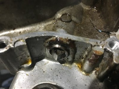

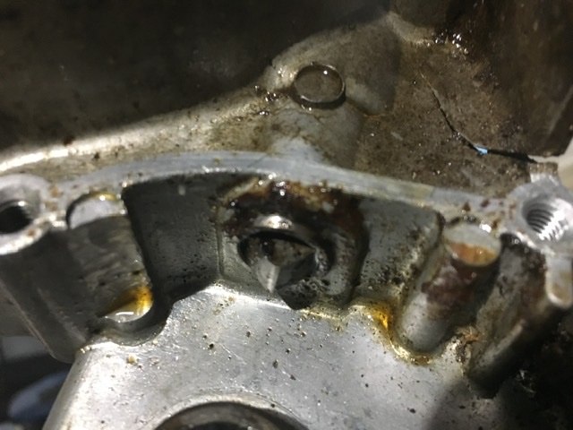

Just getting into a 250 project and one of the first orders of business is the shifter assembly. Took it apart and trying to get the old grease etc cleaned out and I ran into a issue with the ratchet gear plunger. This is different than the model 92 style I’m used to dealing with. I’m wondering if anyone can advise how you get the plunger out? This isn’t a ‘normal’ zerk fitting that I’ve run across. It doesn’t appear to be threaded to where you can unscrew the back end and push the plunger and spring out. It only rotates about 1/8 inch or so before hitting a hard stop. I’ve turned enough bolts, screws and petcock valves off by getting overzealous on the wrenching, so I’m hesitant to give it too much elbow grease before knowing what I’m dealing with. I heated it up with a torch and that appears to have at least loosened the old grease enough to get the stuck plunger to release, so it will at least move back and forth now to actuate the ratchet gear. But I’d still like to take it apart to replace the old spring at a minimum. All I have is the owners manual and I didn’t see anything in there about how to take that apart. Any ideas?

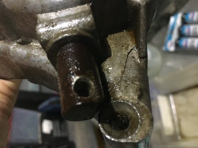

Thanks Darrell, I was able to get it out finally. Once optimism, determination and will power gave out, pure dumb luck stepped in. I was using a polishing wheel on my electric drill to clean up the casing when the plunger popped out even farther than it had before. I thought it had reached the end of its travel before but apparently the vibration got it to move the last little bit. Once out I just had to turn it 180 to line an indentation up with the bushing on the foot change shaft and voila. Now adding vibration to my list of tools (PB blaster and propane torches) for getting stuck parts to move. Hope this helps someone’s 250 ED project in the future.
