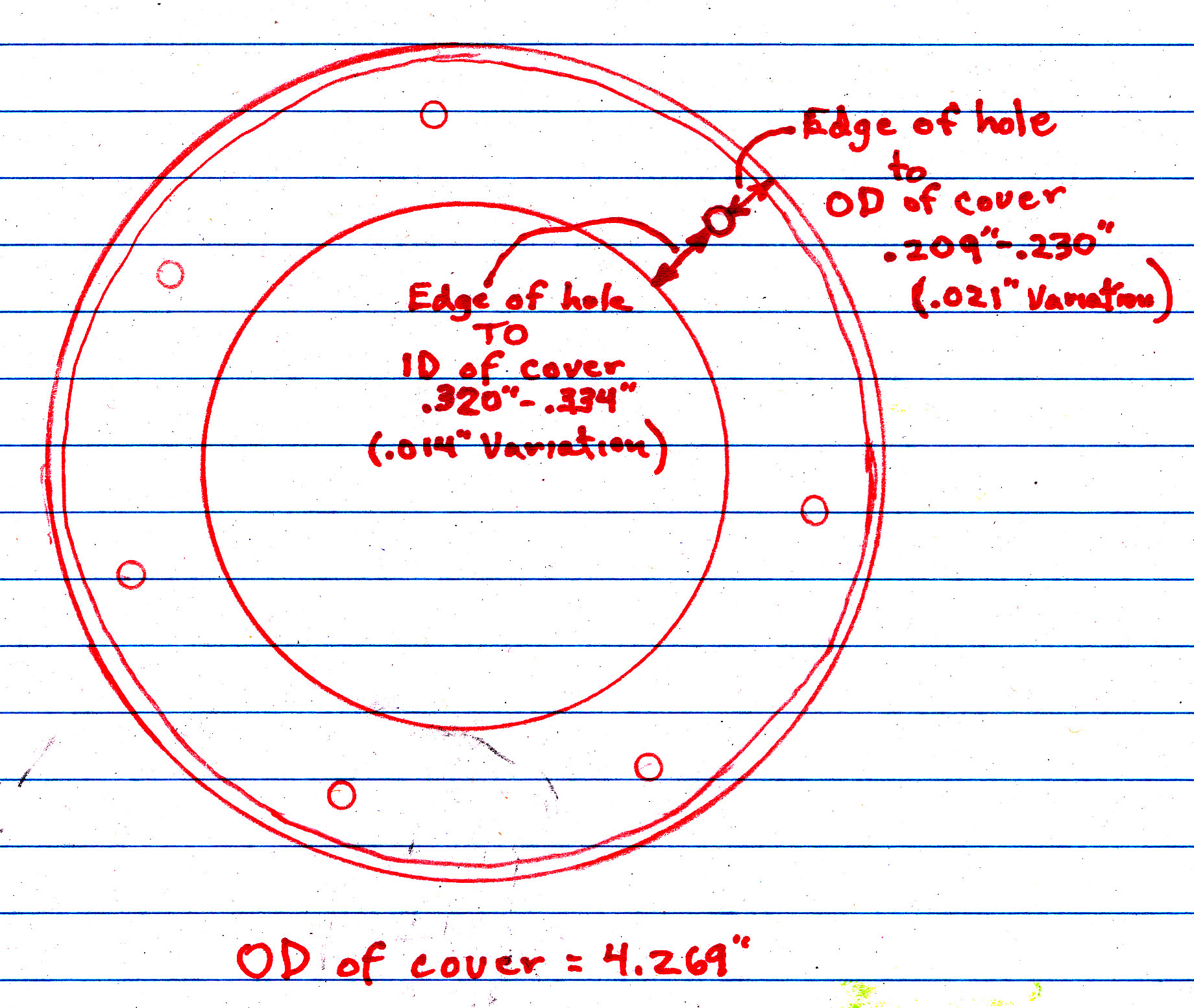

Zowie! I downloaded the clutch cover photo and printed it out at close to actual size. Then I semi-accurately measured hole locations as shown on the attached diagram. I had trouble believing what I was seeing. Sooooo, then I went to the basement parts mine and found an ACTUAL clutch cover to measure. The diagram shows the vernier caliper measurements on the actual part. It seems clear that the clutch cover is not a true precision part. However, since they have been quite serviceable on thousands upon thousands of Hodaka engines, it seems that the delivered precision is, um, "good enough". At least for most parts.
Keep us informed as you continue work on this clutch - OK?
Oh, getting back to measuring the nearly actual size photograph - I came up with roughly twice the dimension variations as the actual part. I'm thinking a different cover might indeed improve things a bit. Also, if you are a Hodaka Club member, there is an article on "blue printing" the Hodaka clutch to achieve smooth operation in a past issue of the Resonator Revisited.Keep us informed as you continue work on this clutch - OK?

ED, First Merry Christmas to you and yours, I like the way you went about determining the measurements on this clutch question, I have one question, since you found the cover plate is not as precise in the measurements of the holes cut into it., does it matter that much, as long as the screws and springs, disc, and oil are doing their jobs all is right with the world. Because of the parts mentioned, does not all parts in a clutch during much of its use "free Float" , all suspended in oil. As long as all adjustments are correct and the clutch works, properly, is the perfection of the drilled holes not that critical as long as all other items within a clutch are adjusted correctly and working. What do you think. I may be wrong, but it designed to "float" within its inner and outer rings or covers. Bruce

I'm going to file out enough space for the bolts to pass through and move on. The thing is a sandwich and the exact angle of the screws is not critical; all that matters is that they don't hang up on the steels. That said, these ones are so far off that the fiber plates are almost rubbing. Free float wasn't happening.
At $18 for a new cover I'm almost ready to replace it, but I could file out the space in a short time and all would be well until some future owner scrambles the plates.....hmmmm
