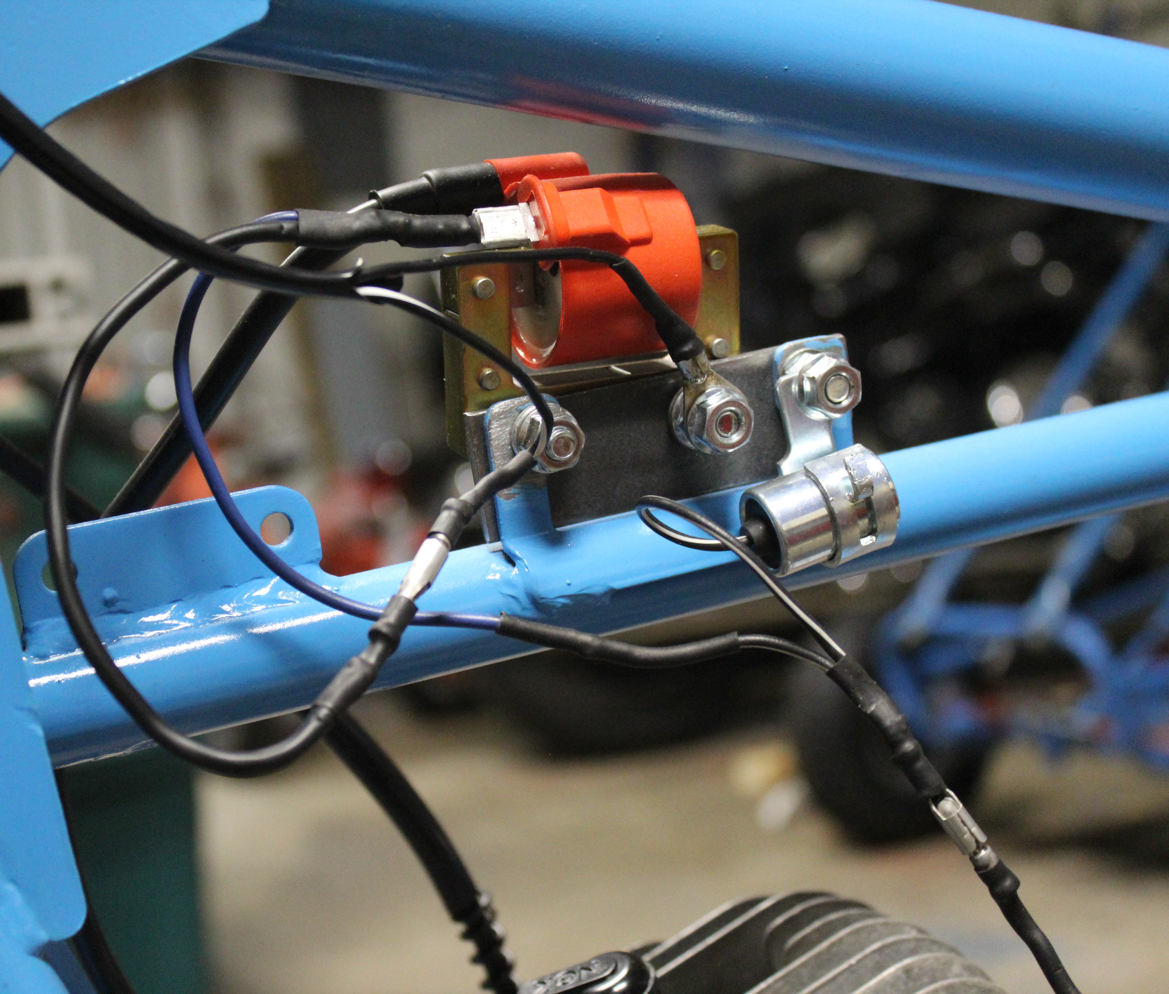

so i relocated the condenser up under the tank on a B+. that only has the primary coil installed on the Assembly plate .i took the primary coil wire and points wire and tied them together, the coil is grounded on the plate, then ran one wire up to the new condenser, from that connection ran a wire to the ignition coil, the condenser it's self is grounded to the frame where its bolted on , from the ignition coil connection i came off of that one for the kill switch the other wire from the kill switch is grounded to the frame. since i had one wire coming from the magneto i used small black gas line to match the holes in the grommet to put the wire thru and one just to fill the other hole. once i get this bucket of surprises runing so i can stop pulling thing apart i will tidy things up a bit and black silicone around the grommet
