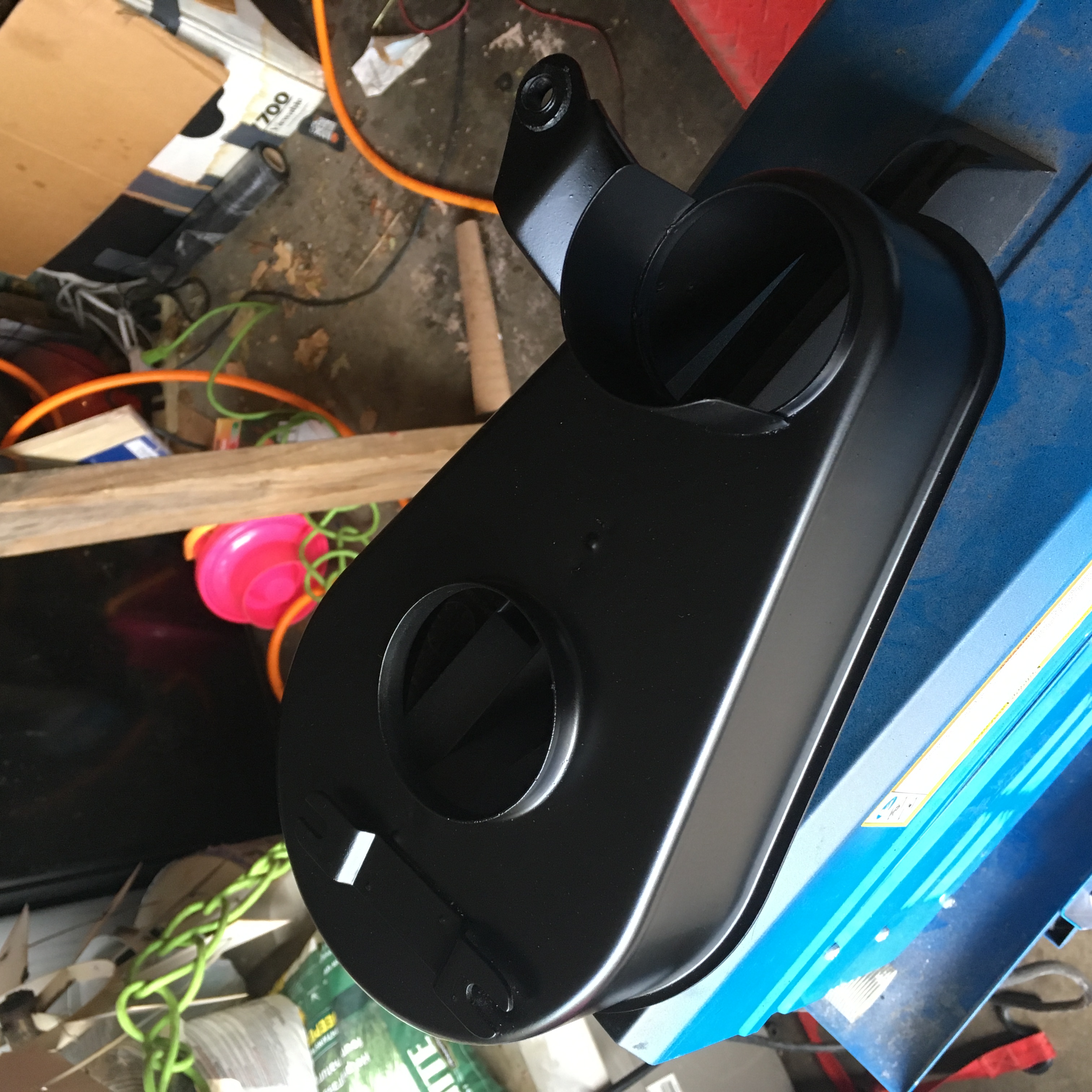

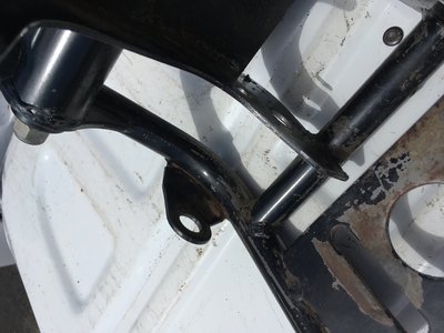

After painting the pipe, I pulled off the air box. I needed to weld the lower portion of the bracket which holds the screw to bolt on the covers. Then I sanded off the rust and lightly sanded the old paint to give it some tooth for repaint, and shot the air box black again inside and out. My welding still isn’t retail quality but I’m improving.

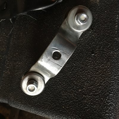

I removed the zinc bracket from the back of the air box before painting, and while the paint dried, I cleaned the bracket with a brass wire brush on my drill. I also replaced the old 6mm nuts & lock washers with new ones as they were rusted badly.

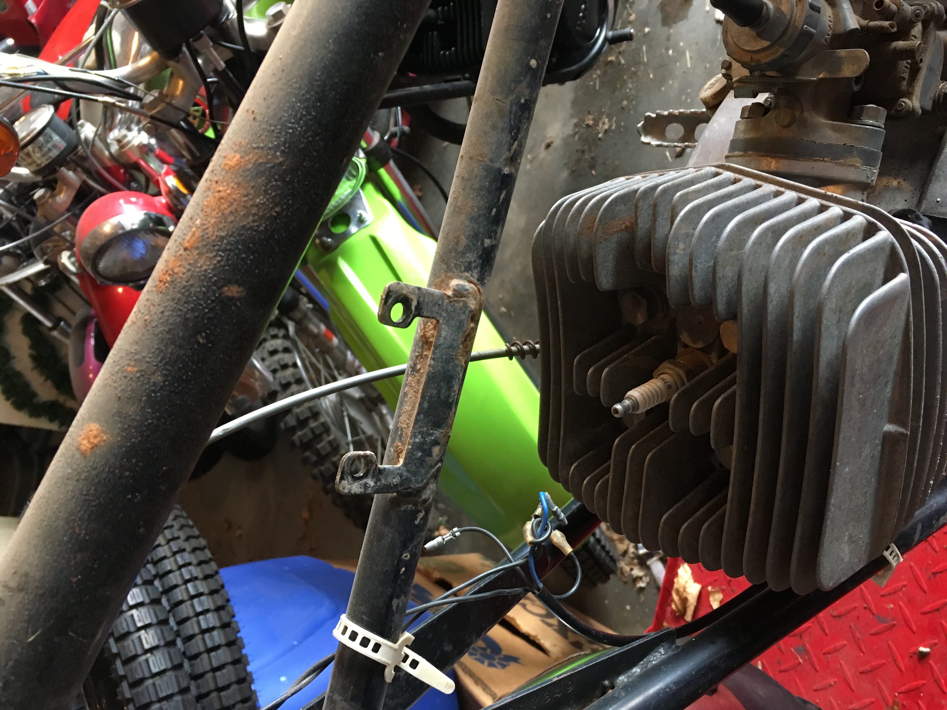

Pulled the seat & tank off today to find there was no coil under the tank. Now I’m really glad I bought 2 of those coils posted in the other thread about getting no spark!
Also found the left front tank bolt had its head twisted off. :ugeek: Victor

Looks like you got lucky with the tank bolt. I’ve had to deal with at least 3 of those that were broken off flush and well rushed in, not fun.
Re: Victors Combat Wombat Thread!
Could have been too long and hit bottom, good and snug not super tight. -----Clarence
Yep. I did have to lock a pair of needle nose vice grips on it to start it turning. Then my screw extractors pulled it out easily. :ugeek: Victor

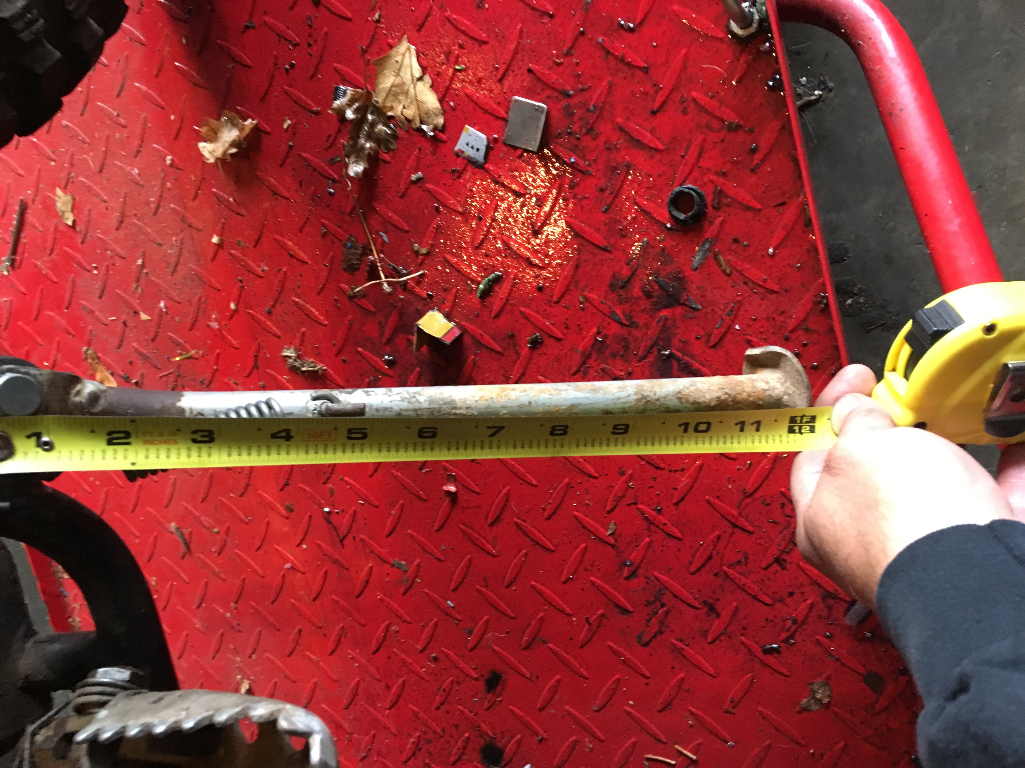

BTW. Is this the correct kickstand for a Combat Wombat? It seems very short. Even if I straighten it out it doesn’t seem to be the correct length to me. How long is an OEM CW kickstand? This one, IF it was straight, would be 12” long.

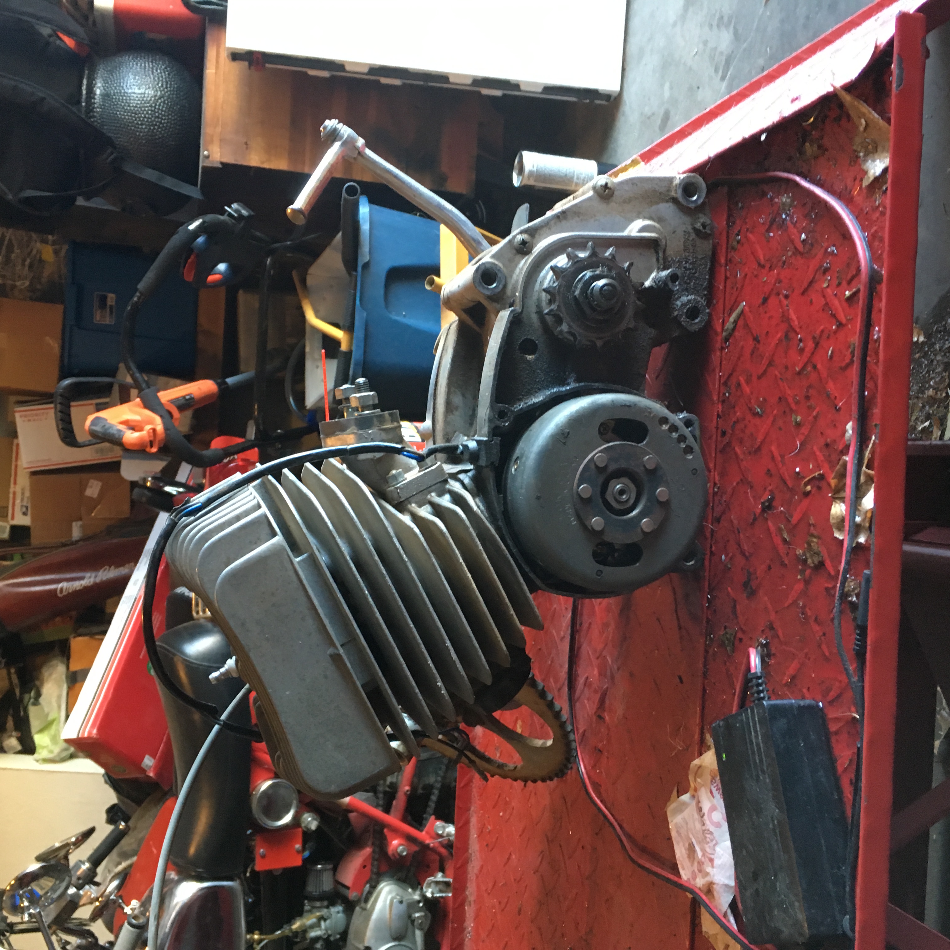

Motor out!!!

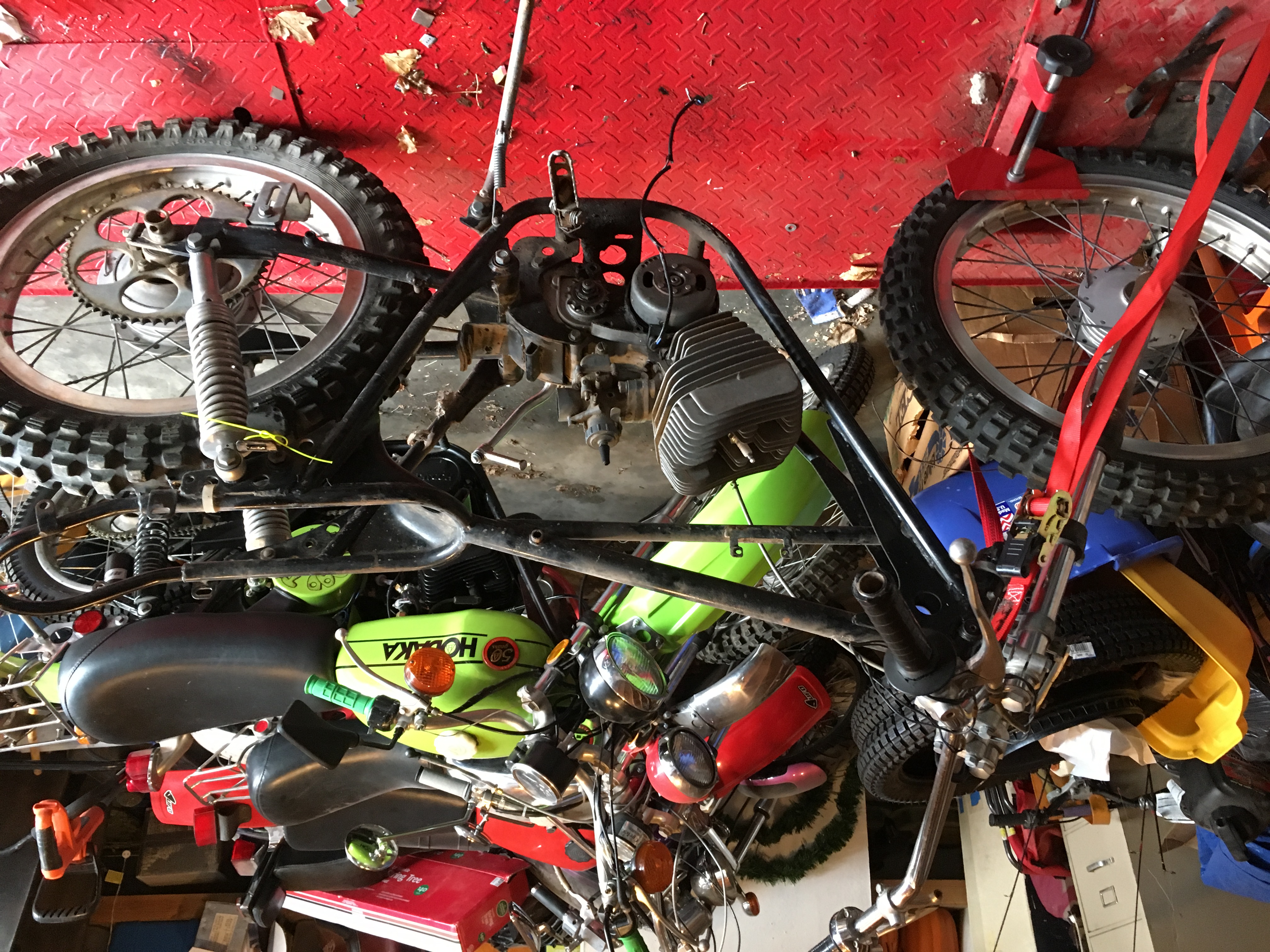

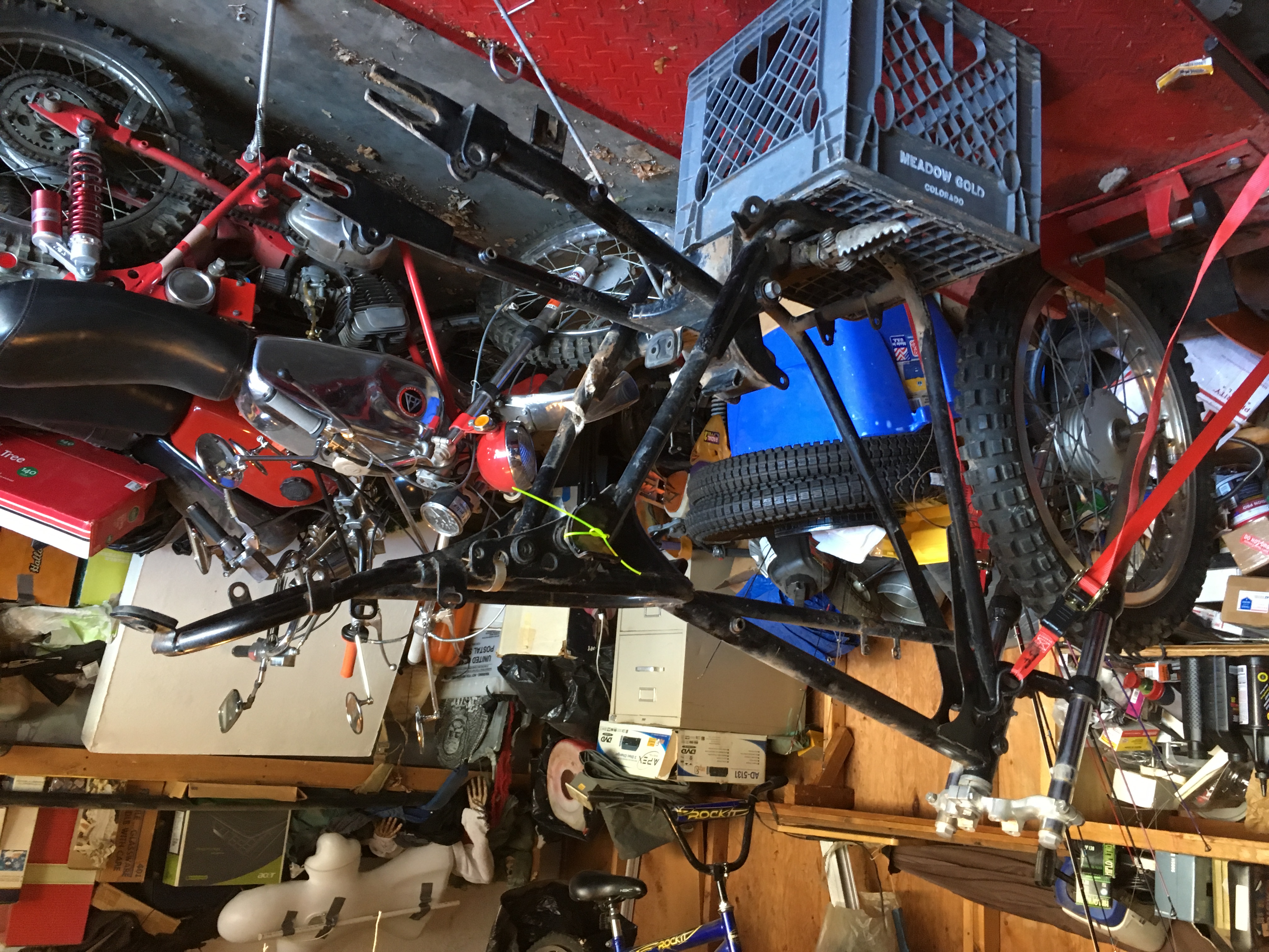

Front end comes apart next. Then the frame gets pressure washed and rust removed. :ugeek: Victor

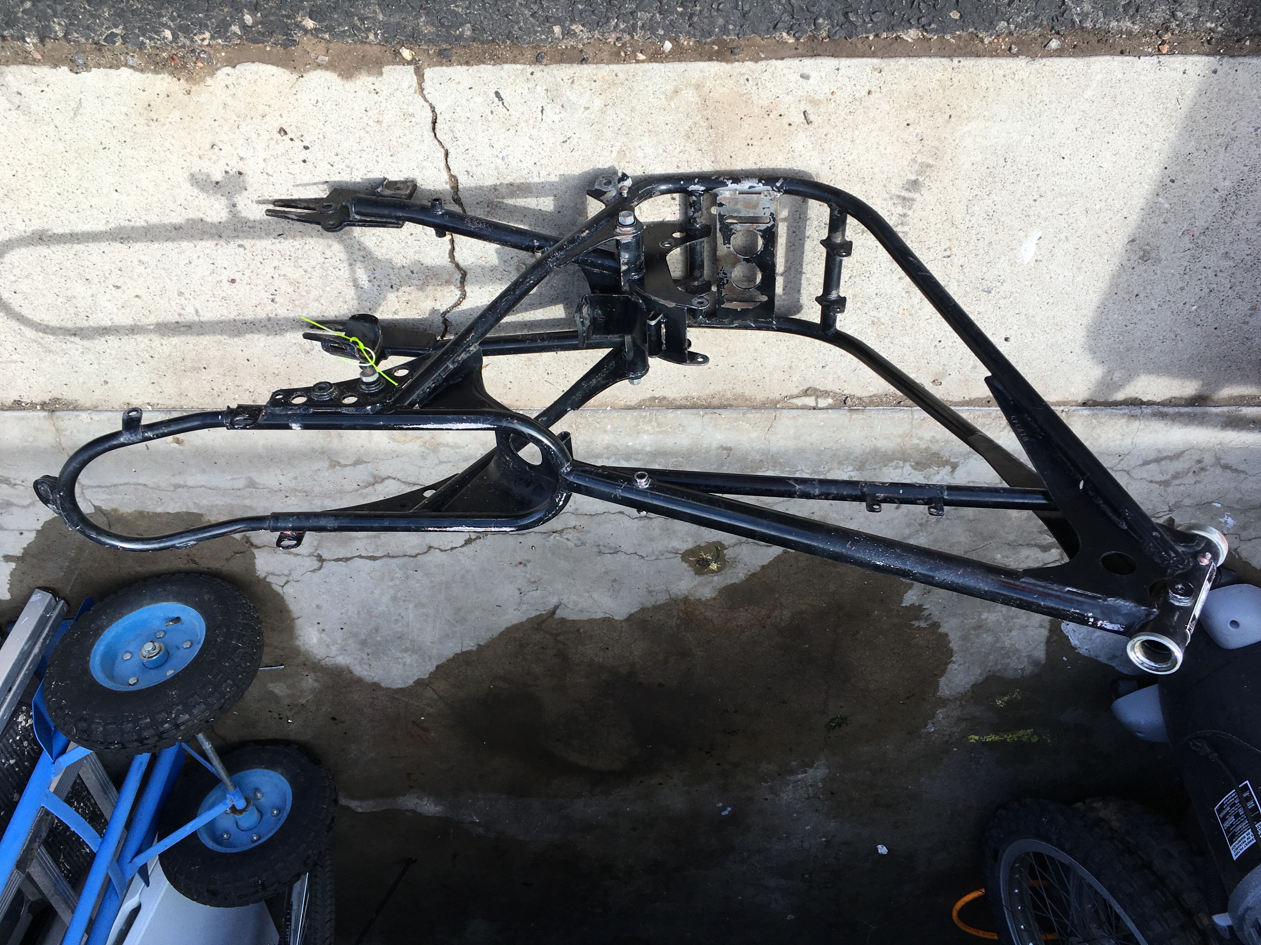

Everything is off. Down to the frame w/ swing arm and the brake pedal, & the foot peg bar. Tomorrow she gets pressure washed to get rid of the dirt, grime & oil!
Need to clean it to see how the brake pedal comes off. If someone wants to tell me how to remove the rear pedal, that would be cool! It’s getting dark, so cleaning happens tomorrow!

As to the kickstand length, I've worked on a couple of different models that I've stuck a 2x4 under the stand to get it to sit more upright. So if it seems short I'd say it's normal.
Well it’s got about a 30* bend in the top as well. I’m going to heat it up with a torch and see if I can straighten it back out. :ugeek: Victor

I worked part time at a local Hodaka dealership back in the day. There were no Hodakas in the showroom that had 2X4's under the kickstand. 2X4's are not "normal". Something is bent, worn or mismatched.

When folded up it should be close to the frame. On mushy ground a 1" block of wood is a good deal as is a 2x4 on a side hill. -------------- Clarence

Vic,the side stand on my CW is13 1/4" long, 12 3/4" center of bolt hole to end of stand. There is about a 20 degree angle in the mounting bracket at the top of the stand,but the shaft itself is straight.

I’ve now cleaned and removed the rust with Naval Jelly. Next step is sanding it smooth and a coat of primer followed by a couple of coats of satin black. :ugeek: Victor

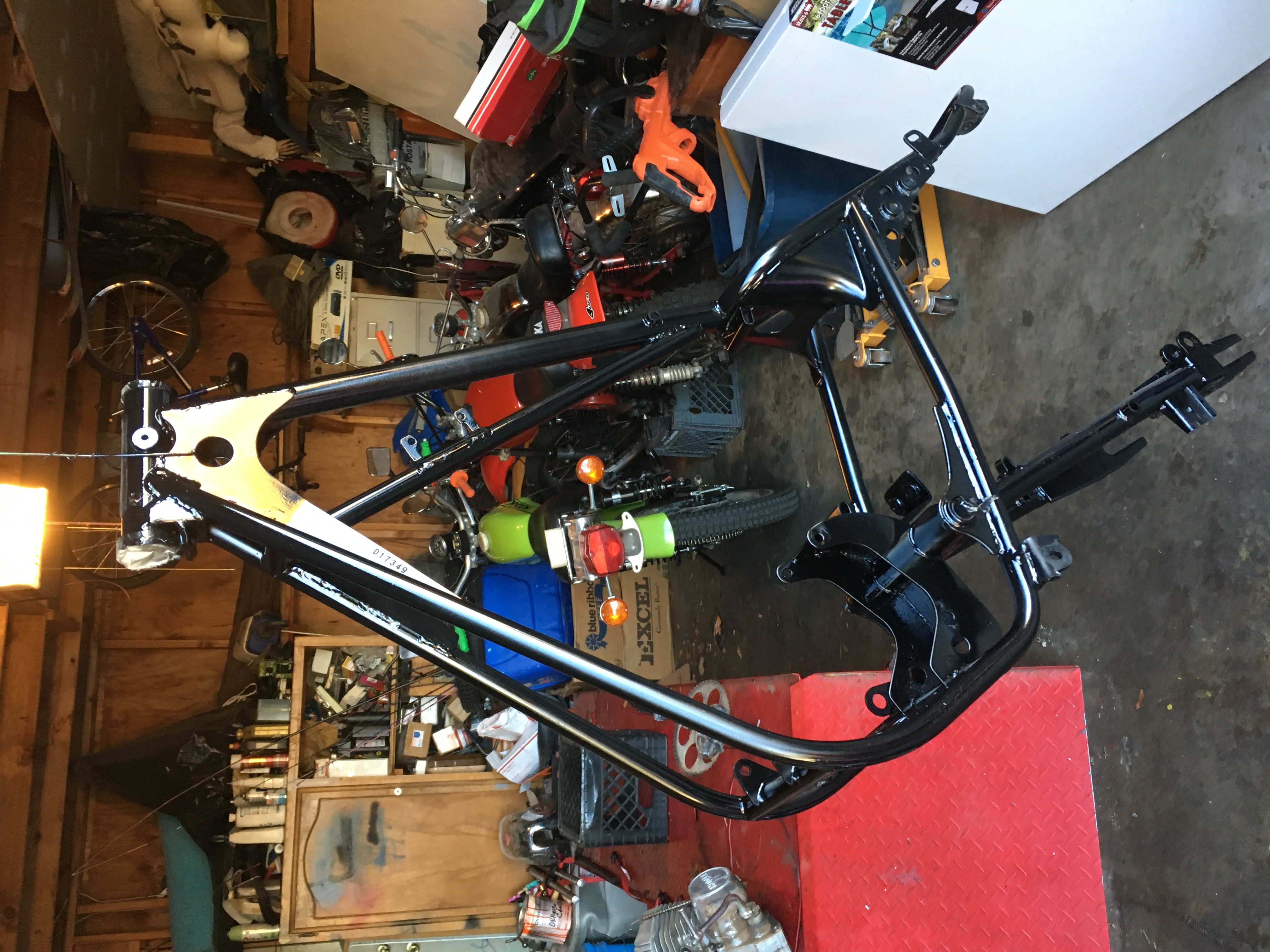

Well, I finished sanding & got the first coat of satin black on the frame. I contemplated drilling out the VIN tag rivets, but decided to just tape it instead.
But she’s coming along, slowly but surely. I think I put in 2 hours of hand sanding on this frame.
And this time I tried the Rustoleum Satin Black paint & primer in one. It was only a dollar more than the regular Rustoleum, so I’m hoping it looks as good. Building it up in 2 coats, slowly. :ugeek: Victor
