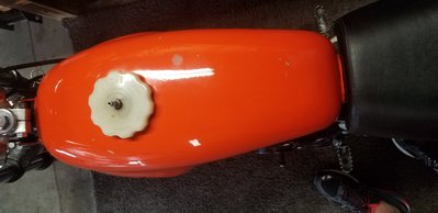

Should I leave the tank alone. It has very few chips or blemishes.

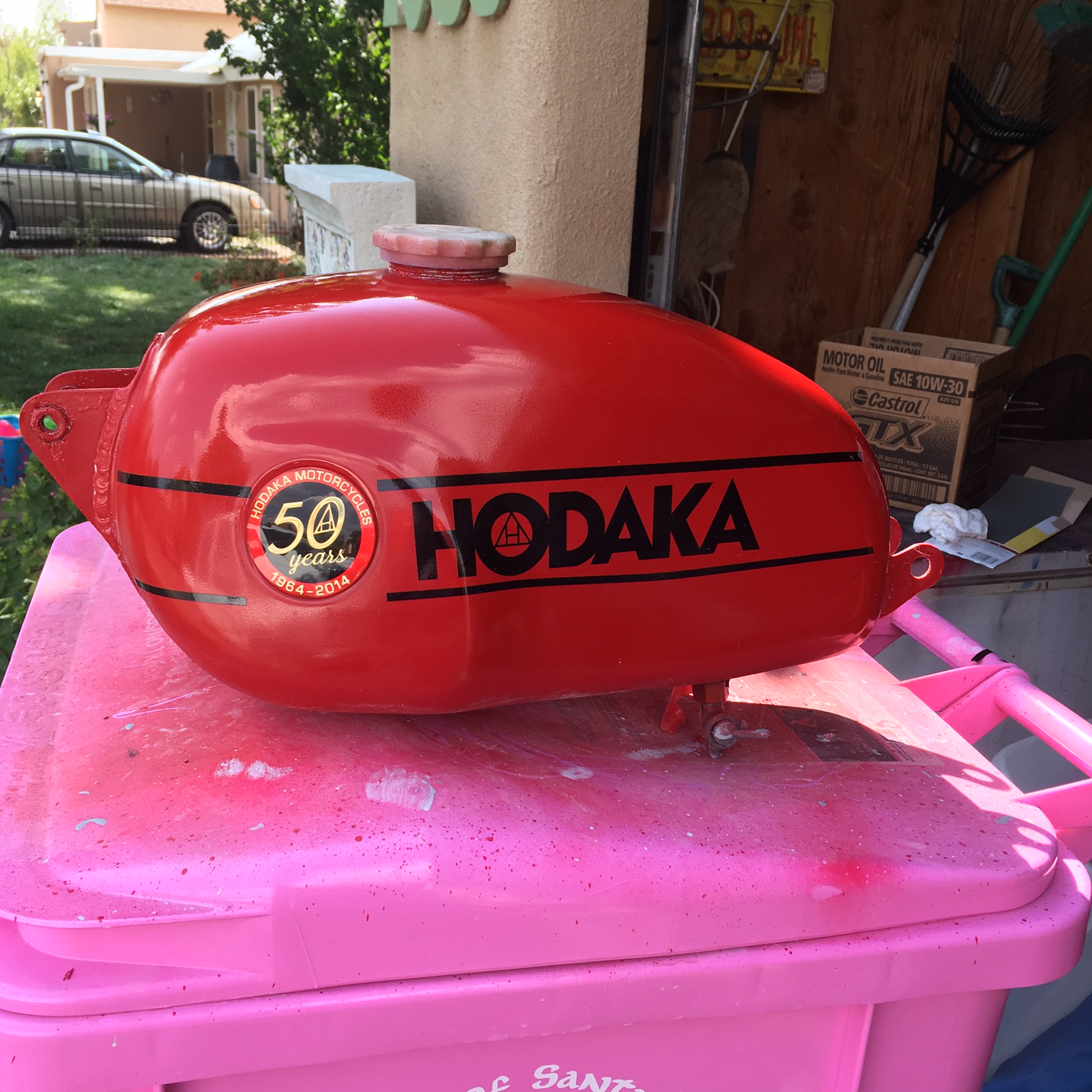

Re: Paint color recommendations
If you want to do the tank again, I recommend a stripper for easy removal. Then a self etching primer and whatever color you choose. I did my Red Toad with “touch up” paint from O’Riley’s Auto Parts. I used the Chevy “Victory Red.” Nephew didn’t like the Toad Green, and asked for red. Told him it was his bike & it could be any color he wanted. Also used the automotive clear coat from the same brand & buffed it with 3M Buffing compound, to get that finished “Wet Look!” :ugeek: Victor

That looks pretty darn good! I really want to preserve any original I can. I think the tank will be a game time decision lol. I'll get frame, motor done and go from there. Thanks for all the tips though if I decide to try it myself, great info!
