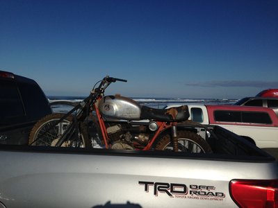

Drove from Olympia, Washington to Lincoln City, Oregon to get this today. Spent more on gas than I did for the bike. Temperature in Olympia at 5:30am when we left was 14 degrees with about 12” of snow on the ground. Arrived in Lincoln City at 9:30 to find sunshine and 41 degrees on the beautiful Oregon Coast. Heavy blowing snow for the last 60 miles on the way home but we made it fine.
Anyway about the bike. The Craig’s List said “1972 Ace 90” called the owner and he didn’t know much about the bike. I decided to go ahead and make the trek and have a look. Made the deal and loaded it up.

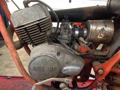

Engine No. P-11011. ???
The engine is a 90cc but what what it came from I don’t know..
Does anyone recognize the pipe? Looks a lot like a Torque Engineering pipe I had on an old Yamaha DT 250.

Treasure. I think the pipe is a T.E. Whispering Smith. Cool performance upgrade and pretty quiet compared to the "Competition Only" line which will effectively remove the fillings of anyone within 50 feet of the outlet. Great score!

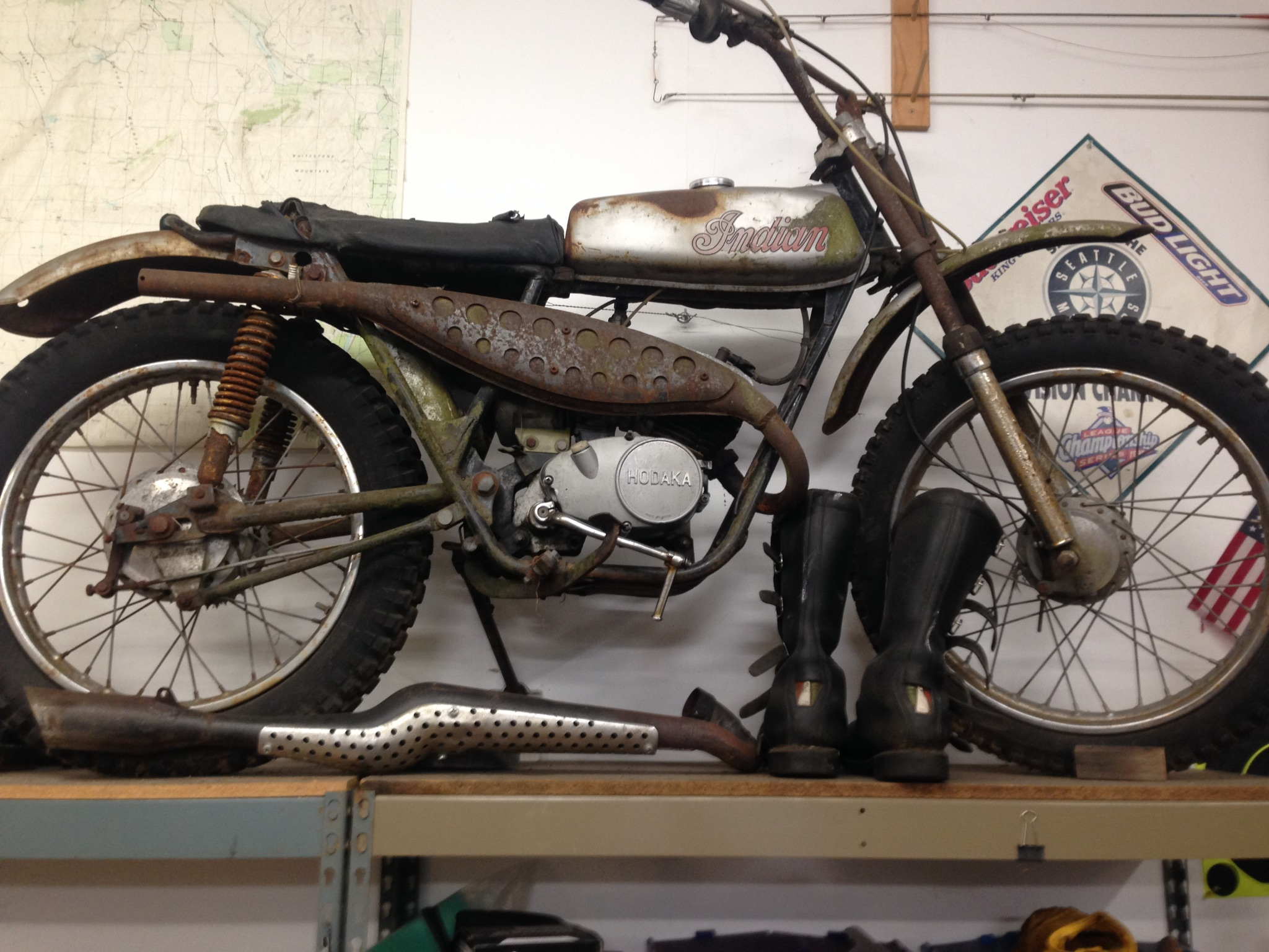

I have this 100 “E” motor in the little Indian. It needs a complete overhaul but might be worthwhile. I have a trade worked out for the rest of the Indian.

Your pipe is a Torque Engineering. Here's a picture of one I have, the remnants of the Torque sticker still in place. The other pipe in the pic is a Bassani, for reference. Nice find!

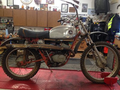

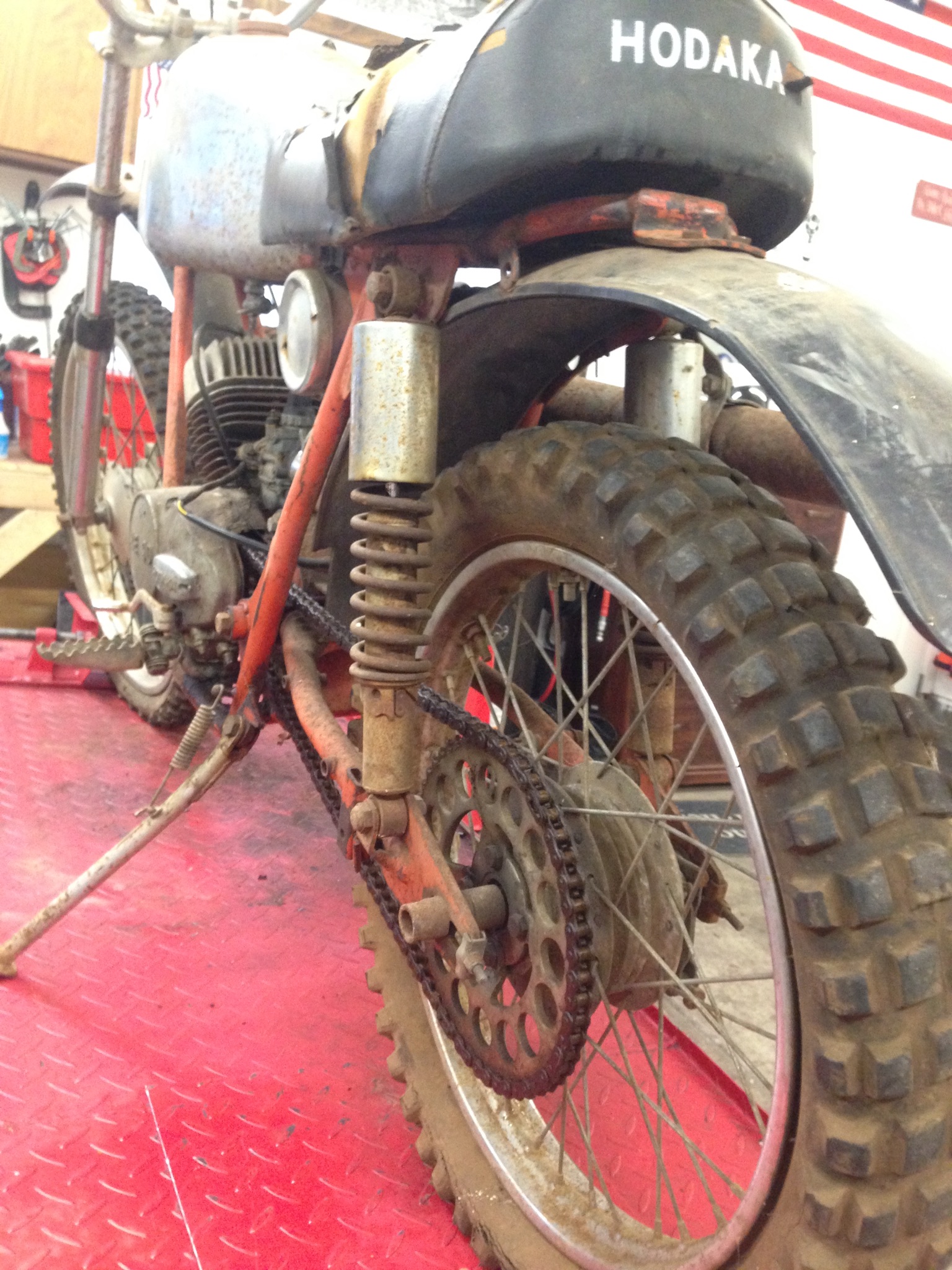

Well it’s been a few days since I picked up the little Rat and since we have been pretty much snow bound I have had lots of time to get acquainted with the Rat. What I’m finding is that a lot is not original. Obviously the 90cc motor. Has a 21” front wheel, rear wheel is the older 4 bolt non cushion type. Shocks are not original but seem to work ok. Stock air box is missing. The tank is correct, chrome is in rough shape but the inside is nice. The fork tubes are badly pitted and not usable.
So I have decided to make a rider out of it. Rebuild the 100 “E” motor. I already have a correct rear wheel. Use the Ace 100 pipe that can be seen in the picture of the little Indian. I have an extra set of 94 Wombat forks that are in decent shape that look like they will work.

Off to a good start. Got this done this morning. Surprisingly beneath the crusty exterior it’s in good condition. No broken bolts. Everything greased as it should be.
Next I will compile a list, two actually, one for parts needed to make a rider and another “wish list” for parts to make it correct.

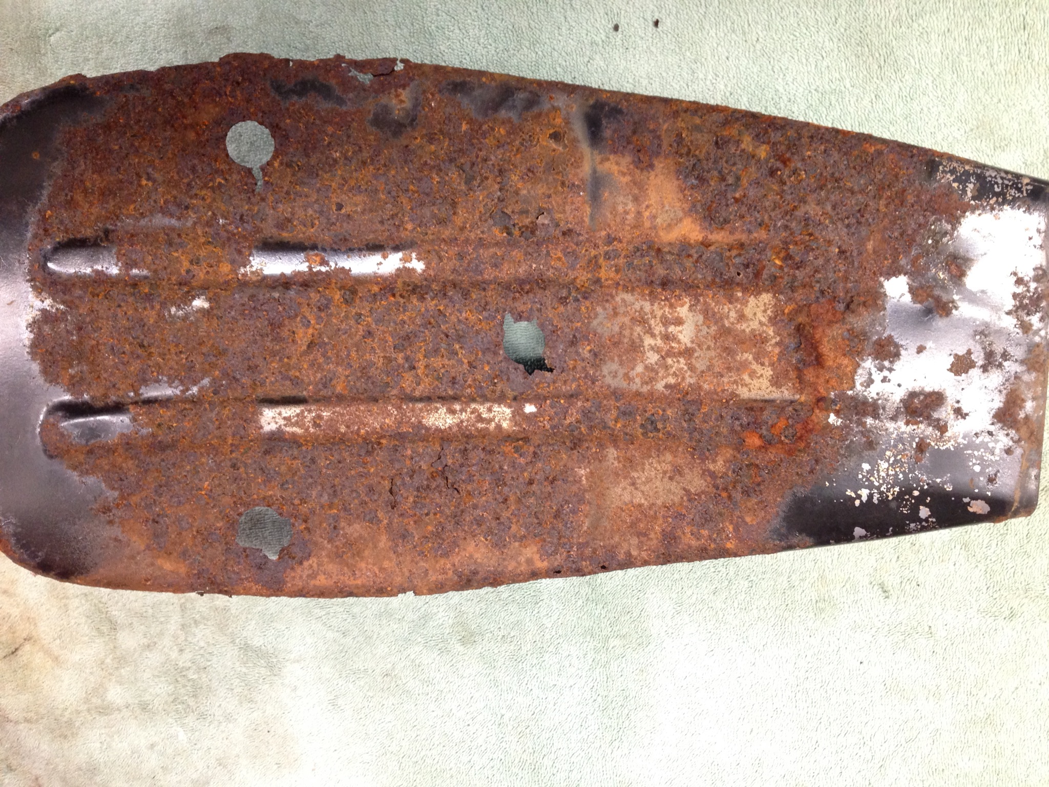

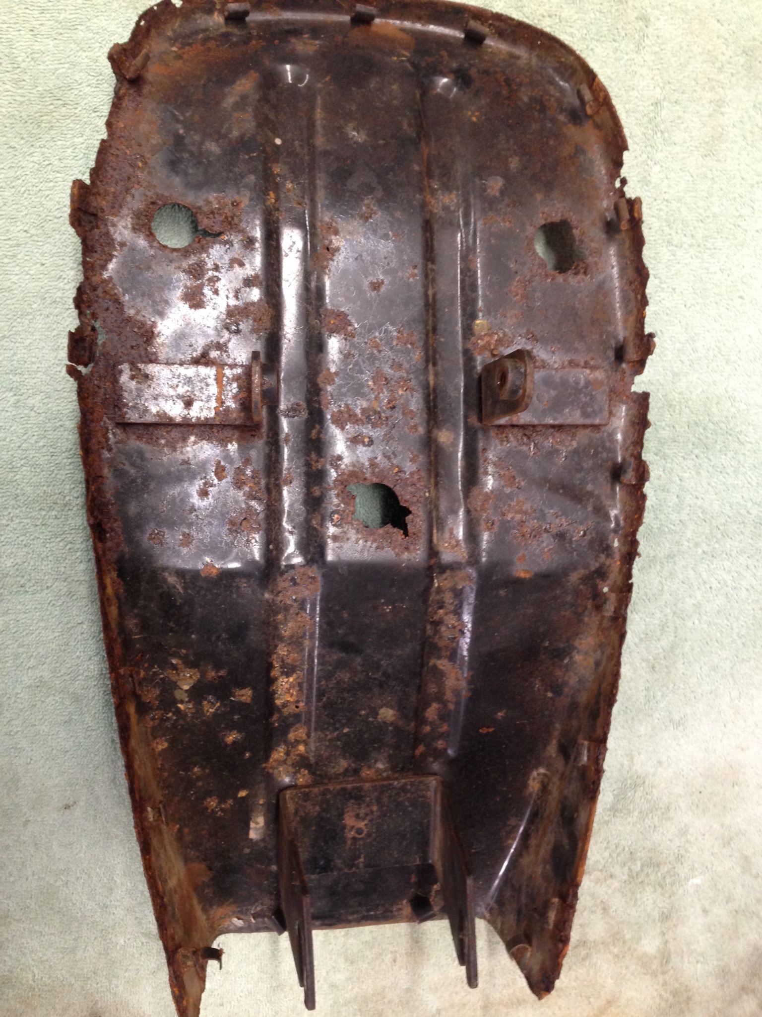

Examined the seat today. Not much metal left here. Beyond repair at least for my skills and tools. The recent postings on seat pans was very helpful. The search is on. HPI shows not on stock. I sent Terry an email request.

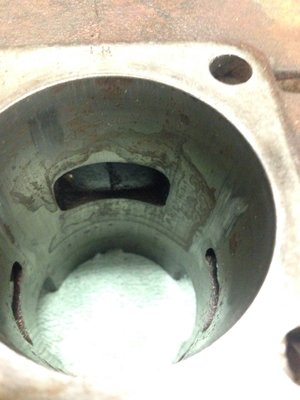

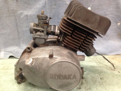

Meanwhile I tried to get the “E” motor apart to see what I have. Could not get the cylinder off. It was frozen when I got it last summer. At that time I pulled the head and filled the cylinder with marvel oil. After about an hour of applying heat and brute strength I could not get it to budge.
I called a friend of mine for advice and his advice was “come over and get the motor I have in the attic”
It is a “P” motor with a 93 top end and carburetor.

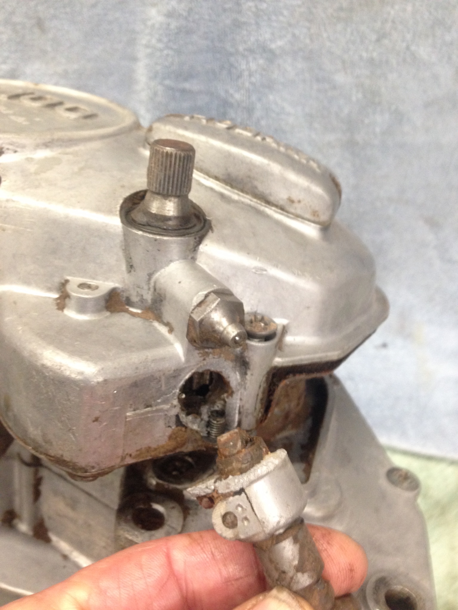

The shifter plunger had been broken off in shipping. I have a good shifter case left over from another project.
Significant up and down play in the rod at the crankshaft. Someone with a big wrench got carried away on the carburetor. The studs are bent and carburetor flange is visibly bent.
It has a .040 piston in it and looks to be in need of a bore job. Looking on HPI the largest piston they offer is a .040. What are my options here? Can this be bored bigger? Are bigger pistons available? I would like to use this motor if I can.
Re: Picked this up today
The intake manifold should be useable with new studs. It gets that way when someone tried to use a bigger carb than the studs are spaced for, a fairly common issue. I don't think the manifold is bent.
