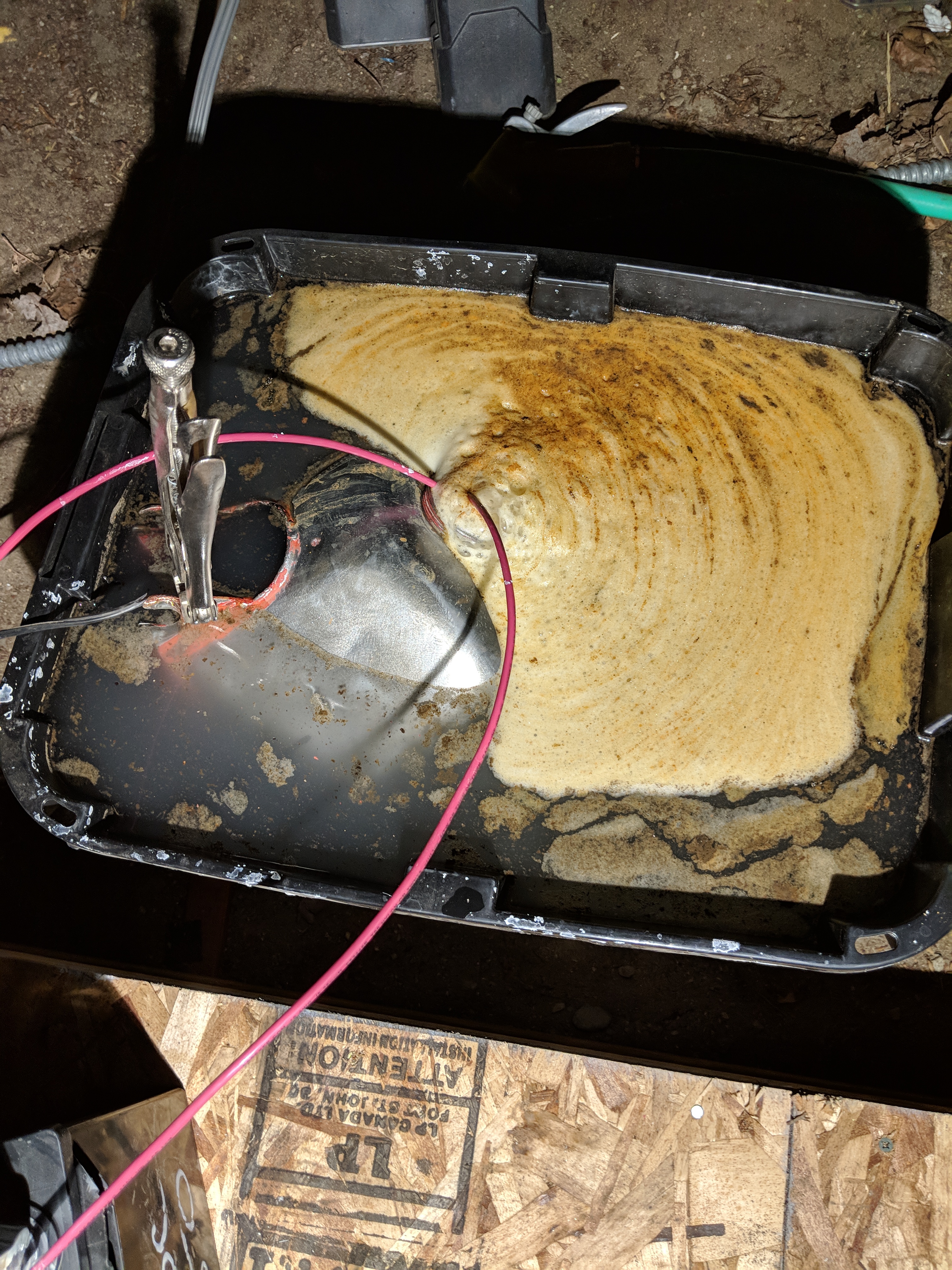

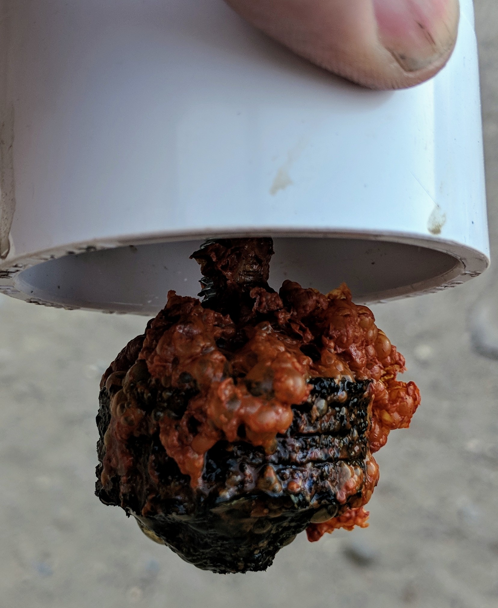

Thanks Gary Bashor for the tip. I used 1/2 cup washing soda on a full tank of water. Used a power wheels charger with negative on petcock and positive on 3/8 bolt set in a 2" pvc cap. Washers on bottom of bolt hanging in solution. This is after 4 hours.

It does give off hydrogen gas. So you need a well ventilated area. Also care must be taken to not cause any sparks.
I was impressed with the first test so of course the to scale up. I used 2 giant nails and a 20 amps charger. Left running overnight.
