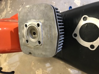

When I bolt up and torque the head with a new gaskets I get almost 0 compression. I put my Palm over the piston and crank it , the compression will blow my hand off the cylinder. My head has a indent that makes me think the gasket should have a similar indent to match the head but the 2 new gaskets I've ordered are flat . I'm sooo lost on this.

And can you post a pic of the indent?

I'm with Thrownchain, the mention of an indent in the cylinder head immediately caused a red flag to pop up. We need more information on this indent.
Re: 97 head gasket - no compression
This 97 came to me as a real basket case with mixed parts, but I'm so close to finished

If the indent you are referring to is the ring around the combustion chamber on the cylinder head, no, there is no special head gasket that mates with this ring. All Hodaka 125s use the same aluminum gasket.

Ok, I painted the head gasket area with a marker and set it on some 600 sand paper on a piece of glass. Polished the head and it came out as good as it can get I think. Then I doubled up on the head bolt washers already in case the studs bottomed out. I'll try the soapy trick.
