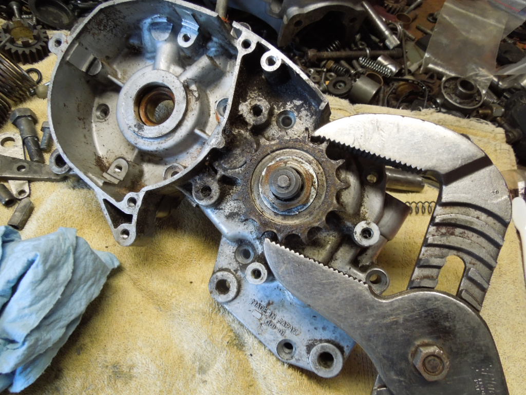

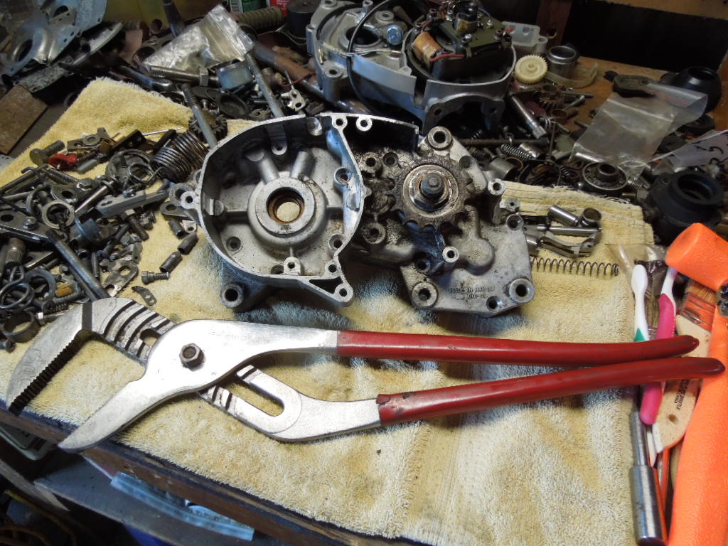

Had a little free time today and thought I would offer my solution to this concern. I bought this very large channellock style pliers many years ago. Big pliers are like big hammers....handy when used appropriately. I have used this method when assembling engines on the bench with no damage or difficulty. Fairly sure could be used with engine in frame also.
Pliers are positioned to get a good grip on the gear. Gear teeth are hard enough to not sustain damage if gripped securely and not allowed to slip when tightening nut. This is an 03 Wombat case half and other models may require gripping gear a little differently.

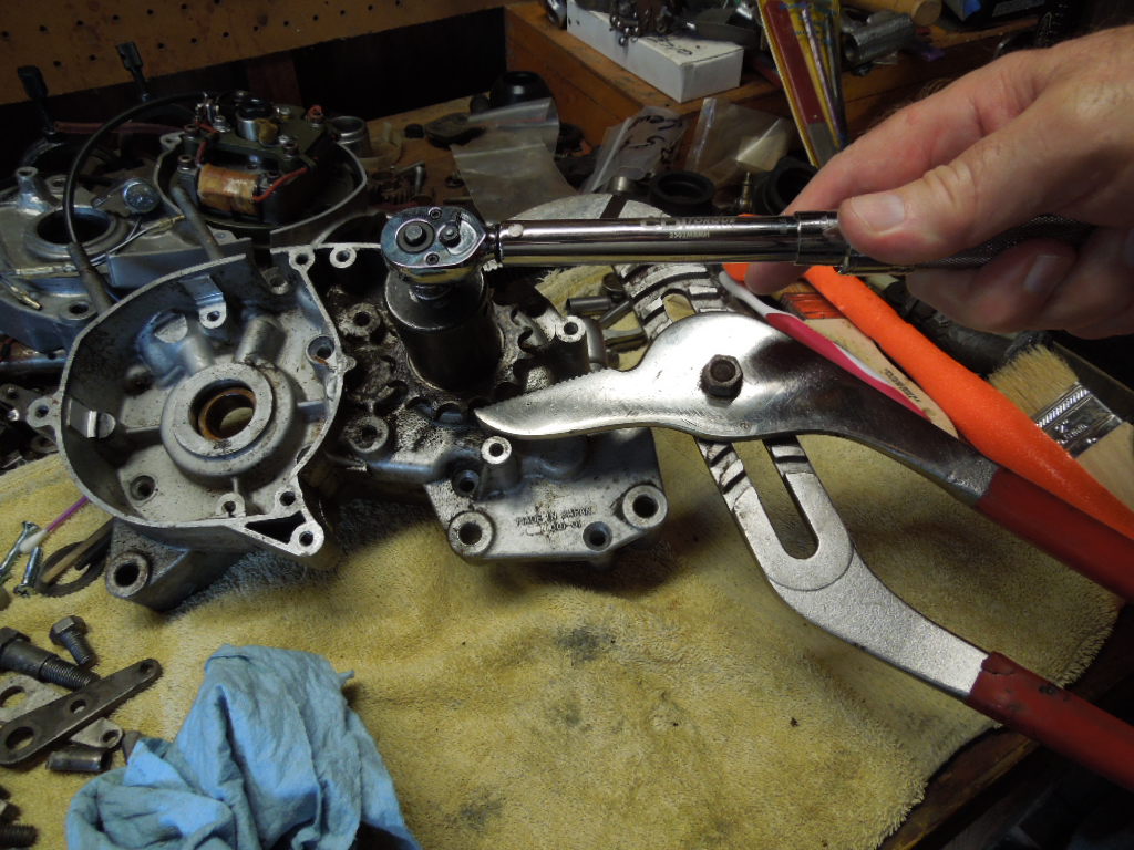

Pliers adjusted for one hand operation and held in left hand. Assuming you are right handed.
Torque wrench held in right hand and nut torqued to 250 inch pounds. Feels right and never any damage to nut or counter shaft. Just as a frame of reference the clutch nut torque spec is 250 inch pounds and that shaft is tiny compared the counter shaft.

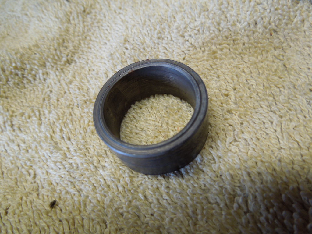

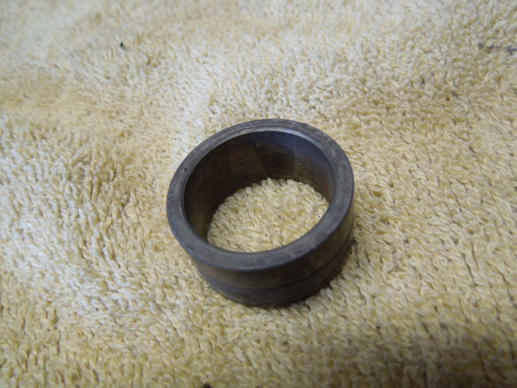

Spacer is usually in this condition when removed from an engine with a few miles on it. One end flat / undamaged and the other side as pictured.
The ridge needs to be removed by lapping on a flat surface with sand paper assuming the seal surface is in good condition and the ridge height is not too tall.
