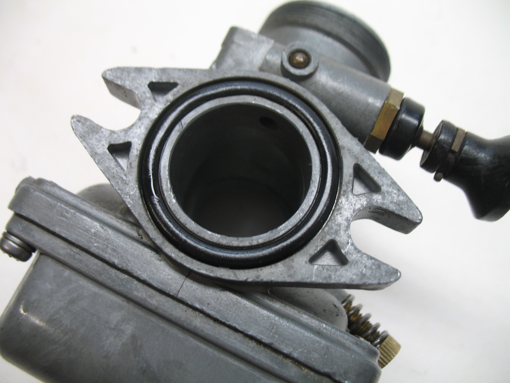

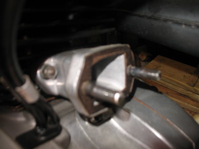

Hey fellas, here is a pic of the reed valve manifold minus the reeds. It has the 40mm spacing where it mounts to the cylinder and measures 49mm where the carb mounts. The carb pictured has an inside diameter of 24mm, so I'm assuming it's a 24mm Mikuni if I'm measuring correctly.

Al Harpster
Posts: 308
Re: VM20 Ace Carb
Post by Al Harpster »
The two bolt Reed valve unit is a valuable item, if you have the Reed cage that goes with it.
The 24 mm carb if it's complete is also valuable.
I would use both.
If you don't have the Reed cage that goes with the 2 bolt manifold, that's a problem. But if you do have it
1 keep it
2 use it.
3 put a clamp on foam air cleaner on the 24mm carb & go.
Is this what you have on hand?
