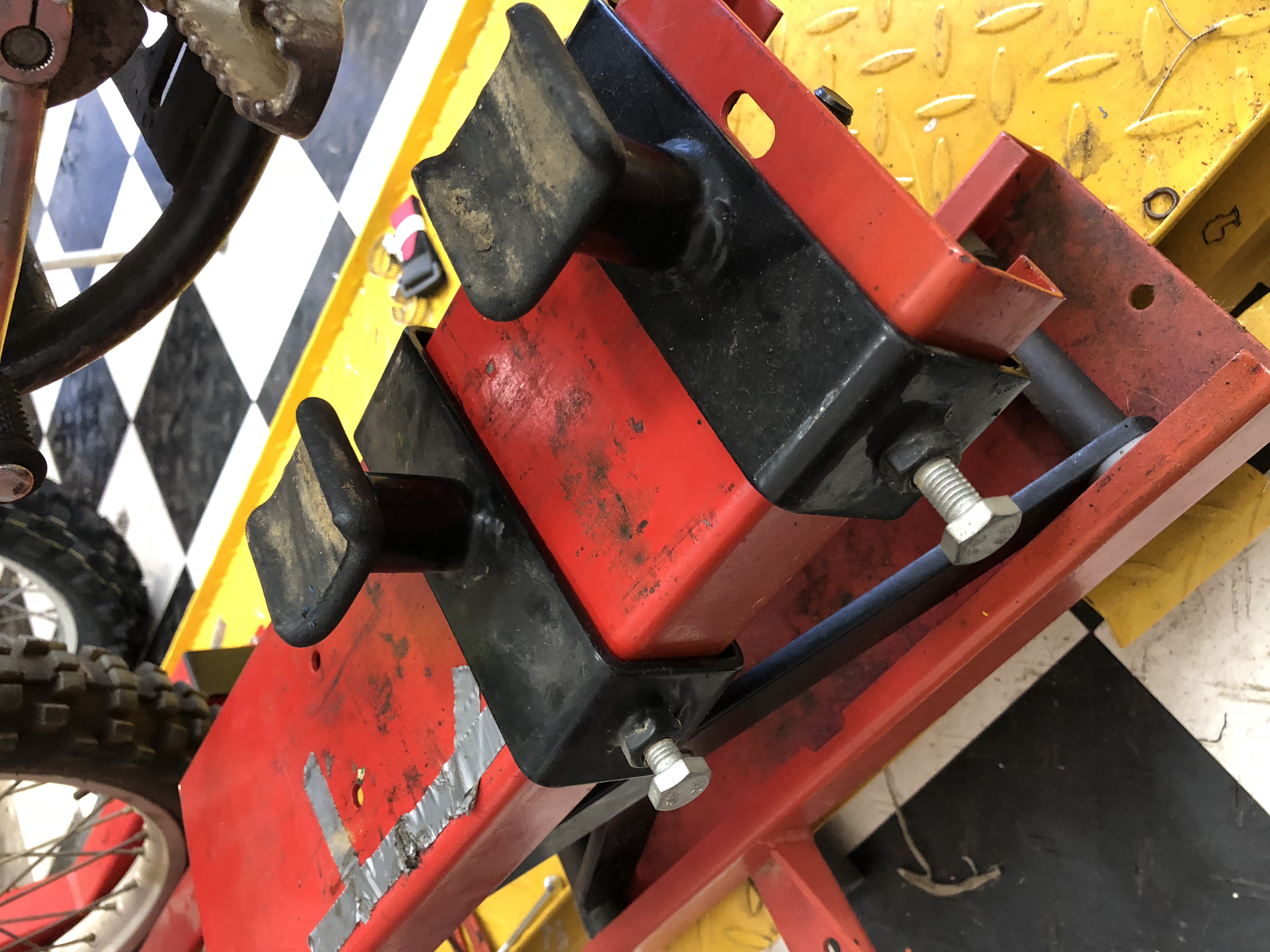

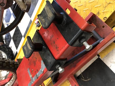

I have a small table lift that works well. It has clamps on both side that anchor the footpegs so it doesn't fall off. I can do total disassembly or assembly on the lift. Pit Posse has them and there are others. Check ebay under motorcycle lifts.

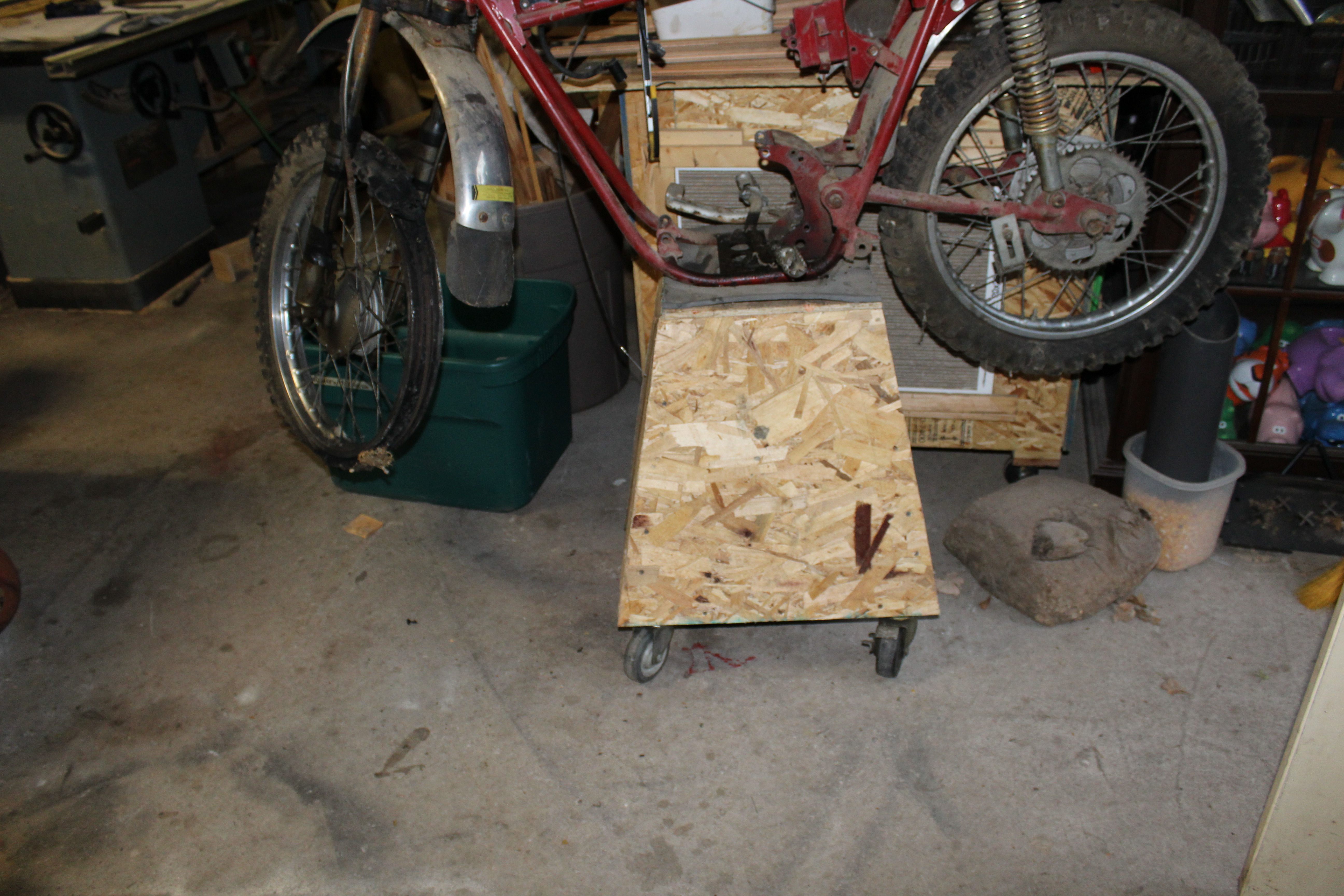

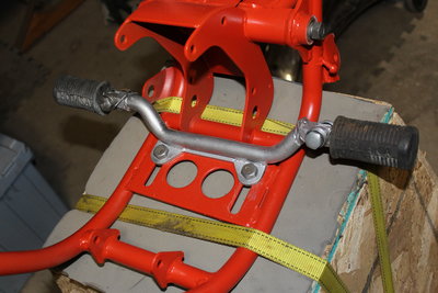

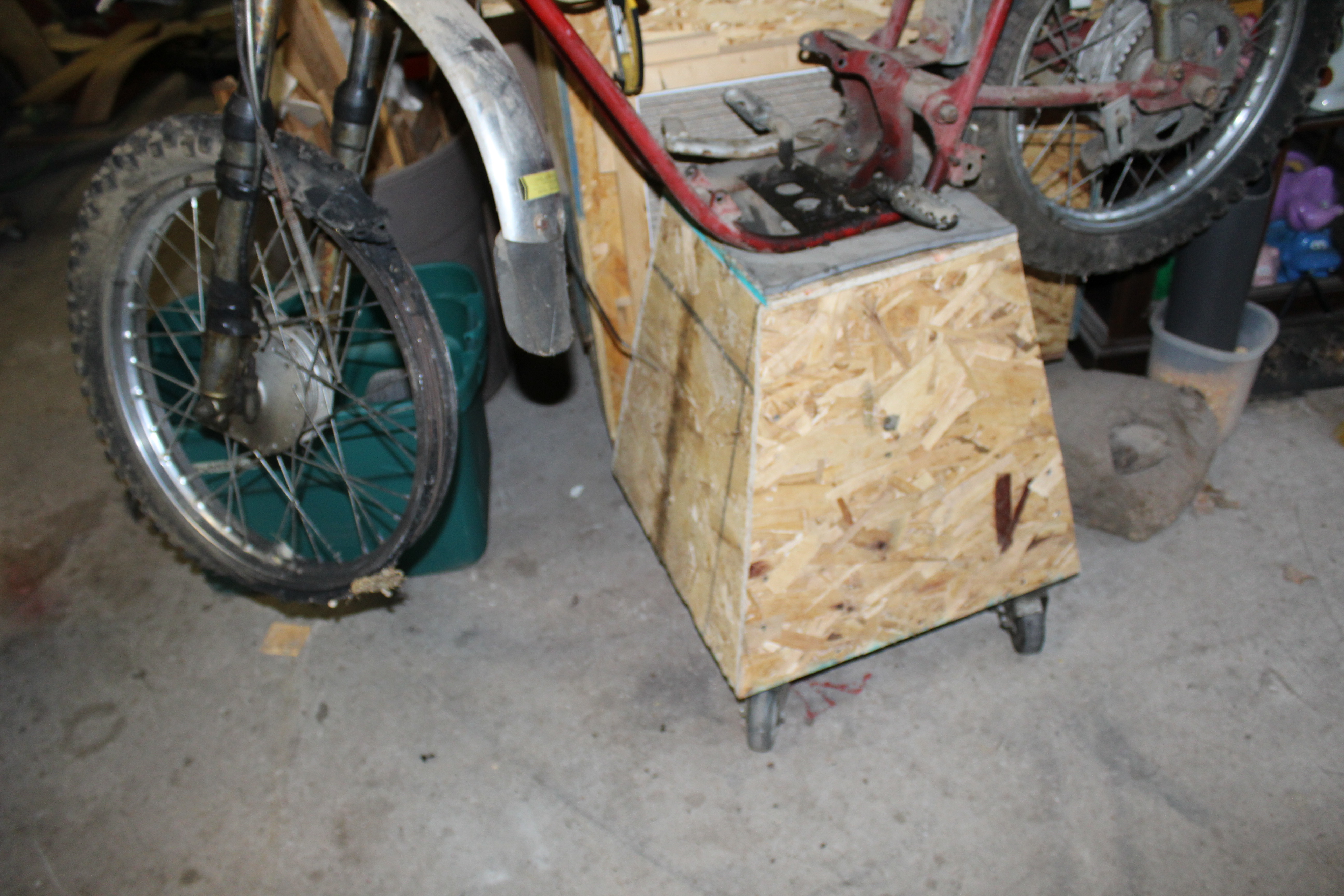

built this one from stuff around the garage. 12 inches on top, 21 inches on bottom, with wheels 26 inches high, padding on top for some protection, ratchet strap the frame down and its pretty sturdy. moves nice so you can spin it or move out of the way, always keep the side your working on facing the work bench. never came close to falling off...albert
