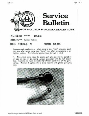

A bit of a long shot, but if you find secondary resistance to be "infinity" it may be the spark plug cap to high tension wire connection.
My Ace had this type of plug cap.
I don't use it anymore, but it does come apart. A
nd the "sharp tip" was in rather corroded.

Al that actually ended up being sort of the issue surprisingly. The spark plug wire broke at the tip so I just cut it off and moved the cap down alittle bit and got 5.1k ohms in the secondary. Still no spark from the Champion J4C spark plug though...now at the next hurdle :roll:

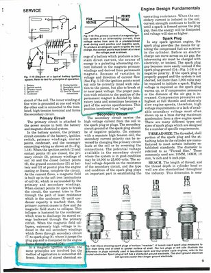

This article may be of help, maybe not. Magnetos are pretty simple things. If you have components in good order this is how it's supposed to work. Maybe there's something here that will shine a light on the trouble.
