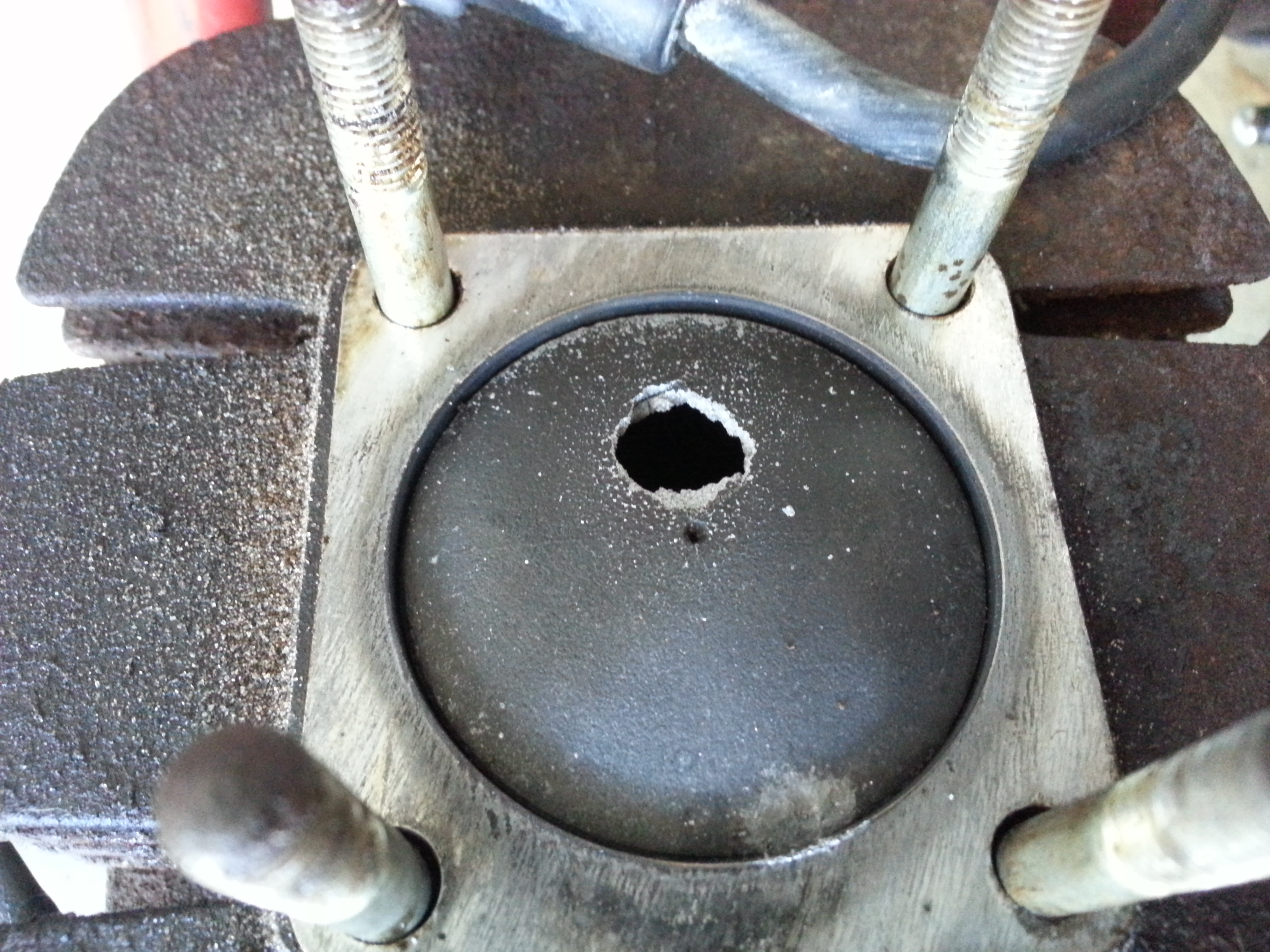

So I started this thread because of what happened to my original motor and after reading and learning from this thread I think I may have initially jumped to a few conclusions. I originally used "Bean oil" with this motor because I was also riding a kx250 air cooled 2 stroke and I thought the smell was cool. Stupid! As most people now know that oil is not awesome and specifically does not store well. I used some old mixed fuel that had been in my garage for about a year and I believe that is why my piston seized. After I fixed that I rode it with pretty much lawn grade 2stroke oil (walmart) for about 20 hours and I burned a hole in the piston. Truthfully it was running better than ever so I assumed that I had leaned it out too much. What I am thinking now is that I was getting pre-ignition (bad timing) and that is why the piston burned through. I think I need to stop worrying about the mix, just go with a safe 32:1 with Yamalube 2R and focus on jetting and timing. Sound about right Gents?
