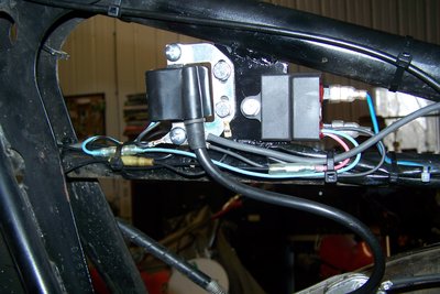

Looks like my CW will be much more reliable now that a PVL has been installed on it while at its winter home at the Super Secret Hodaka Research and Meditation Center in Western PA.

Hey Rich, The PVL is a really neat ignition system. Make sure you have a separate ground wire going from the frame to the coil. I have also seen others install a ground wire from the cylinder inlet stud to the frame under the tank. Good insurance.

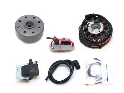

Powerdynamo makes a great product includes 12 volt lighting and CDI

PVL does not support lighting, PowerDynamo does. I've wired three PowerDynamo systems for lights. Rated at 12v and 80w or 100W output, (depending on which version you use), allows you to easily run those 12v 55/65W H4 bulbs that you can pick up at any auto parts store.
