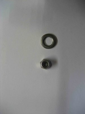

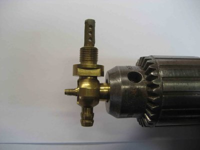

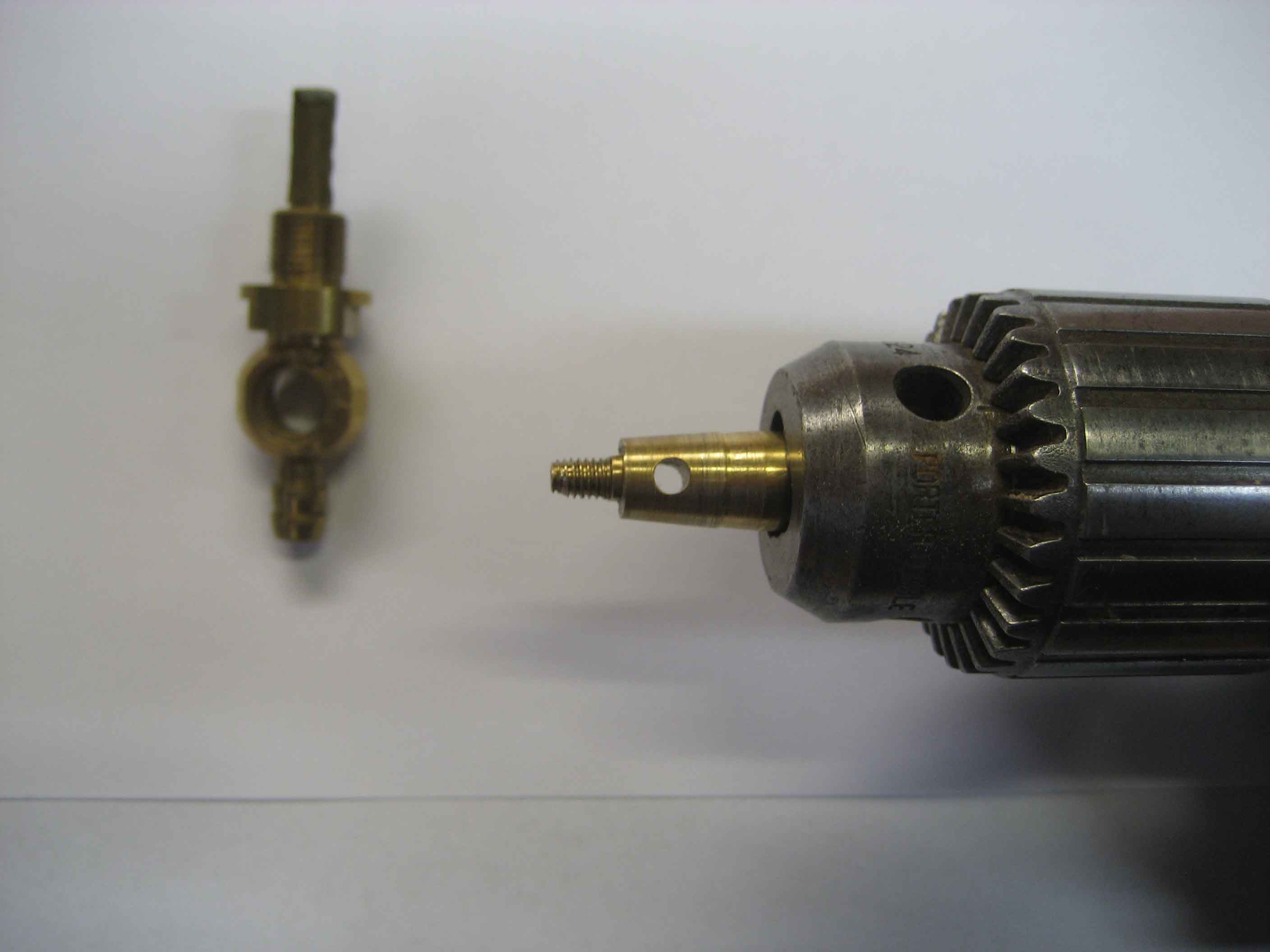

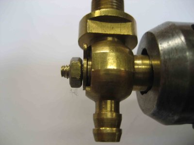

I had success lapping the original aftermarket brass petcocks from Strictly Hodaka. The new ones from Strictly have O rings in them.
This may or may not work with OEM petcocks.
Hand lapping did not work, even after several attempts.
I added power to the job with a variable speed drill, low RPM.
Mine required so much lapping the brass nut and washer would not tighten up the fit of the male and female surfaces.
The hole was lapped so much bigger and the taper so much smaller that the male taper section went in too far to get a fit to tighten.
This is where the washer and lock nut come in.
This is how I was able to get the taper snugged up.
Then I screwed the handle back in place.
I used various grades of the wax buffing compound sticks that I use with buffing wheels. Shave some off, mix with solvent, slather it on.
If you have lots of time on your hands, this process or perhaps some steps of this process may help.
Yes, I've got a lot of time on my hands. And I hate to loose.

Re: Fuel cox Lapping
Hand lapping did not stop the leaks.
I thought surface finish was important, and it probably is.
But with these aftermarket units the fit male taper to female taper was rather poor.
I sensed there was not only poor fit, but out of round condition.
As I turned these by hand I felt them bind up at say, three o'clock position, then free up at nine o'clock position
I could not remove enough material with hand rotation to get the leak to stop. Or stop the variations in binding up.
I think you can see the finish I achieved on the male part in the photo.
Not great by any means, but it does seal.
The drill set up allowed me to lap til the cows came home. No finger or wrist wear on me. All cutting on the mating parts.
It took a bit of time, but I wasn't willing to give up. I just got tired of trying to remove enough material by hand driven lapping.
