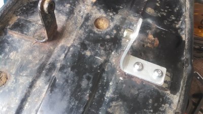

I was able to repair my Ace 100 seat using 1/8" x 1" aluminum and metric rivnuts. Drilled and tapped the pan 1/4-20 and used button heat socket heat screws.
