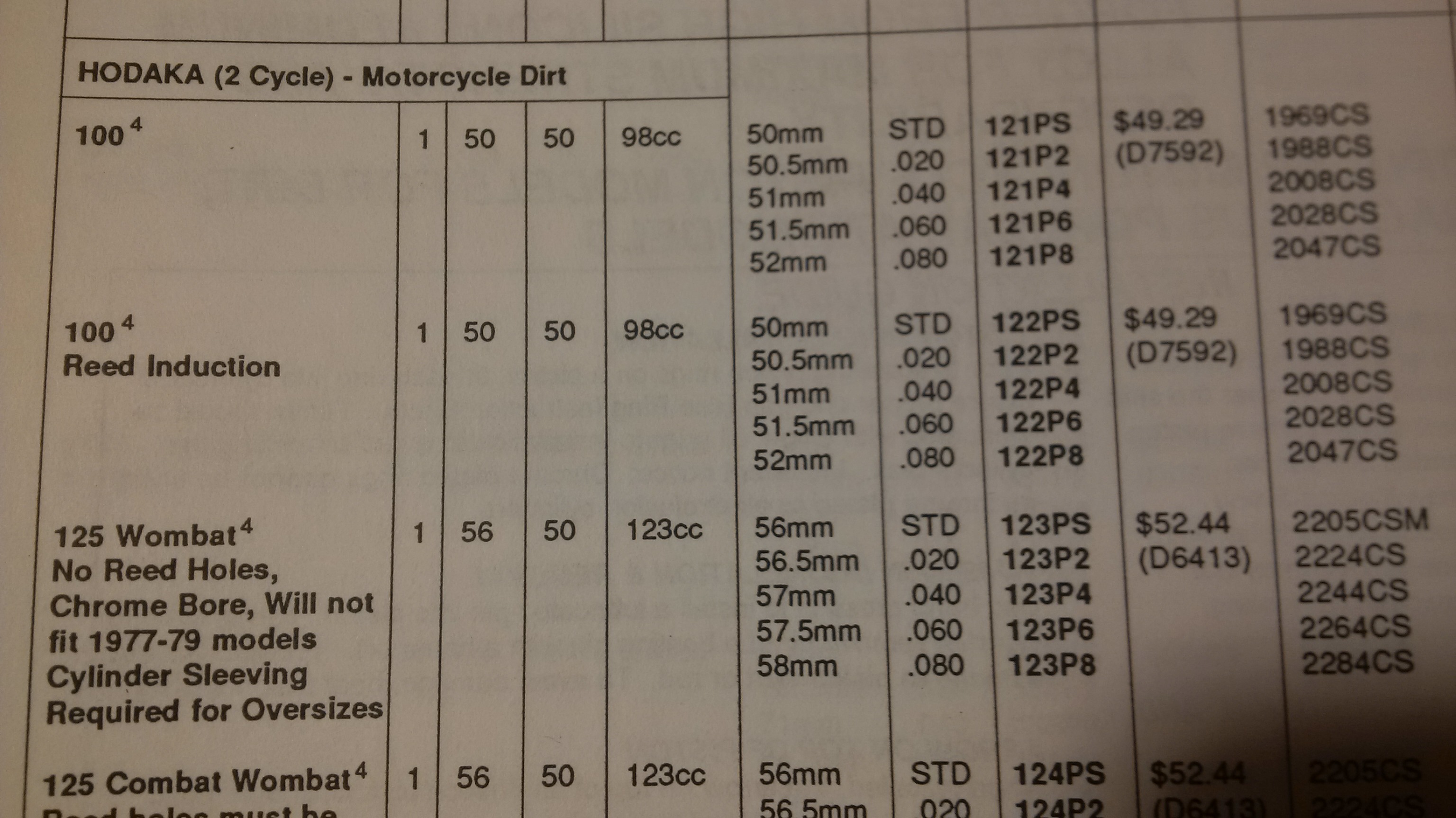

My parts listing.

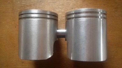

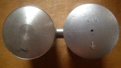

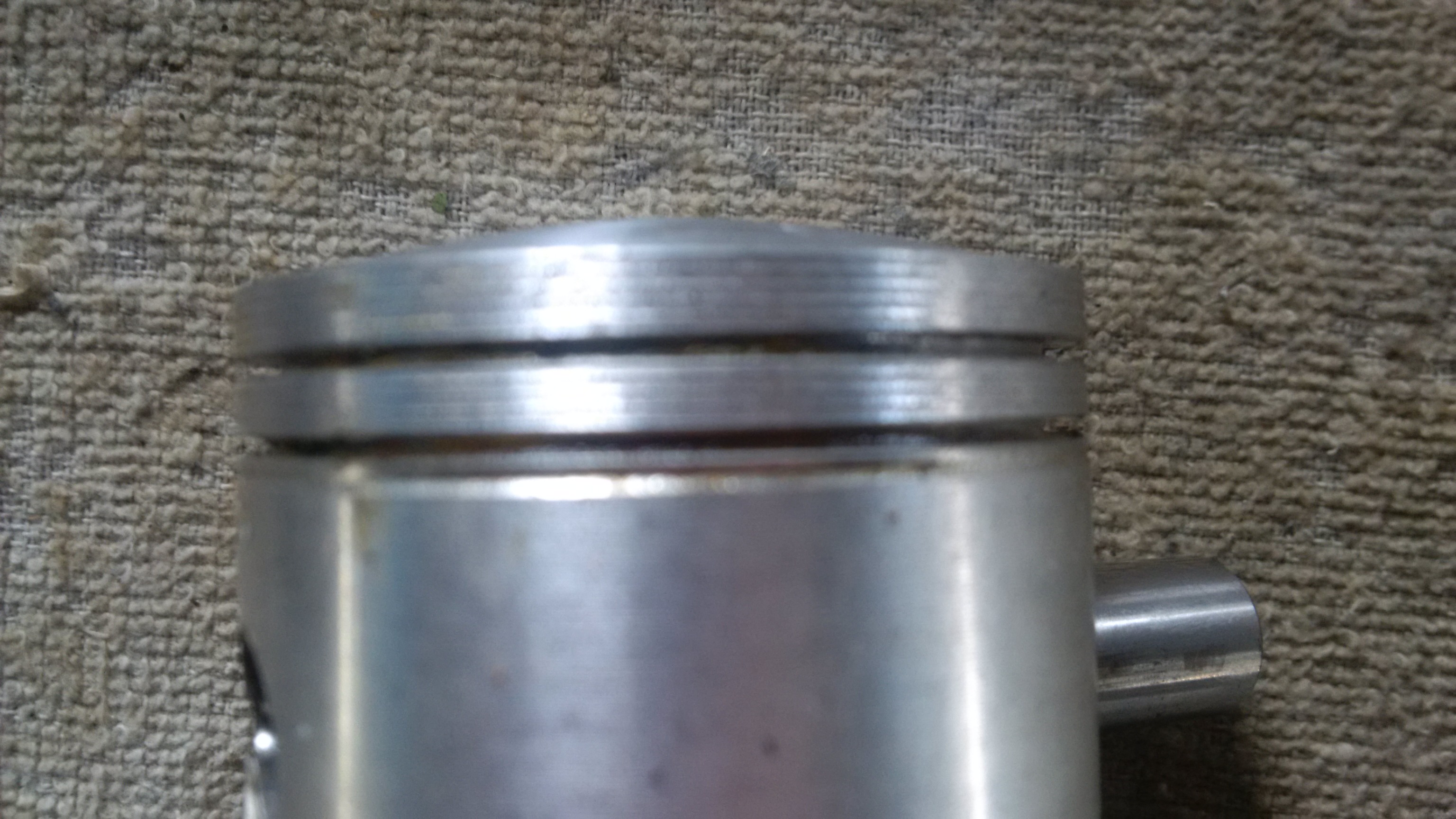

No markings except for the 50 and the arrow on top. 12 mm wrist pin, narrow slots for the rings.

That piston looks like a Mahle piston for a Sachs. Some of their pistons used a 12mm pin. I have some and they measure 1.645 inches long and are stamped N4 on the side with a triangle. The Hodaka pin is 42mm long or 1.653 inch long. The wiseco CS ring is .039 inch thick.The Wiseco LC ring #2 conventional style ring measures .062 inches thick. Measure that pin! I`m on a quest now and hope someone can ID this piston. That`s what this chat group should be about.

I bought a Wiseco oversize piston for another Ace motor I'm doing, I tested the rings off that piston in this piston and they were a good fit for thickness. ( not for diameter). If this was for a Sachs motor what cc would it be? 100 cc is 48 mm, 125 is 54 mm.

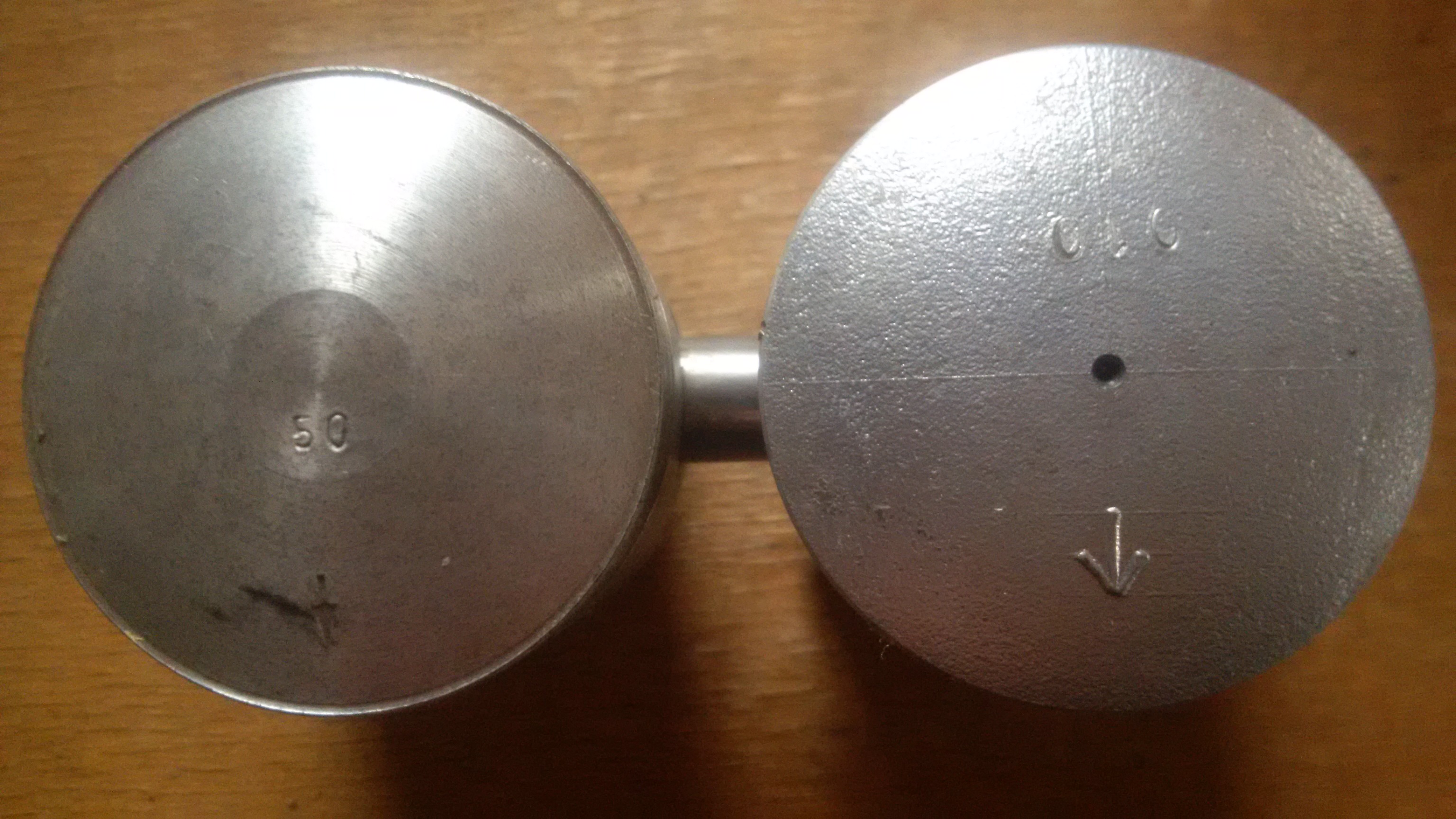

010 oversize ART piston compared to what I believe is the Wiseco piston. Pin is 12 mm x 42 mm. Distance from pin to top of the piston is the same. From pin to bottom of skirt is the same. Running in an Ace 100 iron cylinder. Skirt shapes are slightly different, the Wiseco being slightly narrower. Running standard Hodaka wrist pin bearing.

What I see about this piston that`s different are the locations of the anti-rotator pins. Spaced pretty close together. I have some Webco pistons that the rings stagger on each side of the exhaust ports. Nice for adding 1 large boost port for reed valve application. Yes, Webco USA pistons. I have a piston that I can`t ID. It`s identical to a Model 94 piston, takes model 94 rings but has a 16mm pin. Inside it has (Y56). Above it is a logo that looks like a crossbow. I need to post some photos. The problem trying to figure out parts of ALL kinds is that they made so many. I have a feeling we may be looking at a Snowmobile piston. All I know is that the self proclaimed experts like myself haven`t figured it out yet!!! Joe Ormonde
