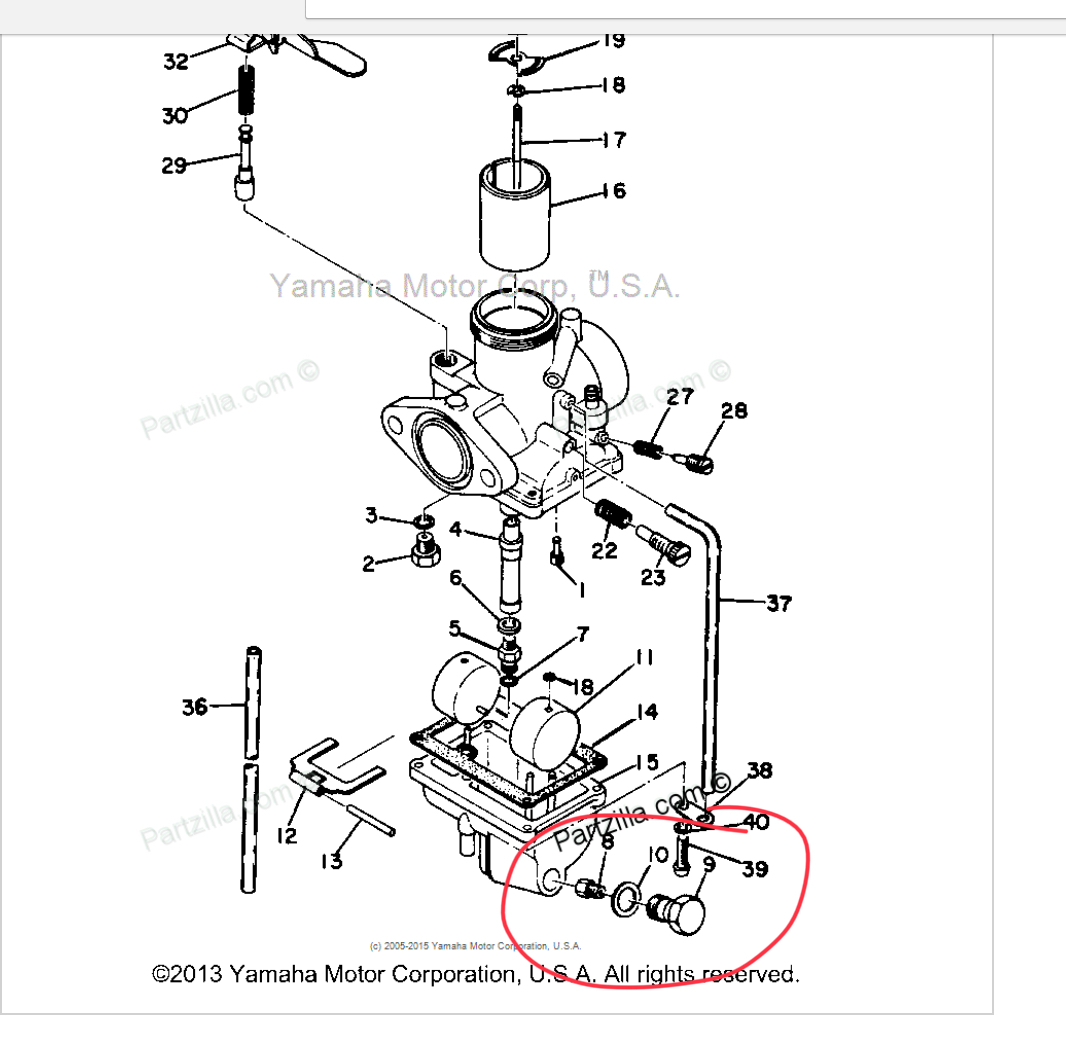

The side type carb (flange mount) has the main jet on the banjo bolt (#8), there is usually a critical “O” ring on the extension that is at the bottom of the needle jet. (Item #7)

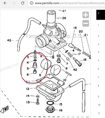

The bottom drain (spigot mount) has the main (#6) mounted on the bottom of the needle jet.
Given those photos, what is your question?
Note: the photos are Yamaha carbs, but the VM series Mikunis we’re pretty universal.
