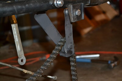

Steve Arnold
Posts: 20
Joined: Thu May 11, 2017 5:38 pm
Re: Hodaka super combat chain guide wanted
Post by Steve Arnold »
Mounted modified Super Combat chain guide on Wombat swing arm. Much easier to change guide than weld/modify swing arm.
