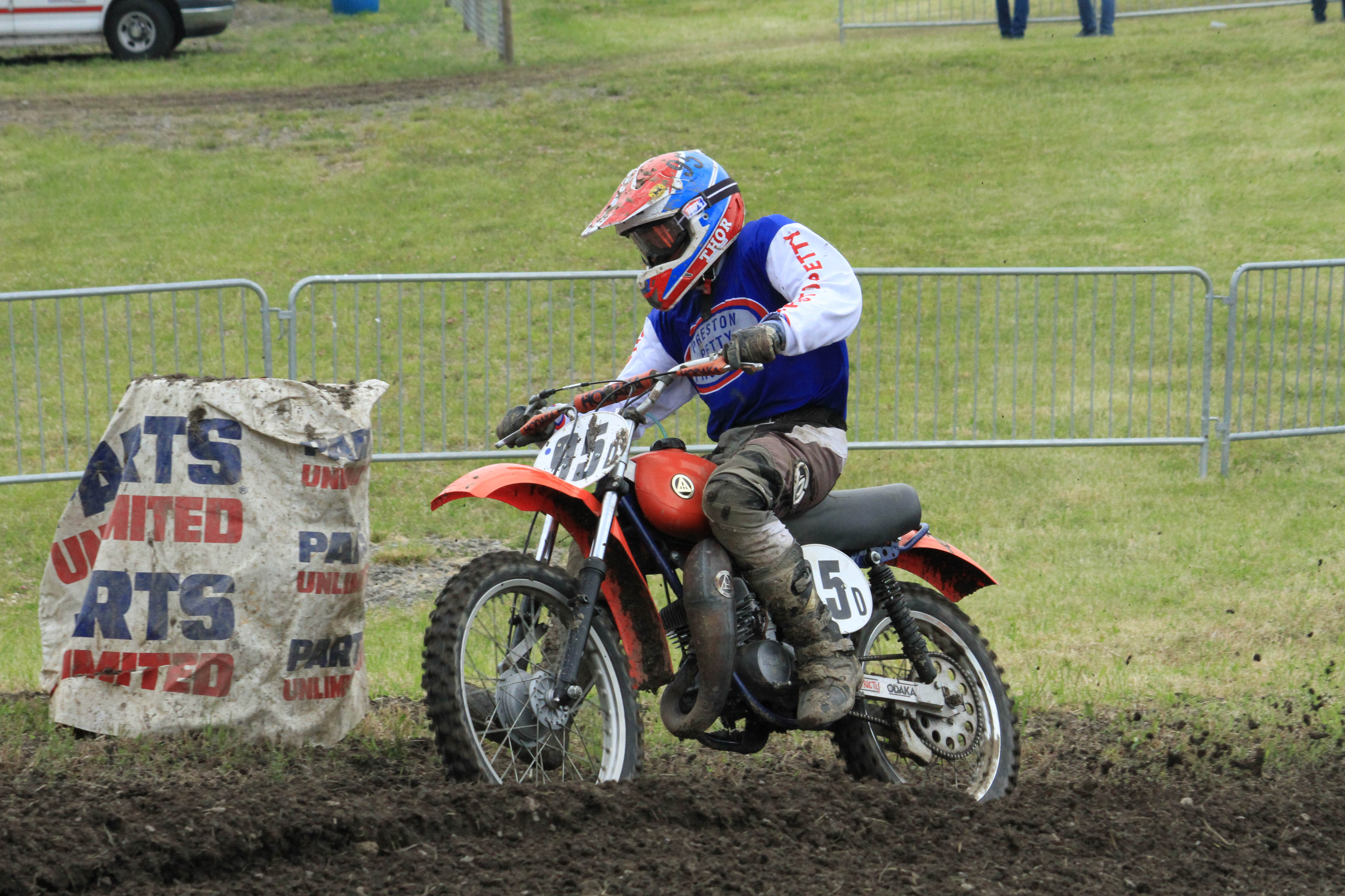

On the other end of the spectrum is Paul's highly modified Strictly Hodaka/Preston Petty "Works" Super Rat. It has the 34mm forks and they work great! Here is a picture of it getting the hole-shot in the 100 Expert Class at Unadilla. Great bike, and thank you Paul for allowing me to swing a leg over it!

Proud to have you ride that bike Ivan !! You sure look good on it :-) I like your jersey too...
