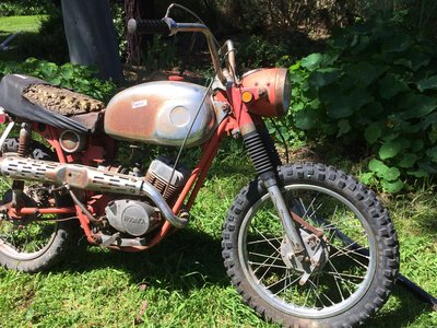

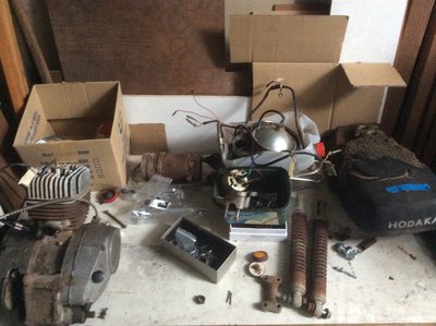

Hi All,
Just introducing myself and bike. I bought a 1968 Ace 100 recently at a swap meet. All complete and straight but definitely in need of work after sitting under a tree for many years. The frame is being painted at the moment (after matching the colour from inside the headlight shell) and I've zinc plated all nuts, bolts and brackets that I could find. Chrome work is also away being done. All that leaves me with at the moment is painting the engine cases, reboring the barrel, rebuild carby and rebuild the forks. I
I think the gearbox is ok as I've checked it using info from a few posts on this forum.
Parts are almost non existent in Australia although Hodaka's were sold here. I haven't seen one on the road since the 1970's.
thanks to the web and eBay I've got a lot of parts from the USA to get this little gem going.

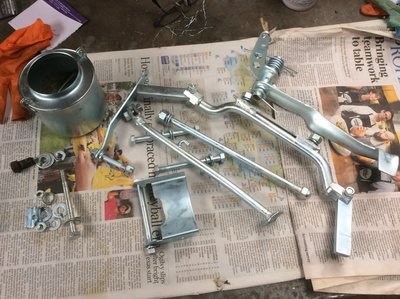

Nice looking zinc plating. Are you using a commercial kit to do your plating?
Re: New Hodaka in Oz
Bit of a mixture. A friend made up the power regulator box and I bought the plating bath and passivate chemicals from a local supplier. The activating acids were pool acids from a hardware shop. It works quite well.

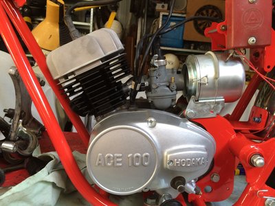

Hi,
I've just got my barrel back from being re bored to .040 oversize and was starting to fit the new rings. I see that one is shiny and the other a duller cast iron color. I measured them and they both seem to be the same size but the box they came in lists two different part numbers. Anyone know which on one goes at the top? My gut feeling is the chrome one is at the top but I'd like to know for sure.

Yes the chrome one goes on top. Nice looking plating
The short end of the brake pedal return spring should register to a corresponding hole in the engine mounting plate while the long end is retained by the short mushroom-shaped stud on the brake pedal fulcrum arm. Do you recall if the pedal was functional before you stripped the bike. I'm wondering if the spring is broken and I can't tell from your photo if the spring is intact.
Thanks Rich. It's all gone together very easily. Piston rings compressed with 50 mm PVC pipe slit down the side and a zip tie.

That motor looks DAMN NICE Bert!!! Amazing job!!! ; D Victor
