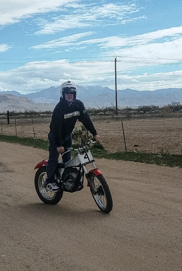

Kelly I spoke with Preston yesterday. I wanted to let everyone know what he said about your Trials skills.
He told me that he had recently seen you at a Trials event on your Hodaka. He said you were the only Hodaka there??
He also told me how well you did on your new trials bike. He was very pleased and very proud of you!! He told me that you rode like a pro.
Great job kiddo.......
- Posts: 927
Re: Trials bike

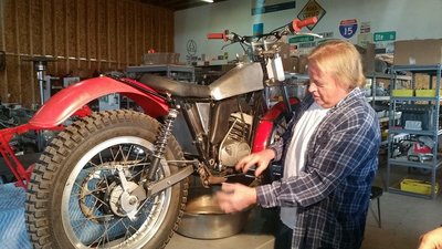

Wow, that's so cool to hear Paul. Preston is a special person and to hear that is so great. I was riding the beginner line, but it was the first real test of the bike. I will move up next time. I also had some good coaching from this guy who drove a long way to see me.
Danny Messmore and me. Also thanks again to Greg and Diane for all the help with the bike.Re: Trials bike

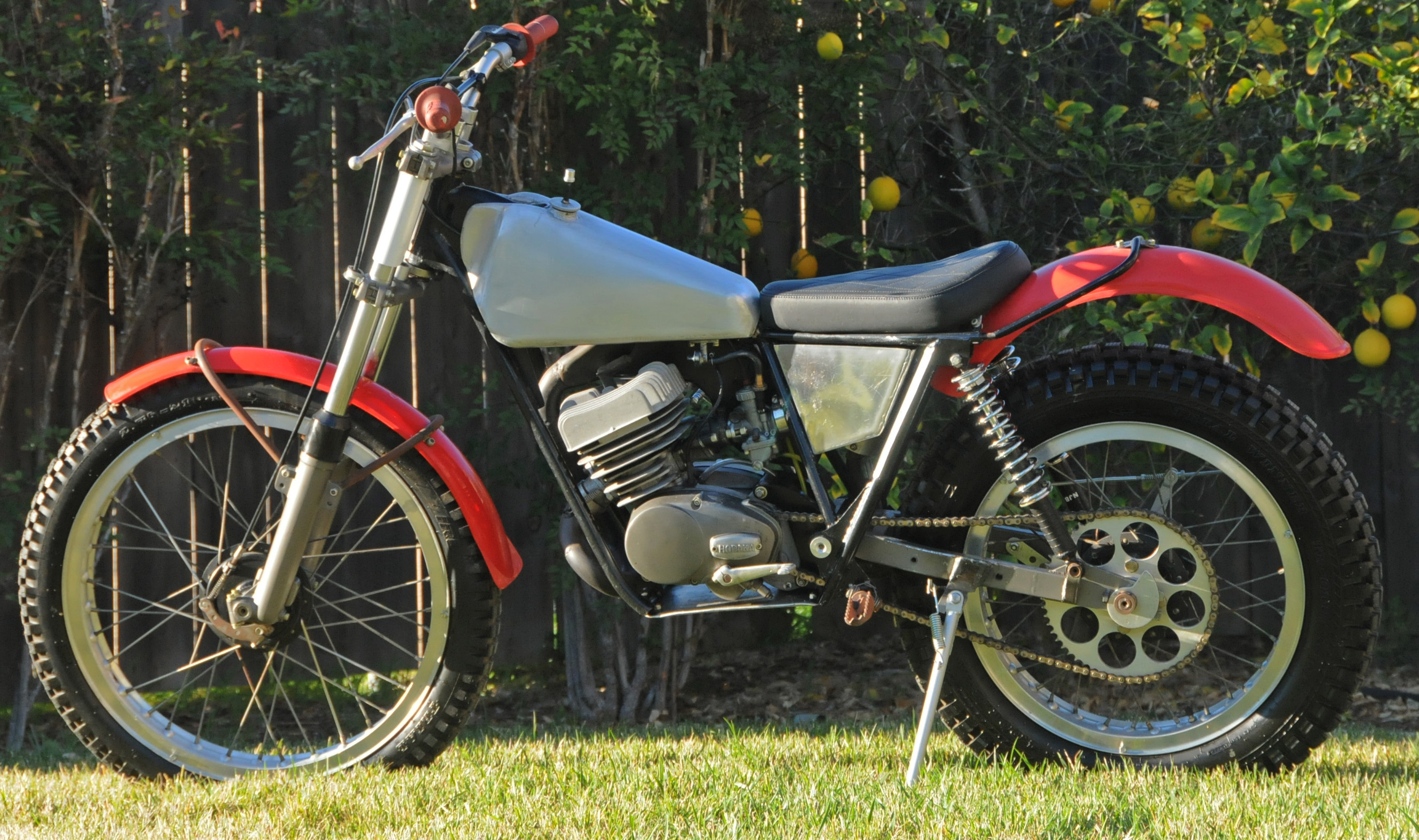

What did you use for a fuel tank - I like it!

The tank, pipe and airbax are all one off hand made by Hayden Campbell. I bought the bike in mid stream as Hayden decided to get out of the project.
You see the pipe side of the tank is higher for the pipe to fit.

Greetings kelly
I see that the bottom frame rails are removed. Do you notice any flex in the frame or does the bolted on skid plate compensate for the removed pieces? It's a neat idea that should give you a couple of extra inches of ground clearance and take off a few pounds. It's a win win solution!
Removing the cylinder fins is something I've not seen before. Is this for weight saving and not needed for trials riding with less load on the engine?
Excellent craftsmanship-----nicely thought out-----very clean and tidy.
I am beginning to get ideas for my next project.

Re: Trials bike
Flat side pipe is kind of interesting - is it flat on both sides or curved on the inside. Also kind of curious if you or the builder has compared low speed/torque performance with a stock pipe?

I first saw photos of this bike many years ago (before Kelly purchased it). I was mightily impressed . . . but hadn't noticed the asymmetric tank till it was mentioned in this thread. Again, I am impressed! A fine example of "form follows function" - I love it!
I even communicated with Hayden about the fin removals. He was certain that the relatively gentle power demands would not cause over-heating -- and added that he thought having the larger gaps between fins would help prevent mud clogging at a muddy event. At the time, I was considering converting my Bullfrog to piston port power . . . so I removed every other fin from an iron Wombat cylinder (which actually saved some real weight!). I have to admit that I'm a bit worried that the iron cylinder minus half its fins might get a bit warmish at a summer trial with 90-100 degree ambient temp. But . . . the cylinder is still sitting on the shelf awaiting it's turn to go out and play. Gotta get around to that someday. (Soooo many fun things to try, so little time!)

Very nice trials bike. I do have one concern though. Here in the Northeast, we have lots of rocks and high logs in our trials. I would be afraid that the pipe is very vulnerable to damage. Compare it to the pipe on my Spyder Ace 100.

Good point Rick. In trying to make the Day One project "Cool" I think I created a clearance problem. I'm thinking of a cool extended guard to protect the pipe. My old motorcycle group does have a saying "Better to be cool than to be practical"
(which I try to adhere to!)
