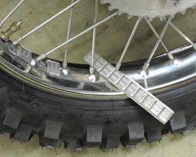

Tom, I'm with Thrownchain, If the wheel has smooth bearings and is free-wheeling just add weight on the other side until it balances. A friend of mine gave me these stick on weights that he found on E-bay that seem to work. I've also wrapped solder wire around the spokes with good results. With our relative low speeds this should be accurate enough. Hope this helps!
Stick-on wheel weights.
