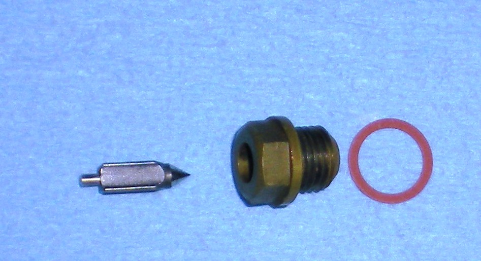

Here is a picture of it. The spring loaded pin is an intregal part of the float valve and the spring is not visable. Hope this helps.
When you have it apart, check the pointed end for a smooth surface. It should not have any worn grooves in any direction on that surface. Also check the mating surface down in the seat itself. The seats will often corrode over time and will not provide a good seal even when cleaned. Both surfaces must be in ideal shape to get the necessary seal.

If I remember correctly, the pin on mine was flat on the non pointy end. I might be wrong but I'll take it apart and ccheck it again. I know the pointy end had some areas of discoloration which could have wearing or buildup.

Hummm, if you find that yours does not have a pin sticking up then you have found the source of your leak. The picture is of a used valve from a 98 Super Rat just like yours...

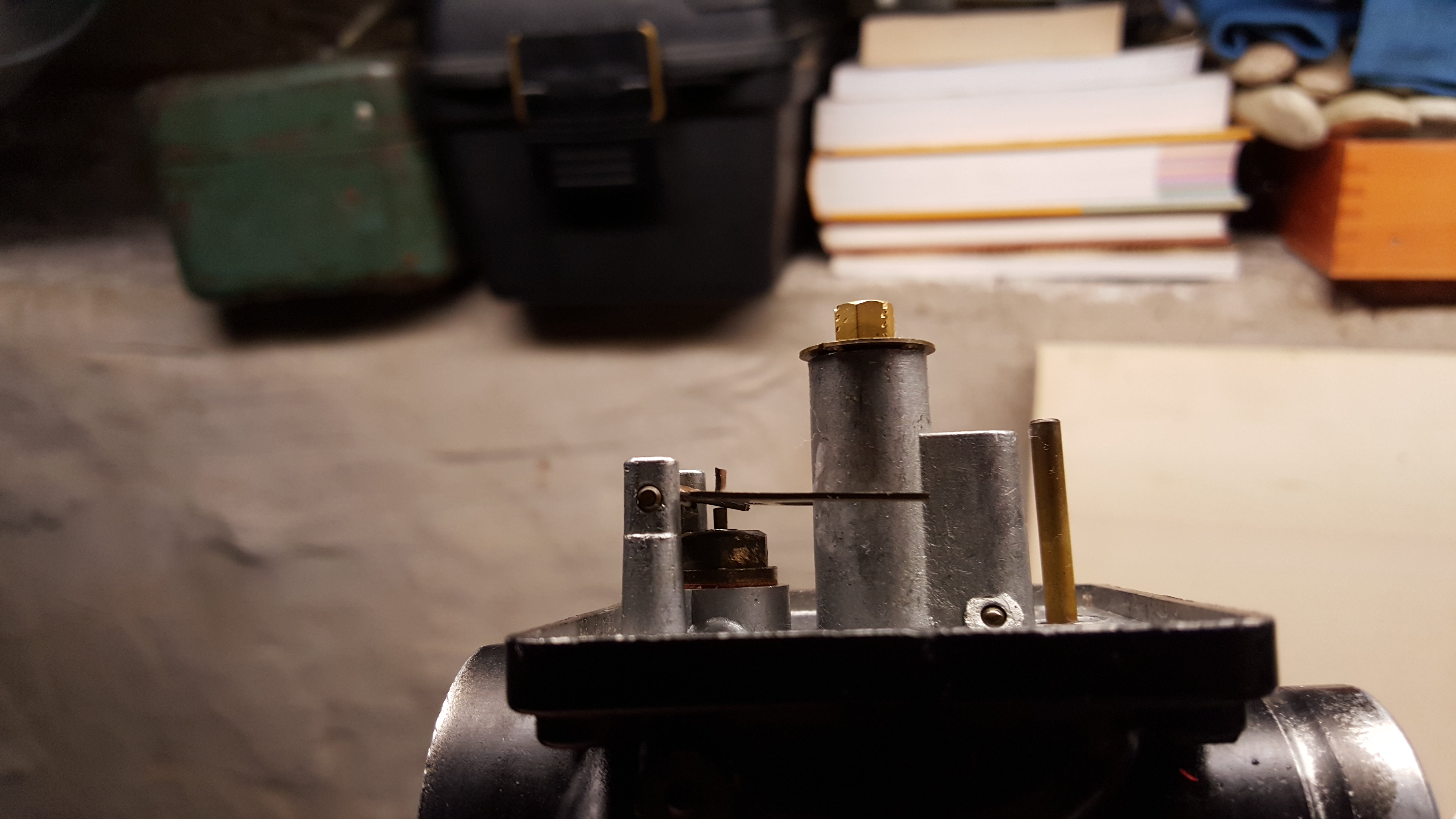

Ok, the float valve and pin look to be good. I was wrong about the spring. It's definitely there and seems to function. I did check the float arm's position and it seems to be about 1/8 to 1/4 higher then the surface of the carb where the bowl and carb meet. I'm assuming the "tang" is the center part of the arm that sits on the pin/spring? I did notice some sediment in carb, I had previously clean all out. I should probably get the proper filter, new float valve and pin also. Ah, good thing i have plenty of winter to make it right!

After seeing your picture, yes it is quite a ways out of adjustment. This would allow too high of a fuel level. Remember that you have the carb upside down for this view. When it is all assembled and installed the floats would have further to rise to actuate the float valve and shut off the fuel thereby making the fuel level too high.

Here is my new float valve setting. Does this loak like the correct calibration?

Ok, Good! I'll get it all back together tomorrow and see if I have different results. I'll let you know how it turned out. Thanks again for taking the time to explain things and being patient with me!

Shaun:
For a self proclaimed "non motorhead" . . . you are doing just fine! Nice job on adjusting the float level.
