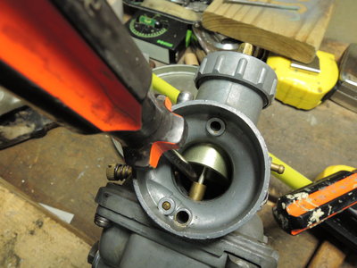

The best way to tell is to look into the throat of the carb and observe the needle jet (nozzle). The Type A carb does not extend into the venturi of the carb while the Type B carb has the nozzle splash protruding up into the venturi.

Yes I have verified that I have the bad carb. The pictures somewhere on this forum show the difference quite well. The frame number on my bike is c00195 and that's pretty early so it makes sense that I've got the bad one. The thing that's curious to me though is that the bike as near as I can tell is all original and the odometer has 1200 miles on it. So I would infer that it ran with that carb for that many miles.

As Dale and Ed said the "B" model has the needle collar protruding into the venturi as shown.
