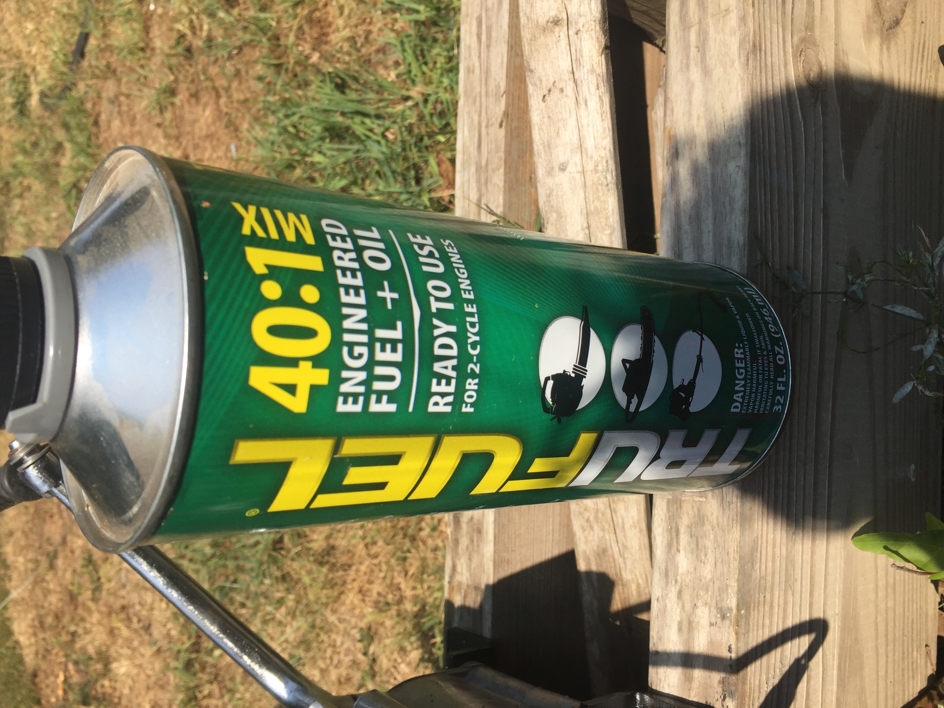

May we assume the premix is fresh? What are you using and at what ratio? Has a spark plug come out of the head wet with fuel after trying th start (not from putting gas straight into the spark hole, but letting it draw from the carb). When you say it has great compression, what is the compression?

I think the 40:1 mc may be a bit weak but it should still start with that mix. I mix 32/1 for my 125. If you set the points to start opening at the left mark you may have the timing advanced too far. I would set it to open about 1/3 the way to the right of the left mark and try it again.

Frankly, Autozone does not sell two stroke motorcycle oil, unless you are getting Lucas, which is expensive, and even then I wouldn't do it. The oil you showed is for chain saws and string trimmers, and 40 to one is correct for such devices, but not for your bike. Get real motorcycle two stroke oil from a bike shop, mix 32:1, and move to the next step. However, that is. It what is stopping your bike from running. It will run on straight gasoline, it just won't run for as long as you want it to. What you have is more or less safe to use, but not optimal at all.

The premixed fuel could be fine. 40:1 is a bit light for air cooled motorcycles IMHO. Without knowing what kind of oil is mixed with the fuel, it's hard to say if it's worth using. I have seen premixed fuel at the local Honda dealer, and the cost per gallon makes me think we are living in Greece. Some use it because it is consistent and because the stated octane rating is higher than pump gas, but unless you are in the top three internationally on some circuit, I don't think the fuel is cost efficient. Just sayin'. It should run on it.
