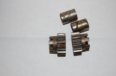

Is this the part you are looking for? They have a little surface rust but no cracks or broken teeth.
Re: Model 97/98 Clutch pinion gear
They appear to be for the 93 Super Rat just by looking at the lugs. I just measured the inside diameter at .745 inches for the 93.
Thanks,
They were in a box of parts I got that were labeled Super Combat.
Pinion gear for 97/98 is 21 T spur. Pinion gear for 93 is 17T spur.
Gilligan,
Regarding the pinions shown, what is the tooth count?
These both have 17 teeth.
There you go. Not 97/98. Lots of folks take bikes apart not knowing what they are, and think all Hodakas had the same name. A guy at the local Honda shop last week swore that he used to have a 1965 Super Scat, chrome tank, red frame and all. You can't argue with other people's reality.
Charlie is right. Only the 93 series had 17T spur cut pinion gear. Max, your eyes are better than mine if you could spot the application from a side view photo. Correct call.
