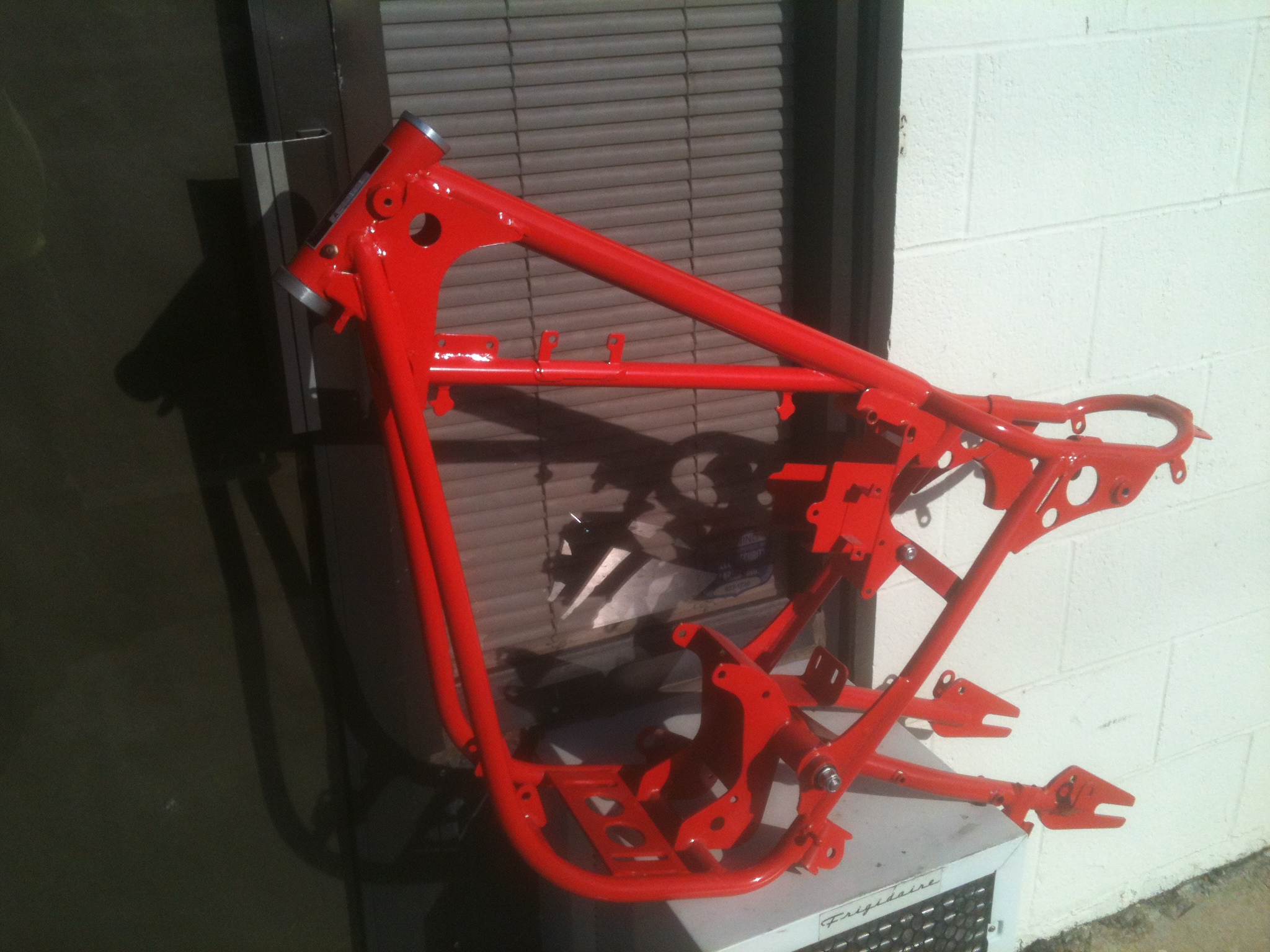

As I mentioned in an earlier post, I think I've got a near perfect color match on my Model 93 Rat. The photo shows it more red than it really is. It's actually got just a hint of orange in it. I used the space under the VIN tag to color match. When I first painted it, my wife asked me why I chose Orange. But it turned more red with a hint of orange after the clearcoat and curing time.

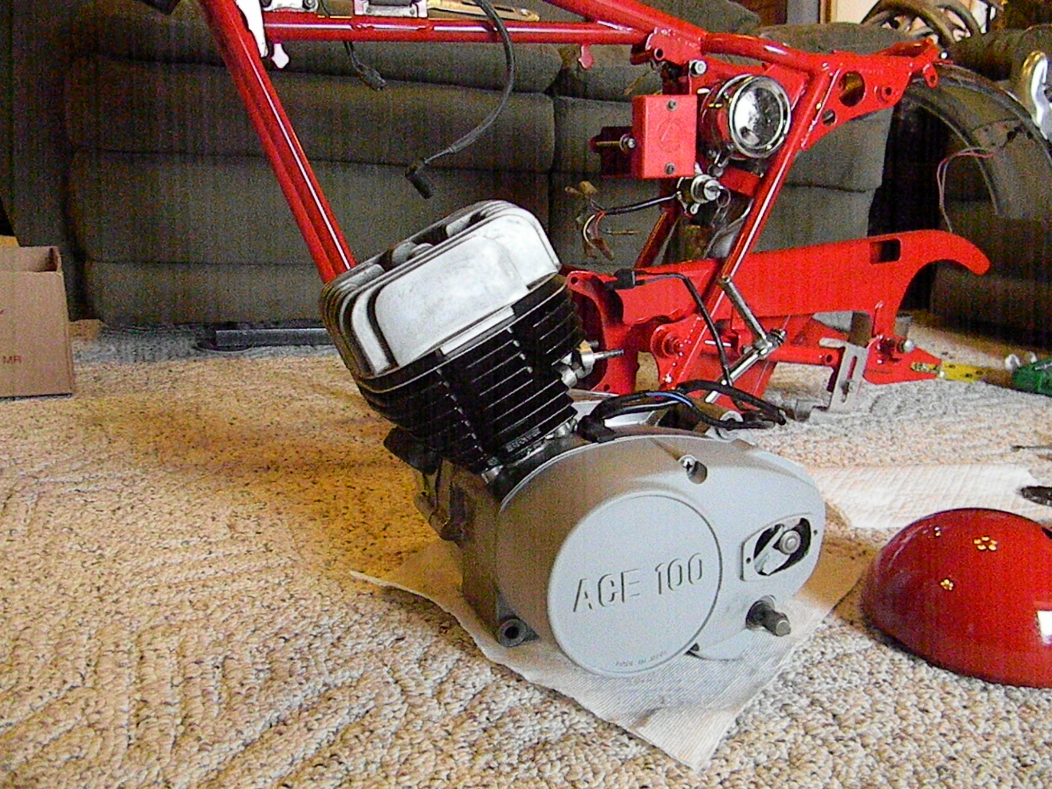

my color see the couch and rug me wife says no no. ----Clarence

Clarence, Bike looking good. I had both my Hodakas powdercoated and they turned out great. I believe they will last longer than painting them.
They were sand blasted first with I think makes a big difference. Plus we have a great company right here in Kalispell MT that does alot of bike stuff because he is a gear head and loves doing bikes.

While it's not a Super Rat, I used this same powdercoat finish on my Super Rats. RAL 3020 is the code.
