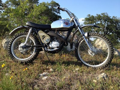

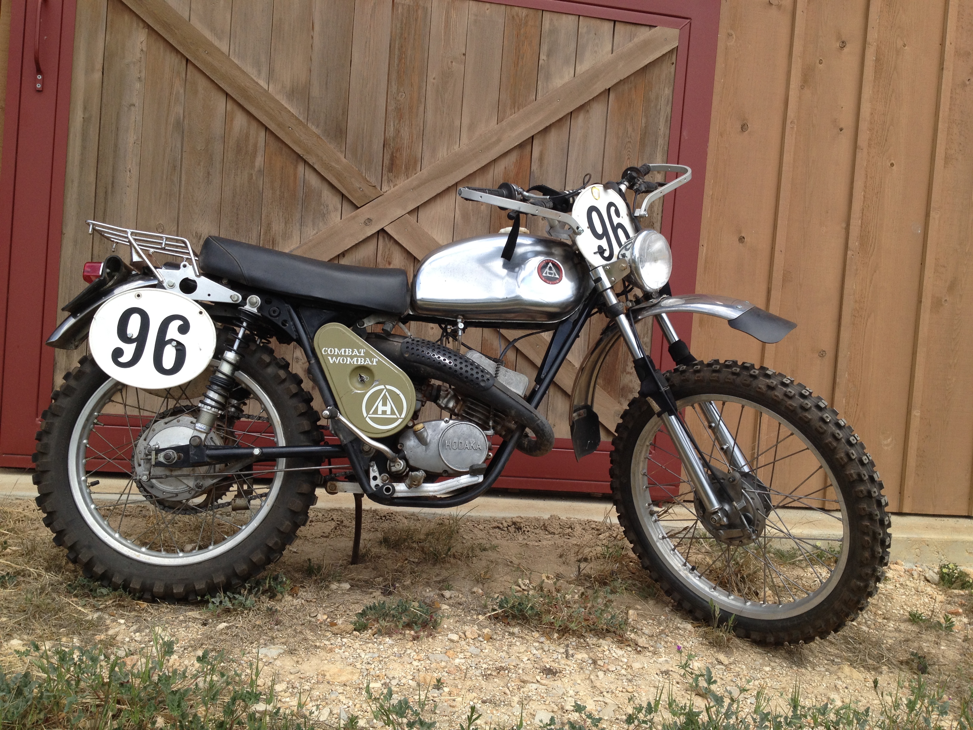

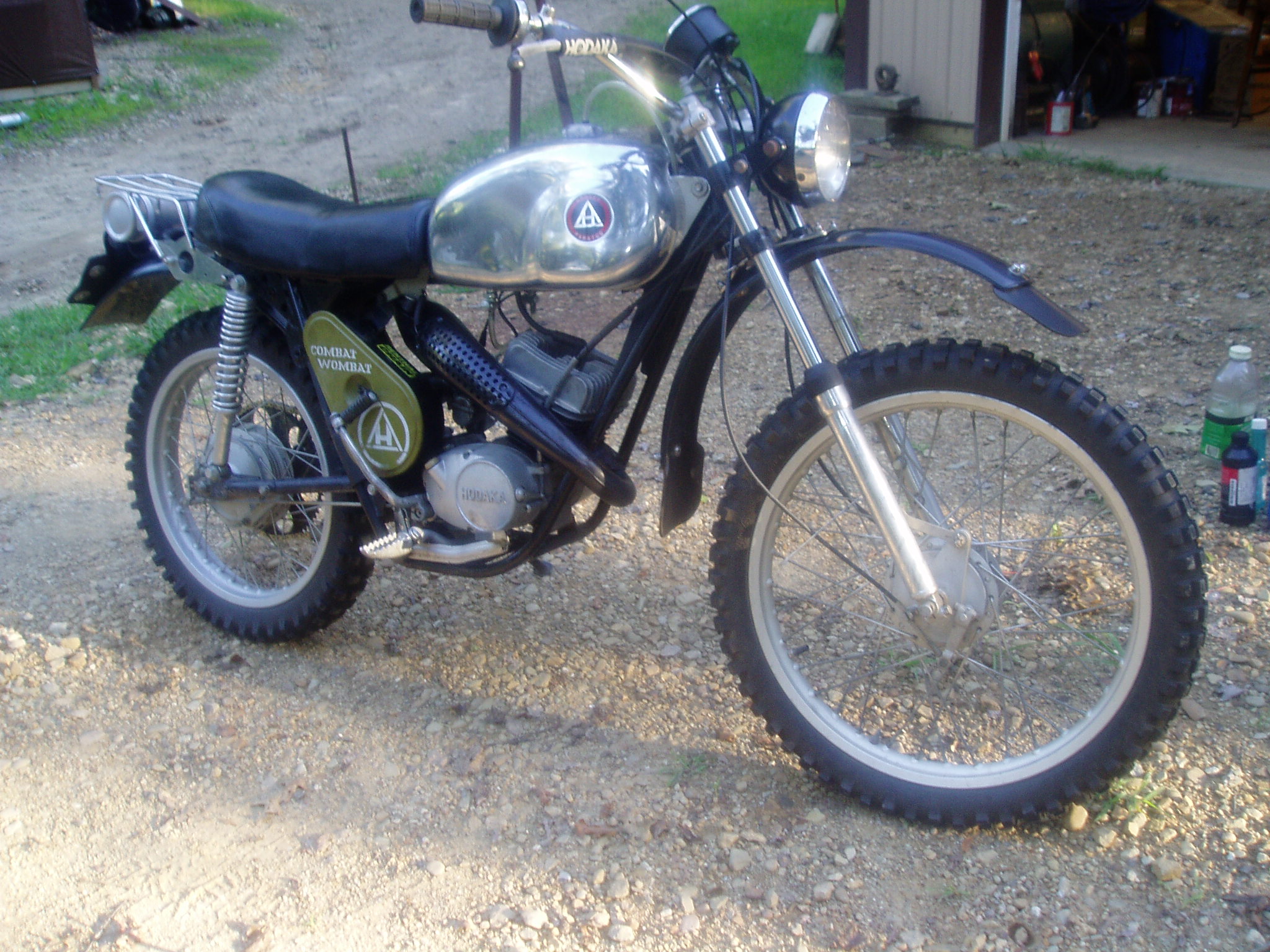

Here are some photos that might help. Progression of the same bike over a couple of years
Stock (except for reed set up) Race equipped (03 front end, plastic, borrowed air cover) And the trail bike it is today. Lights, Wombat tank (bigger capacity), rack, kept the hub but went back to 30mm forks, and hand guards Any direction you go, you'll love it - CW's are great!
-Laurie
