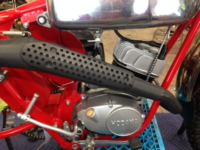

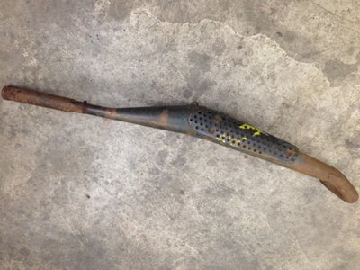

Picked up a pipe on EBay, it arrived yesterday. It is solid no holes or dents. It should clean up nice. Got the frame painted, New tires mounted and busy cleaning and painting small parts. I should have a roller in a couple days.

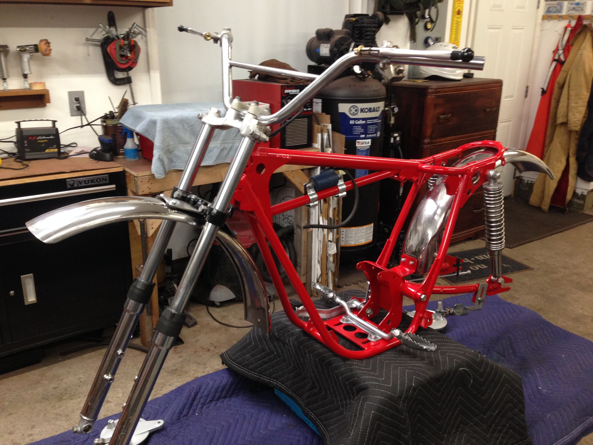

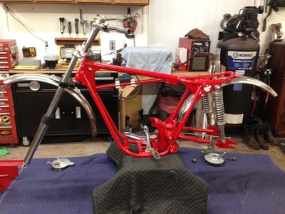

Well I expected to have a roller now. I would have but I wasn’t happy with the tires I picked, they were just too big and didn’t look right.
This is where I’m at tonight. Since Rat fenders seem to be nonexistent I used a 94 Wombat rear fender. Cut about 6” off the back, about 1” above the tail light mounts. Drilled new mounting holes. The Wombat mounting holes will end up being the rear number bracket mounts. This fender was damaged on the end anyway so I didn’t mind hacking on it.
Ordered $770 of stuff from Hodaka Parts.com yesterday which should be most everything I need to finish this project except the elusive air boot, still searching and trying to come up with an alternative.

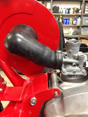

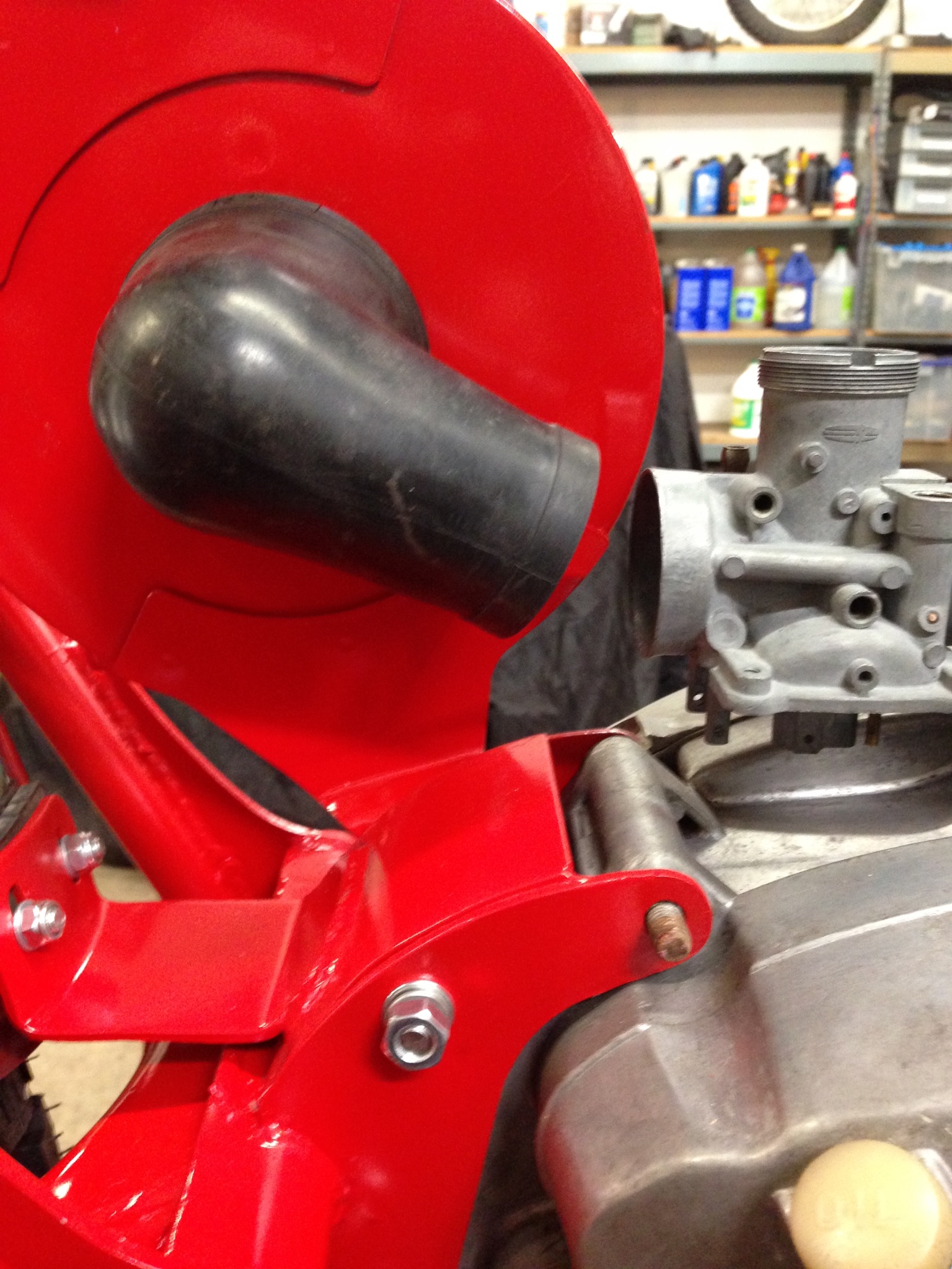

Air boot solved temporarily anyway. I had and extra Wombat 94 boot and another unidentifed boot. Cut the end from the unknown boot, which is the correct size for the carburetor. Heated it up and stretched it over the Wombat boot. It is a very tight fit and will not leak. This should get me by until the correct boot becomes available.
Re: Picked this up today
Nice job modifying them. Looks custom made too! :ugeek: Victor

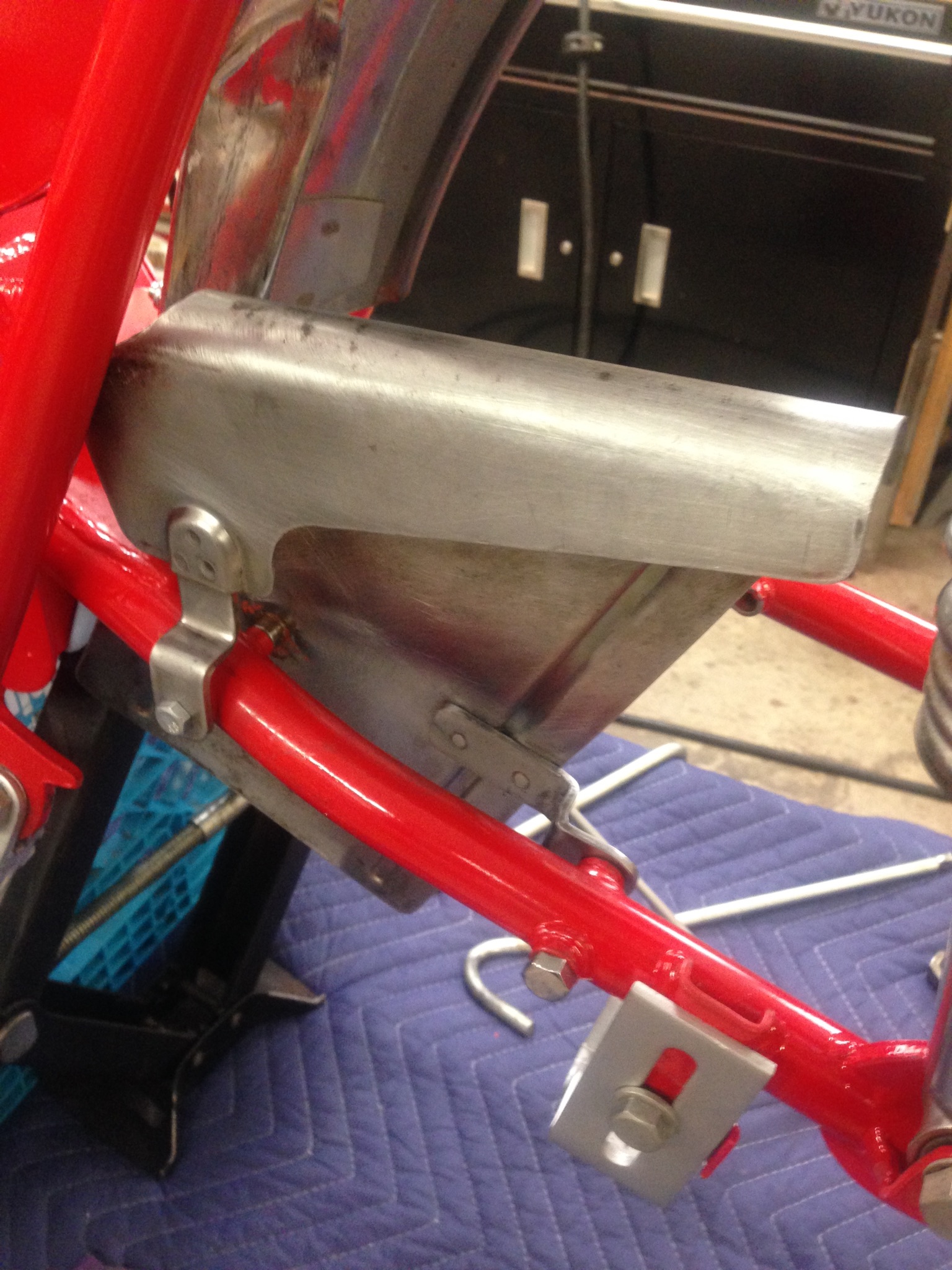

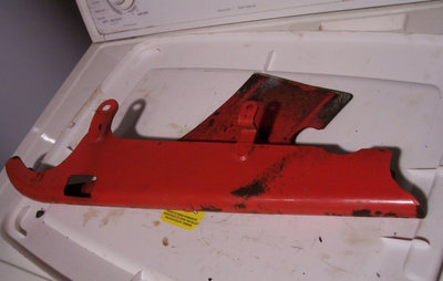

Thrownchain suggested using an Ace chain guard to make one for the Rat since no Rat guards are available. Took his advice. Just a little more sanding and it’s ready for paint.
Before and after:
