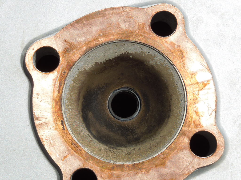

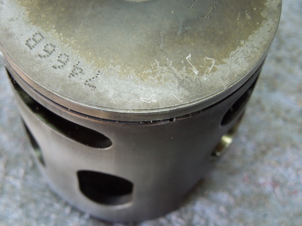

Ok, I have a little time now and after reading your comments I am ready to offer up my thoughts. I have the advantage of being able to examine the piston and sometimes pictures are not quite the same. I did take the photos in a manner to disclose what I noted.
1. Ring end gap is on the opposite side of the piston and all is well there.
2. The ceramic coating on the piston and combustion chamber, only in the squish band area, is gone. What looks like a burn pattern in the initial pictures is actually reflecting the missing coating. The ceramic coating on the rest of the combustion chamber and piston crown is in excellent condition. The surface where the coating is missing is kind of rough. Some roughness under the coating is expected as it is part of the prep process for the coating. Texture is rougher than expected though.
3. There was an oil film remaining on the piston, pin and bearing.
4. Under side of piston crown is a nice tan color.
5. Piston ring is stuck due to displaced metal and engine operation ceased.
Taking into account the spark plug, combustion chamber and piston, looks like detonation to me also. Many times detonation is so severe and the resulting damage so great it is difficult to tell what happened. In this case the piston ring stuck and prevented further engine operation allowing a cause to be determined. I would expect detonation to begin in the area of the squish band and that would explain the excellent condition of the remaining ceramic coating.....detonation exceeded the ability of the coating in the squish band area of the piston and combustion chamber. If you can say there are degrees of detonation, it looks like we were just a little past the point of safe operation and maximum performance. The under side of the piston crown is very telling and does not show evidence of excess heat beyond the ability of the piston material. Lack of heat damage on top of the piston crown is telling also......although if detonation evidence did not exist I would chalk it up to excess heat in the exhaust port area due to lean mixture.
What to do.
1. A richer fuel mixture should reduced combustion temperature and may prevent failure.
2. Retarding ignition timing should also reduce combustion temperature and may prevent failure.
3. Using a higher octane fuel which better resistance to detonation.
4. Reduce compression.
In this case richening the fuel mixture and / or retarding the timing may prevent detonation but would reduce performance. Both timing and fuel mixture appear to be in the desired operating ranges. Also, richening the mixture in this case may lead to an over rich condition and plug fouling. When racing, operating at top performance with out failure is desired. Considering the evidence we were not far off that mark. Seems to me the best thing to do is reduce compression or use a better grade of fuel.
At this point the cylinder is at Power Seal to true the bore and Nicasil coating. Going back to the same .040 bore we had when this engine was built. When initially assemble I used a copper .010 head gasket. I have the option of using the standard .020 head gasket....depends on cranking compression readings. I do not remember what the cranking compression was before failure. I also have a single petal reed to install instead of the two piece. If time allows I also have a 30mm round slide new production carb to test.
With out having the piston available the prior speculation was just that......needed the other piece of the puzzle. I hope no ones feeling were hurt and we can disagree. Like Max, I try to inject some humor and hope that was understood.

Compression / fuel is the first area of correction. Will did not want a loss of performance so racing gas is ok if we have to go that route. A lot will depend on what is discovered with cranking compression. Based on the evidence I think the thicker head gasket would have taken care of most of the detonation concern along with a little better fuel. We want as much engine performance as possible with out going over the edge. I do not think we were that far over the line. The .010 thinner head gasket is supposed to be good for approximately 10 psi extra cranking compression.

Even though the pictures of the piston damage look bad the damage is not as severe as it seems. The degree of damage to me would indicate we were just past the point of safe operation for the conditions. The engine jetting was initially adjusted when the air temp was in the 70's. The day of this race the air temps were in the 40's and that may have been enough difference to push it over the edge of safe operation. I would like to attend all the races with Will but that is not possible. So I will just have to school him a bit.

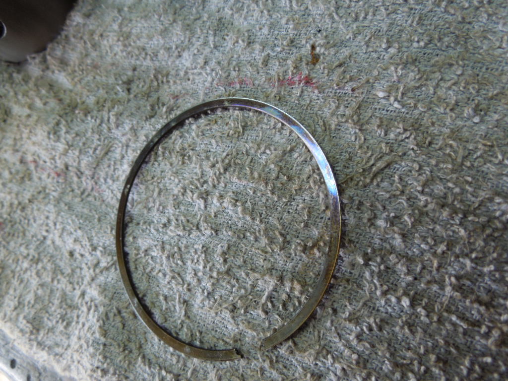

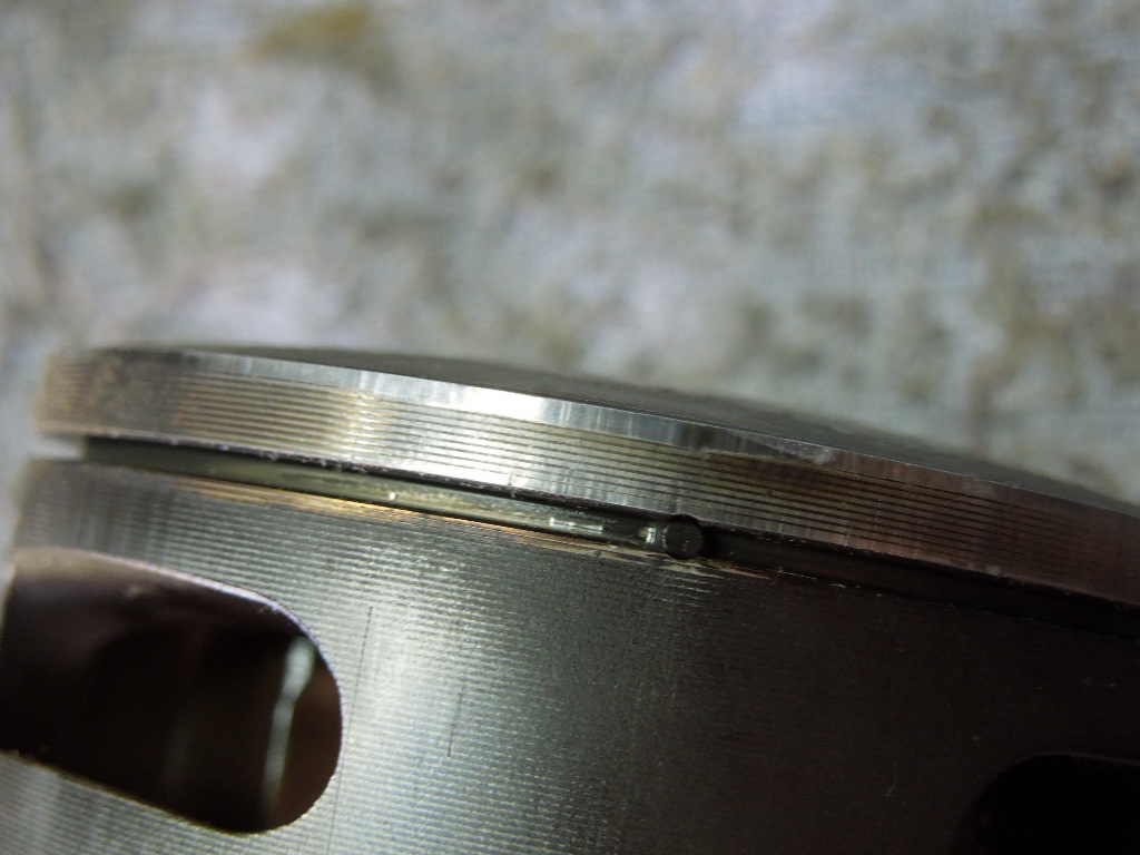

Ok, today I have definitely discovered the root cause of failure. The evidence was staring me in the face but I just did not see it. I will begin by asking some questions.
1. Why did the spark plug appear normal with this type failure?
2. Why was the scuffing on the piston exhaust skirt off set to the left of the exhaust port rather than more centered?
3. Why no evidence of excess heat on the underside of the piston crown?
4. Why was the ceramic coating missing on the intake area of piston crown and combustion chamber. Seems it should have been etched away in the hottest part which should be the exhaust side?
I wanted to remove the piston ring and see what it might tell me. Using a 5 power loupe I noticed this. The edge of the piston crown is hitting the edge of the combustion chamber on the intake side opposite the scoring on the exhaust side of the piston. The impact area is very small about .010 to .015 inch across the top of the crown and about .003 to .005 deep. I would suspect the piston and head did not make contact at modest rpms. However as engine speed increased and the rod stretched contact occurred. Metal displaced from the piston crown and cylinder head contact forced the opposite side of the piston hard against the cylinder wall exceeding the ability of the oil film to prevent metal to metal contact. From that point it was all down hill from there. I could draw a lot more conclusions but I think that will do for now. Correcting this condition is first priority.
Danny

WOW! Appears non of our ideas were accurate. Anyway it was a good discussion and we can all add another reason for seizures to our list.
Danny's sharp eye came through again.
Re: Tired Combat Wombat
Like I said, 90% of all piston seizures are caused by being too lean. Maybe this falls in the 10% bracket. We did not have this information in the beginning and I always go with the odds. Look at it this way, there's only a 10% chance we're wrong!
More evidence, Different odds. I don't think anyone was wrong on this discussion and I'm sure everybody including me learned something or they weren't listening.
Good discussion!
PS--There's still a good chance that this damage didn't cause the seizure but this certainly could start the process. Let's not jump to conclusions. A good detective would notice that the seizure didn't seem too start at that point. Like I said before, Air disasters are always caused by more than one event. That event could be adding more heat, we need to remember that as Bill said, "for the conditions", The story is probably not over. Odds are changing, I give it 50-50.
