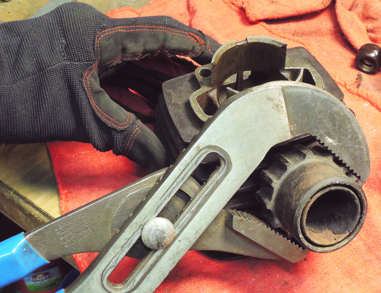

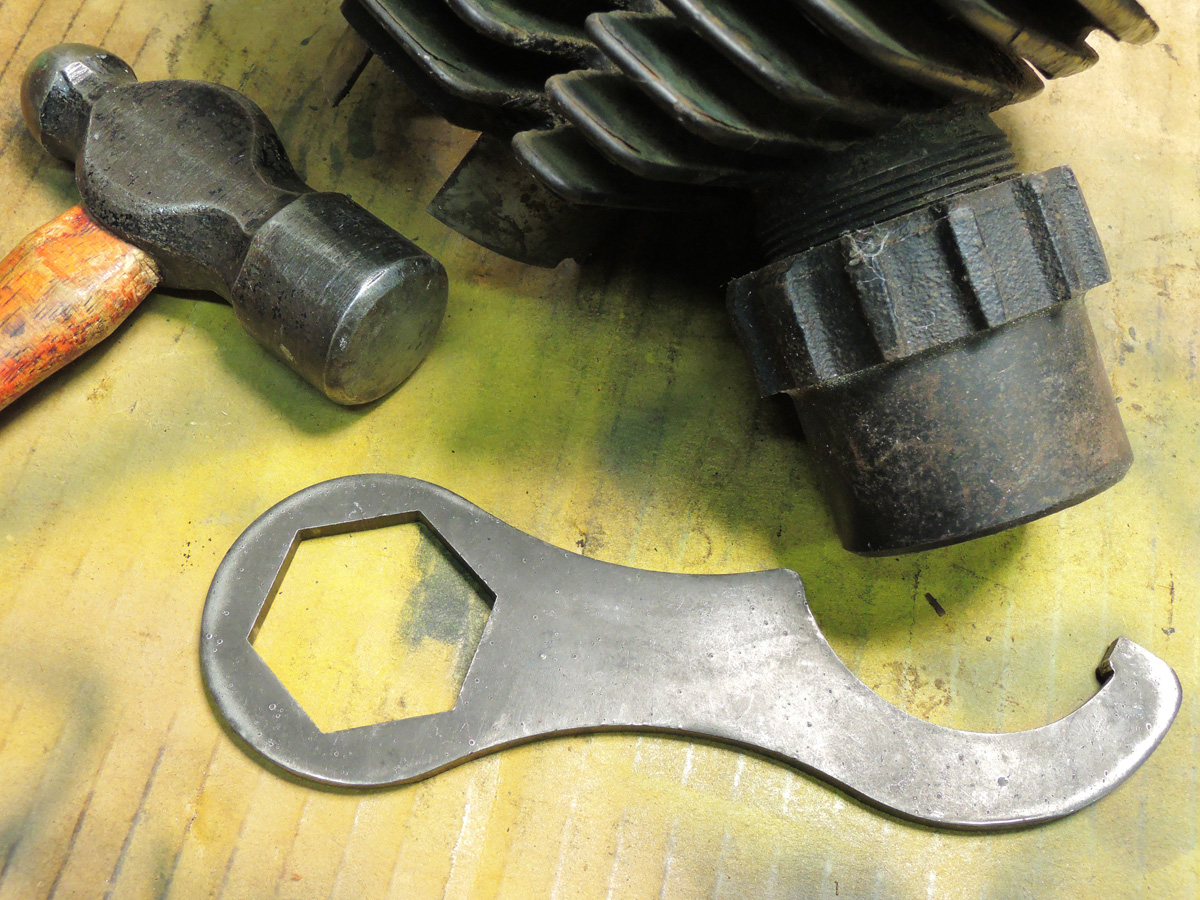

Not a stupid question, they can be contrary---Try this. If you don't have the tools pictured (which require a hammer), you can loosen the nut with a driver of sorts as shown. Heat, penetrating oil, all help. Sometimes you can break it loose with GIANT water pump pliers. All kind of crude, but it works. Hope this helps. (Secure that cylinder before you beat on it and wear eye protection in case something shatters--these are just demo photos!)

After re-evaluating my methods and after finally locating my GIANT water pump pliers (17 inches long), I decided to finish this photo sequence and immediately noticed that the pliers contact 4 studs vs only 1 stud on the other 2 methods. I think this is the way to go!
