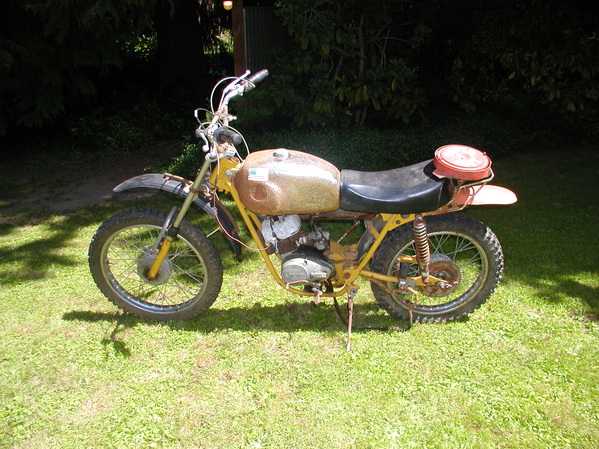

Thought I would add one . 68 ace 100. Has a extra steering neck welded on, early fork conversion kit . Super Rat engine F-1296 w/ reed valve. This pic was taken right after I picked it up. Filed the points, fresh gas It fired right up. K.C.

kc57 wrote:Has a extra steering neck welded on, early fork conversion kit .
YIKES! :o

I am particularly impressed by what appears to be a high mount air cleaner on the sport rack. ;)

These Mods from the Past ( Deep water AC and fork head extensions) I've not seen before--I think we're breaking new ground here!

Now that we've had big fun with your new find KC, can we see the other side? (more pixs)-- Seriously--I'm always amazed at the number of mods that were made to early Hodakas--Probably no motorcycle in history had as many after-market parts available (Think Webco, Bassani etc.) over a period of years, plus all the factory parts such as R pistons, HC heads and straight cut gears before the 93 Super Rat. Not only that, it's still happening today with Paul's SH! Ignitions, Pipes, R pistons and parts are still flowing over 50 years later-- Amazing history! and of course-- Great motorcycle!

I will try to get a couple more pics. Granted the bike is not much to look at currently. But I think about someone in 68 buying a new Ace and completely changing it to make themselves a racer. The steering neck extension is not that unusual , at least in the NW. I have seen several examples over the years ( Clarence has one of the nicest I have seen )
Re: MODS FROM THE PAST
Seriously KC, I've never seen that modification in all my years and types of racing. Tell us more about the supposed advantages of this mod (besides lengthening the wheelbase) if you can. Clarence--any input on this? Just curious--I thought I'd tried everything!
Friends I will try and explain this. It was always told to us that a longer swing arm made the machine handle better, no crow hop. This modification came about more by accident than the science of the engineer and his slide rule. The hopped up 90 could not be ridden considering the weight and short wheel base, you could not go through the gears without being upside dawn. So the rear swing arm was extended. To gain more length we wielded another piece of pipe to the front remounting the front forks out ahead, this seemed to make the machine more balanced and stable, it also let you turn a little sharper and kept the handle bars out of the gas tank. I only rode the old ace 90 it was my only race bike. this is a list of some of the mods. Stock forks modified to give a inch or two more travel. High bars with the brace, BN expansion chamber, compression brake, Webco Al skid plate, larger front wheel, Webco rear sprocket with cush hub, girling rear shocks, hodaka fork brace, hand ported cylinder and later reeded. shaved head and later hodaka racing head not super rat. 32mm plus or minus amal carb and when it wore out I used about a 28mm mikuni . Many other mods I could mention later. The 90 won about 70 races cross country and motocross. There was one Idaho off road bike hill climb being the only 90 I was the last to go and the first to make the top I made the hill all three runs for the first place trophy. Sorry Maico, Bultaco Greeves Yamaha, Honda Montesa and others.. The list above is about half of the modifications. There were two races I did not finish and one of them every one else quit first then so did I. And I did not finish Badrock about 1973?? I gave up racing in about 72. I never was on a track again until last summer at Hodaka Days. Sorry I got a little winded--------------Clarence ---A Hodaka dealer at 22
